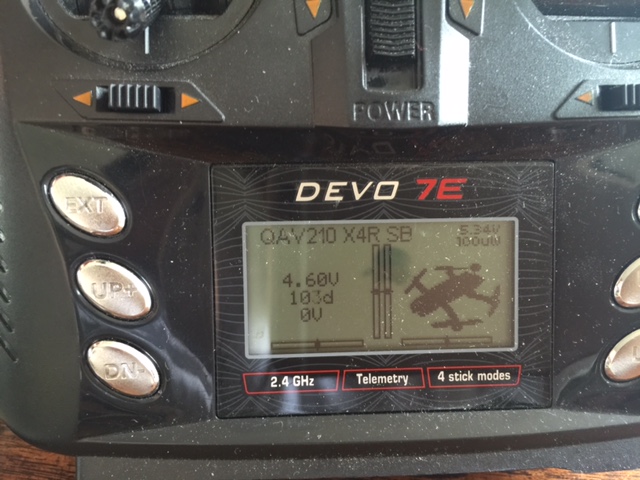

Ok the model is flying! I'm getting good RSSI and I am receiving 2 voltages but I'm not sure what either are... Which voltage corresponds to VFAS (the voltage values as read by cleanflight and sent from cleanflight telemetry over Smart Port)? I dont have AD2 hooked up.
20 May 2016 13:47 #48867
VFAS is in VOLTA - row 6 in the Bat column. The VOLT2 value in the pic does come in over s.port though - maybe cleanflight uses the AD2 ID? VOLT1 is the internal voltage of the receiver.

20 May 2016 15:30 - 20 May 2016 15:34 #48872
by Cereal_Killer
Replied by Cereal_Killer on topic New FrSkyX protocol
OK yes I see that and it's reading correct but how do I choose that value for a small box value to put on the main page? I have telemV1, telemV2 and TelemV3 as well as cell and cells1-6, no "voltA" and none of the V1 - V3 are it (they're all values under 5v)

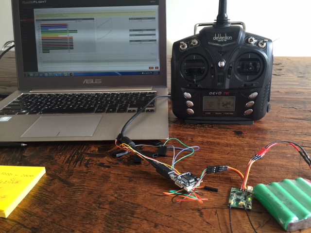

21 May 2016 15:40 - 21 May 2016 17:27 #48954
by Fernandez
Replied by Fernandez on topic New FrSkyX protocol
Devo 7e 5.0.0-481a401,nightly build.
Tested with X4R on Sbus connected to Raceflight.
I copied my model from devo 7e, from D4R.
Channel 1-8 tested and works. Rx volt works, RSSI works, AD1 volt not tested yet, will do later, but I find one issue.
scale +-125 for, D4R = 1000-2000 on flight controller
scale +-100 for, X4R = 1000-2000 on flight controller
For X4R setting scale +-125, will result in scale overflow, as will go over 2100, resulting in faulty data.
I would prefer to put scale identical to frsky D Protocol, then also models can be shared work identical one or the other protocol. And also because deviation, can go up to +-150 Scale and 125 scale setting will already lead to faulty result. (At least when tested with Raceflight, not sure if it is Sbus overflow, or Raceflight, who cant handle higher value than 2000 andy way at full stick value was completely wrong)
