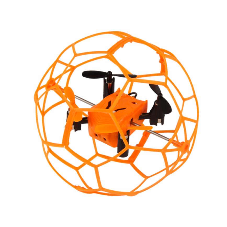

Hello.
Does anyone know what protocol to use with this very nice toy.
By the way, it's really fun to fly....
Thanks.
Vincent.

No idea with just a picture ... first try with every protocols and sub formats.
I'd try with the MJXq protocol + WLH08 sub-format first as I think it's the only one that has a air/ground channel as required by those "rolling" quads. Also, try with the YD717 protocol + skywlkr sub-format, as it's the same brand, maybe it's the same protocol ...
If no protocol is working then read this topic ;)
www.deviationtx.com/forum/protocol-devel...95-spi-capture-guide
