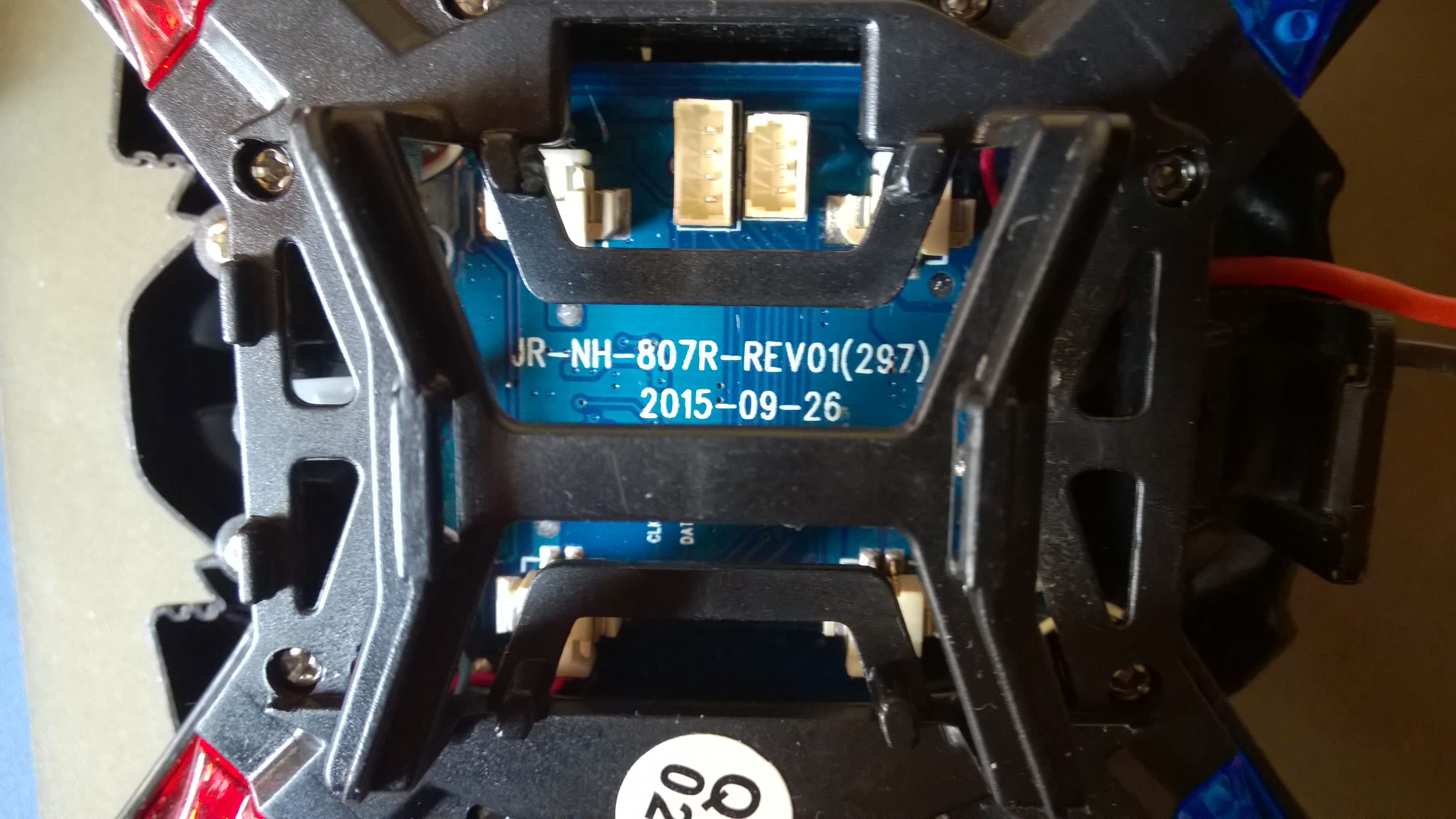

17 Feb 2017 07:13 - 17 Feb 2017 07:48 #59223
by youngpatrick
Nihui U807 with XN297L was created by youngpatrick
Last edit: 17 Feb 2017 07:48 by youngpatrick. Reason: Add photo of stock transmitter

According to the info
here
, U807 uses Flysky protocol or A7105 module. Are you sure your quad uses XN297L ?
Last edit: 17 Feb 2017 07:26 by ajtank.
- youngpatrick
- Posts: 5
17 Feb 2017 07:50 #59225
by youngpatrick
Replied by youngpatrick on topic Nihui U807 with XN297L
I have also binded the quadcopter with Flysky protocol (wltoys extension v6x6) but it failed :\

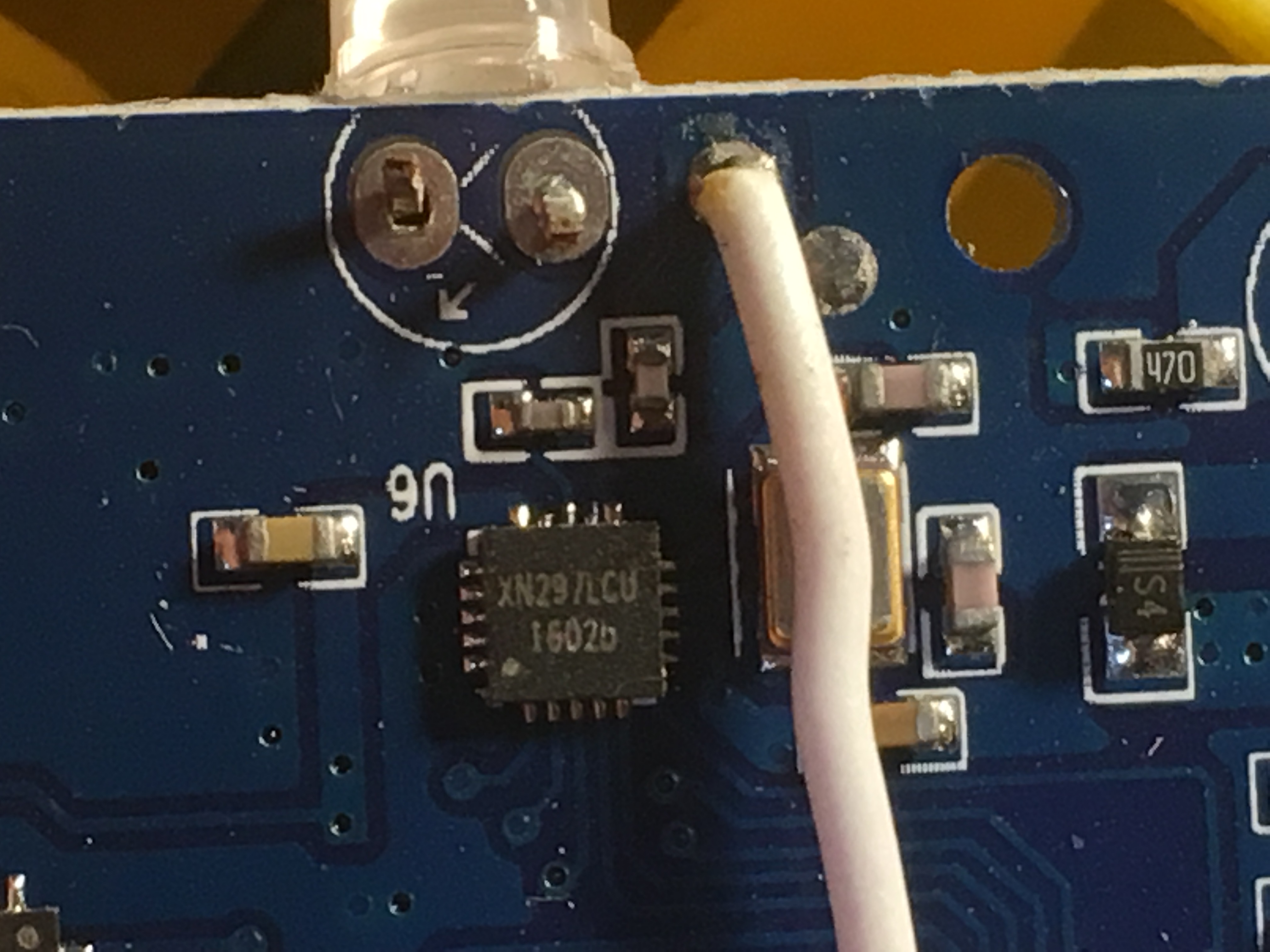

I did just get a new U807 and it has the same markings on the PCB. I have an older U807 which binds fine to my devo. This one won't. I tried using the transmitter that came with the U807 and it will not work with the old U807, but will work with the new U807, so I would say that the new revision uses a different protocol. Did you ever come up with something that would work?

02 Jul 2017 16:48 - 02 Jul 2017 16:49 #63249
by etoyoc
Replied by etoyoc on topic Nihui U807 with XN297L
Last edit: 02 Jul 2017 16:49 by etoyoc.
- captjack01
- Posts: 17
03 Jul 2017 01:09 - 03 Jul 2017 01:10 #63252
by captjack01
Replied by captjack01 on topic Nihui U807 with XN297L
looks like bad solder joint on pins in circle above it on led
Last edit: 03 Jul 2017 01:10 by captjack01.
- etoyoc
- Posts: 11
03 Jul 2017 13:04 - 03 Jul 2017 13:05 #63262
by etoyoc
more than adequate solder on the opposite side of the board, but yeah, not hardly any solder on this side. All 5 of the LED's are soldered with one pin not soldered on this side of the board. Soldering on the other side looks like something I would have done. Perhaps hand soldered and they just tacked the LED down on this side on one pin and flipped it over to solder both pins on the other side.
