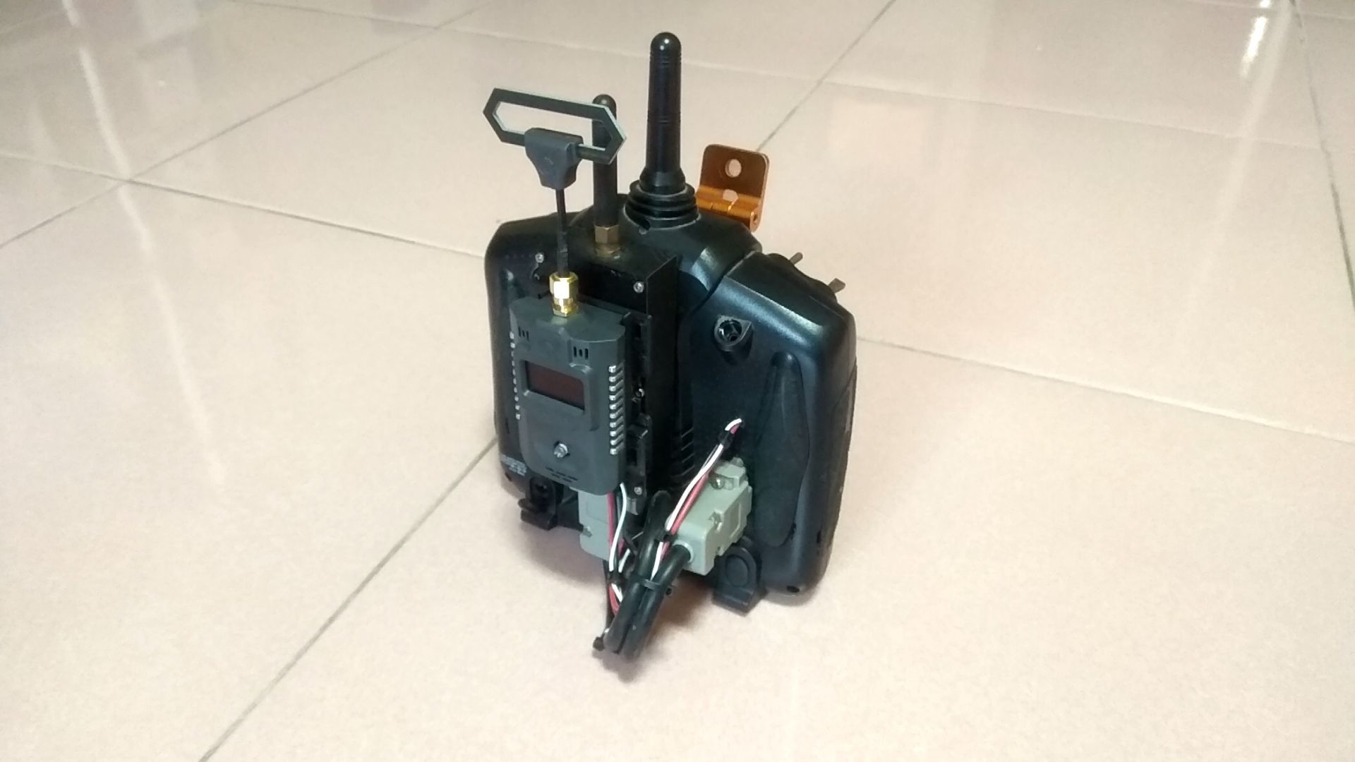

25 Mar 2022 07:14 - 25 Mar 2022 07:55 #77922 by marcus0304
Replied by marcus0304 on topic expressLRS
you can refer this topic:
www.deviationtx.com/forum/how-to/3592-7e...-out-and-deviationtx
In this Topic: using trainer wire connect to OpenPilot module. this method can connect ELRS module without drill a hole at radio back plate.
I drill a hole at radio back plate and connect ELRS module's CRSF pin to Devo7E's Trainer Top tip pad at 3.5mm jack board as attached picture below.
Considering Devo7E power drain. I use DC/DC 5v step-up module supplied by battery to connect ELRS Module.
I print a nano bay adapter to mount this module:
www.thingiverse.com/thing:5169757
you also have to use 2.54 round pin header (two side male ) to connect module and wire
Last edit: 25 Mar 2022 07:55 by marcus0304. Reason: Additional Information
31 Mar 2022 08:21 #77931 by KArlk.
Replied by KArlk. on topic expressLRS
Thanks for the info!
The pictures and diagrams are realy helpful. I've ordered the module and will try this as soon as it arrives.
