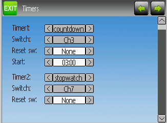

18 Feb 2013 20:47 #6529 by FDR
Replied by FDR on topic Standard Mixer Take-2
Not only a standard ui issue:
Since the timer page is one column again, there should be more space for the labels (especially for some translated texts).
The timer groups could be a little more separated.
The labels are not properly redrawn when they are changing (the old labels leave some residue).

18 Feb 2013 21:08 #6530 by rbe2012
Replied by rbe2012 on topic Standard Mixer Take-2
Tested devo8-8f97c19
Model menu: we have 16 icons. Should we arrange them 4x4? Or use the free space to display them in groups?
For the swash page: it would be nice and helpful to have an explanatory text or picture.
Also there: "ELE Mix" "Ail Mix" "Pit Mix": ELE should be Ele, I would like more longer text (no abbreviations)
Gyro sense: here is the different range obvious (and different to advanced gui). Should we notice it ("Range: 0 to 100%")?
Pitch curves: should be mentioned which switch is defined for throttle hold if used?
Switch assignment: there are again abbrevs.
BUG: Timer setting: try to set a switch for timer1 (countdown, ch3, 3:00) shows "00:00" in the switch field and asks for resetting.
BUG: Timer Setting: try to set a swich for timer2 (stopwatch, ch3) only ch3 selectable or none. Also for timer3
I don't like that when you changed standard to advanced or back you find yourself first in the old page structure. I think it would be better to switch back to main page, then to the new model menu, then to config page (maybe invisible for user).
Changing from standard to advanced: the gyro setting are not transferred. I did not examine too far but I think there maybe some old setting become visible. I think every value which is not transferred correctly (should never happen) should be set to an initial value. I will look into this tomorrow.

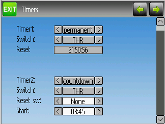

18 Feb 2013 22:07 - 18 Feb 2013 22:22 #6535 by domcars0
Replied by domcars0 on topic Standard Mixer Take-2
Hi FDR I've made some redesign for the Devo6/8/12 timers setup page.
Also the label refresh must be good now.
Also 4 timers will be available. I think permanent timers are usefull for lot of things! :cheer:
@rbe2012: normally you see the Reset field, with time in the button for resetting, when you choose permanent timer, not when you choose countdown nor stopwatch.
Last edit: 18 Feb 2013 22:22 by domcars0.

18 Feb 2013 23:35 - 18 Feb 2013 23:36 #6543 by domcars0
I don't understand why but it looks like when in standard mixer mode timers src
are restricted to the throttle channel (Ch3 or Ch1)?... I do not understand why sunvsuv made this restriction ?
Last edit: 18 Feb 2013 23:36 by domcars0.
18 Feb 2013 23:57 #6544 by PhracturedBlue
Replied by PhracturedBlue on topic Standard Mixer Take-2
He probably made it because this is generally what people use. I mean, how often do you base your timer on aileron motion?
Maybe it would make more sense to limit it to throttle output + switches though. The point is to make the interface intuitively obvious, and offering options that make no sense go against that principle. So while we could remove the restriction altogether, it is likely the wrong thing to do for the Standard mixer.
