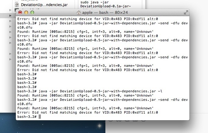

I've tried his java program. But i only have a windows pc.the device can not be recognized. So the java program report an error.
Is that you mean i should to try this program on linux or MacOS?

It won't recognize the device UID and PID on MAC?If so.I'll try it on the MAC in my office tomorrow.
Thanky you

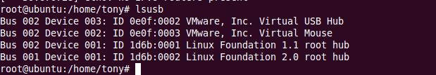

- sbstnp
- Posts: 649
28 May 2013 16:06 #10369
by sbstnp
Devo 10 + 4in1
Spektrum Dx9
FrSky Taranis + TBS Crossfire
Replied by sbstnp on topic Help,rom seems damaged
Until you try on another computer you won't know for sure, so don't think so far away. Download a Linux Live CD, connect the TX and turn it on with EXT pressed for upgrade mode, then run
and look for the right IDs.
lsusband look for the right IDs.

On linux I'd use 'lsusb' and 'dmesg' to find out what happens when you plug the Tx in. I'm not sure of the equivalent on a Mac.
I'll need some of this info to help you further.
A PL2303 should theoretically be able to communicate with the onboard bootloader. I'll try it on my Devo10 and see what options there are.
It is very odd that the USB doesn't work properly from within Deviation. We use a completely different stack, so it implies there may be a physical problem with the USB connectivity.

well,I'll try use 'lsusb' and 'dmesg' on a vm with ubuntu ,hope it works.
then if necessary, i can try to open the Tx to see is there any physical problem on it.

Here the result use lsusb and dmesg on vm with ubuntu
dmesg:

[ 1.295888] usb usb2: configuration #1 chosen from 1 choice
[ 1.295972] hub 2-0:1.0: USB hub found
[ 1.296058] hub 2-0:1.0: 2 ports detected
[ 1.296773] PNP: PS/2 Controller [PNP0303:KBC,PNP0f13:MOUS] at 0x60,0x64 irq 1,12
[ 1.298661] serio: i8042 KBD port at 0x60,0x64 irq 1
[ 1.298776] serio: i8042 AUX port at 0x60,0x64 irq 12
[ 1.310841] mice: PS/2 mouse device common for all mice
[ 1.313391] rtc_cmos 00:04: rtc core: registered rtc_cmos as rtc0
[ 1.314444] rtc0: alarms up to one month, y3k, 114 bytes nvram, hpet irqs
[ 1.315086] device-mapper: uevent: version 1.0.3
[ 1.315806] device-mapper: ioctl: 4.15.0-ioctl (2009-04-01) initialised: This email address is being protected from spambots. You need JavaScript enabled to view it.
[ 1.316378] input: AT Translated Set 2 keyboard as /devices/platform/i8042/serio0/input/input2
[ 1.320289] device-mapper: multipath: version 1.1.0 loaded
[ 1.320410] device-mapper: multipath round-robin: version 1.0.0 loaded
[ 1.331076] cpuidle: using governor ladder
[ 1.331154] cpuidle: using governor menu
[ 1.334235] TCP cubic registered
[ 1.334641] NET: Registered protocol family 10
[ 1.344982] lo: Disabled Privacy Extensions
[ 1.346270] NET: Registered protocol family 17
[ 1.348037] PM: Resume from disk failed.
[ 1.348138] registered taskstats version 1
[ 1.374591] Magic number: 13:555:10
[ 1.375267] rtc_cmos 00:04: setting system clock to 2013-05-29 04:02:59 UTC (1369800179)
[ 1.375313] BIOS EDD facility v0.16 2004-Jun-25, 0 devices found
[ 1.375327] EDD information not available.
[ 1.429028] Freeing initrd memory: 8162k freed
[ 1.481220] ata2.00: ATAPI: VMware Virtual IDE CDROM Drive, 00000001, max UDMA/33
[ 1.522347] ata2.00: configured for UDMA/33
[ 1.536915] scsi 1:0:0:0: CD-ROM NECVMWar VMware IDE CDR10 1.00 PQ: 0 ANSI: 5
[ 1.548806] sr0: scsi3-mmc drive: 12x/48x cd/rw xa/form2 cdda tray
[ 1.548927] Uniform CD-ROM driver Revision: 3.20
[ 1.549315] sr 1:0:0:0: Attached scsi CD-ROM sr0
[ 1.549745] sr 1:0:0:0: Attached scsi generic sg0 type 5
[ 1.550512] Freeing unused kernel memory: 880k freed
[ 1.553654] Write protecting the kernel read-only data: 7696k
[ 1.610253] usb 2-1: new full speed USB device using uhci_hcd and address 2
[ 1.625585] udev: starting version 151
[ 1.754261] VMware vmxnet3 virtual NIC driver - version 1.0.5.0-k-NAPI
[ 1.762980] usb 2-1: configuration #1 chosen from 1 choice
[ 1.890487] usb 2-2: new full speed USB device using uhci_hcd and address 3
[ 1.999031] VMware PVSCSI driver - version 1.0.1.0-k
[ 2.032362] Floppy drive(s): fd0 is 1.44M
[ 2.038153] Fusion MPT base driver 3.04.12
[ 2.038180] Copyright (c) 1999-2008 LSI Corporation
[ 2.042878] usb 2-2: configuration #1 chosen from 1 choice
[ 2.043345] usbcore: registered new interface driver hiddev
[ 2.049418] input: VMware VMware Virtual USB Mouse as /devices/pci0000:00/0000:00:11.0/0000:02:00.0/usb2/2-1/2-1:1.0/input/input3
[ 2.050104] generic-usb 0003:0E0F:0003.0001: input,hidraw0: USB HID v1.10 Mouse [VMware VMware Virtual USB Mouse] on usb-0000:02:00.0-1/input0
[ 2.050233] hub 2-2:1.0: USB hub found
[ 2.051758] FDC 0 is a post-1991 82077
[ 2.052384] hub 2-2:1.0: 7 ports detected
[ 2.060945] input: VMware VMware Virtual USB Mouse as /devices/pci0000:00/0000:00:11.0/0000:02:00.0/usb2/2-1/2-1:1.1/input/input4
[ 2.061040] generic-usb 0003:0E0F:0003.0002: input,hidraw1: USB HID v1.10 Mouse [VMware VMware Virtual USB Mouse] on usb-0000:02:00.0-1/input1
[ 2.061079] usbcore: registered new interface driver usbhid
[ 2.061093] usbhid: v2.6:USB HID core driver
[ 2.061452] Fusion MPT SPI Host driver 3.04.12
[ 2.061868] mptspi 0000:00:10.0: PCI INT A -> GSI 17 (level, low) -> IRQ 17
[ 2.063274] VMware vmxnet virtual NIC driver
[ 2.065324] mptbase: ioc0: Initiating bringup
[ 2.212906] Intel(R) PRO/1000 Network Driver - version 7.3.21-k5-NAPI
[ 2.212919] Copyright (c) 1999-2006 Intel Corporation.
[ 2.213177] alloc irq_desc for 19 on node -1
[ 2.213181] alloc kstat_irqs on node -1
[ 2.213233] e1000 0000:02:01.0: PCI INT A -> GSI 19 (level, low) -> IRQ 19
[ 2.213372] e1000 0000:02:01.0: setting latency timer to 64
[ 2.240568] ioc0: LSI53C1030 B0: Capabilities={Initiator}
[ 2.549292] e1000: 0000:02:01.0: e1000_probe: (PCI:66MHz:32-bit) 00:0c:29:89:92:bb
[ 2.615372] e1000: eth0: e1000_probe: Intel(R) PRO/1000 Network Connection
[ 2.939231] scsi2 : ioc0: LSI53C1030 B0, FwRev=01032920h, Ports=1, MaxQ=128, IRQ=17
[ 3.230992] scsi 2:0:0:0: Direct-Access VMware, VMware Virtual S 1.0 PQ: 0 ANSI: 2
[ 3.232695] scsi target2:0:0: Beginning Domain Validation
[ 3.238190] scsi target2:0:0: Domain Validation skipping write tests
[ 3.238279] scsi target2:0:0: Ending Domain Validation
[ 3.239038] scsi target2:0:0: FAST-40 WIDE SCSI 80.0 MB/s ST (25 ns, offset 127)
[ 3.245825] sd 2:0:0:0: Attached scsi generic sg1 type 0
[ 3.250879] sd 2:0:0:0: [sda] 41943040 512-byte logical blocks: (21.4 GB/20.0 GiB)
[ 3.251170] sd 2:0:0:0: [sda] Write Protect is off
[ 3.251201] sd 2:0:0:0: [sda] Mode Sense: 61 00 00 00
[ 3.251572] sd 2:0:0:0: [sda] Cache data unavailable
[ 3.251601] sd 2:0:0:0: [sda] Assuming drive cache: write through
[ 3.252833] sd 2:0:0:0: [sda] Cache data unavailable
[ 3.252838] sd 2:0:0:0: [sda] Assuming drive cache: write through
[ 3.252959] sda: sda1 sda2 < sda5 >
[ 3.277704] sd 2:0:0:0: [sda] Cache data unavailable
[ 3.277709] sd 2:0:0:0: [sda] Assuming drive cache: write through
[ 3.277745] sd 2:0:0:0: [sda] Attached SCSI disk
[ 3.500711] EXT4-fs (sda1): mounted filesystem with ordered data mode
[ 18.341835] udev: starting version 151
[ 18.386574] Adding 916472k swap on /dev/sda5. Priority:-1 extents:1 across:916472k
[ 18.466884] lp: driver loaded but no devices found
[ 18.495747] piix4_smbus 0000:00:07.3: Host SMBus controller not enabled!
[ 18.502943] shpchp: Standard Hot Plug PCI Controller Driver version: 0.4
[ 18.532554] agpgart-intel 0000:00:00.0: Intel 440BX Chipset
[ 18.539163] vga16fb: initializing
[ 18.539221] vga16fb: mapped to 0xffff8800000a0000
[ 18.539939] fb0: VGA16 VGA frame buffer device
[ 18.545487] [356]: VMCI: shared components initialized.
[ 18.553070] agpgart-intel 0000:00:00.0: AGP aperture is 256M @ 0x0
[ 18.553192] Probing for vmci/PCI.
[ 18.553227] alloc irq_desc for 16 on node -1
[ 18.553230] alloc kstat_irqs on node -1
[ 18.553251] vmci 0000:00:07.7: PCI INT A -> GSI 16 (level, low) -> IRQ 16
[ 18.553324] Found vmci/PCI at 0x1080, irq 16.
[ 18.553379] VMCI: using capabilities 0xc.
[ 18.553554] [356]: VMCI: Host capability check passed.
[ 18.554093] alloc irq_desc for 56 on node -1
[ 18.554095] alloc kstat_irqs on node -1
[ 18.554174] vmci 0000:00:07.7: irq 56 for MSI/MSI-X
[ 18.554179] alloc irq_desc for 57 on node -1
[ 18.554181] alloc kstat_irqs on node -1
[ 18.554224] vmci 0000:00:07.7: irq 57 for MSI/MSI-X
[ 18.554692] Registered vmci device.
[ 18.554835] [356]: VMCI: Using guest personality
[ 18.555027] [356]: VMCI: host components initialized.
[ 18.555138] [356]: VMCI: Module registered (name=vmci,major=10,minor=55).
[ 18.555155] [356]: VMCI: Using host personality
[ 18.555166] [356]: VMCI: Module (name=vmci) is initialized
[ 18.962019] type=1505 audit(1369800197.084:2): operation="profile_load" pid=462 name="/sbin/dhclient3"
[ 18.962357] type=1505 audit(1369800197.084:3): operation="profile_load" pid=462 name="/usr/lib/NetworkManager/nm-dhcp-client.action"
[ 18.962460] type=1505 audit(1369800197.084:4): operation="profile_load" pid=462 name="/usr/lib/connman/scripts/dhclient-script"
[ 19.060448] parport_pc 00:09: reported by Plug and Play ACPI
[ 19.060803] parport0: PC-style at 0x378, irq 7 [PCSPP,TRISTATE]
[ 19.368116] input: ImPS/2 Generic Wheel Mouse as /devices/platform/i8042/serio1/input/input5
[ 19.380701] lp0: using parport0 (interrupt-driven).
[ 19.523361] ppdev: user-space parallel port driver
[ 19.857822] ENS1371 0000:02:02.0: PCI INT A -> GSI 16 (level, low) -> IRQ 16
[ 19.885067] Console: switching to colour frame buffer device 80x30
[ 20.493532] type=1505 audit(1369800198.614:5): operation="profile_load" pid=738 name="/usr/share/gdm/guest-session/Xsession"
[ 20.502899] type=1505 audit(1369800198.624:6): operation="profile_replace" pid=739 name="/sbin/dhclient3"
[ 20.503343] type=1505 audit(1369800198.624:7): operation="profile_replace" pid=739 name="/usr/lib/NetworkManager/nm-dhcp-client.action"
[ 20.503449] type=1505 audit(1369800198.624:
[ 20.518419] type=1505 audit(1369800198.634:9): operation="profile_load" pid=740 name="/usr/bin/evince"
[ 20.561550] type=1505 audit(1369800198.684:10): operation="profile_load" pid=740 name="/usr/bin/evince-previewer"
[ 20.563210] type=1505 audit(1369800198.684:11): operation="profile_load" pid=740 name="/usr/bin/evince-thumbnailer"
[ 20.631725] e1000: eth0 NIC Link is Up 1000 Mbps Full Duplex, Flow Control: None
[ 20.661576] ADDRCONF(NETDEV_UP): eth0: link is not ready
[ 20.663004] ADDRCONF(NETDEV_CHANGE): eth0: link becomes ready
[ 21.371093] acpiphp: ACPI Hot Plug PCI Controller Driver version: 0.5
[ 21.372504] acpiphp: Slot [32] registered
[ 21.381352] acpiphp: Slot [33] registered
[ 21.381867] acpiphp: Slot [34] registered
[ 21.382412] acpiphp: Slot [35] registered
[ 21.382817] acpiphp: Slot [36] registered
[ 21.383275] acpiphp: Slot [37] registered
[ 21.383681] acpiphp: Slot [38] registered
[ 21.384083] acpiphp: Slot [39] registered
[ 21.384457] acpiphp: Slot [40] registered
[ 21.384824] acpiphp: Slot [41] registered
[ 21.385211] acpiphp: Slot [42] registered
[ 21.385582] acpiphp: Slot [43] registered
[ 21.385958] acpiphp: Slot [44] registered
[ 21.386427] acpiphp: Slot [45] registered
[ 21.386806] acpiphp: Slot [46] registered
[ 21.387213] acpiphp: Slot [47] registered
[ 21.387596] acpiphp: Slot [48] registered
[ 21.387988] acpiphp: Slot [49] registered
[ 21.388363] acpiphp: Slot [50] registered
[ 21.388737] acpiphp: Slot [51] registered
[ 21.389128] acpiphp: Slot [52] registered
[ 21.389500] acpiphp: Slot [53] registered
[ 21.389879] acpiphp: Slot [54] registered
[ 21.391058] acpiphp: Slot [55] registered
[ 21.391441] acpiphp: Slot [56] registered
[ 21.391813] acpiphp: Slot [57] registered
[ 21.392343] acpiphp: Slot [58] registered
[ 21.392736] acpiphp: Slot [59] registered
[ 21.393133] acpiphp: Slot [60] registered
[ 21.393518] acpiphp: Slot [61] registered
[ 21.393902] acpiphp: Slot [62] registered
[ 21.394352] acpiphp: Slot [63] registered
[ 21.395092] acpiphp_glue: Slot 160 already registered by another hotplug driver
[ 21.395151] acpiphp_glue: Slot 192 already registered by another hotplug driver
[ 21.395186] acpiphp_glue: Slot 224 already registered by another hotplug driver
[ 21.395221] acpiphp_glue: Slot 256 already registered by another hotplug driver
[ 21.395281] acpiphp_glue: Slot 161 already registered by another hotplug driver
[ 21.395315] acpiphp_glue: Slot 162 already registered by another hotplug driver
[ 21.395348] acpiphp_glue: Slot 163 already registered by another hotplug driver
[ 21.395380] acpiphp_glue: Slot 164 already registered by another hotplug driver
[ 21.395412] acpiphp_glue: Slot 165 already registered by another hotplug driver
[ 21.395449] acpiphp_glue: Slot 166 already registered by another hotplug driver
[ 21.395481] acpiphp_glue: Slot 167 already registered by another hotplug driver
[ 21.395513] acpiphp_glue: Slot 193 already registered by another hotplug driver
[ 21.395548] acpiphp_glue: Slot 194 already registered by another hotplug driver
[ 21.395584] acpiphp_glue: Slot 195 already registered by another hotplug driver
[ 21.395618] acpiphp_glue: Slot 196 already registered by another hotplug driver
[ 21.395650] acpiphp_glue: Slot 197 already registered by another hotplug driver
[ 21.395682] acpiphp_glue: Slot 198 already registered by another hotplug driver
[ 21.395714] acpiphp_glue: Slot 199 already registered by another hotplug driver
[ 21.395746] acpiphp_glue: Slot 225 already registered by another hotplug driver
[ 21.395784] acpiphp_glue: Slot 226 already registered by another hotplug driver
[ 21.395816] acpiphp_glue: Slot 227 already registered by another hotplug driver
[ 21.395848] acpiphp_glue: Slot 228 already registered by another hotplug driver
[ 21.395880] acpiphp_glue: Slot 229 already registered by another hotplug driver
[ 21.395912] acpiphp_glue: Slot 230 already registered by another hotplug driver
[ 21.395944] acpiphp_glue: Slot 231 already registered by another hotplug driver
[ 21.396012] acpiphp_glue: Slot 257 already registered by another hotplug driver
[ 21.396049] acpiphp_glue: Slot 258 already registered by another hotplug driver
[ 21.396081] acpiphp_glue: Slot 259 already registered by another hotplug driver
[ 21.396113] acpiphp_glue: Slot 260 already registered by another hotplug driver
[ 21.396145] acpiphp_glue: Slot 261 already registered by another hotplug driver
[ 21.396178] acpiphp_glue: Slot 262 already registered by another hotplug driver
[ 21.396210] acpiphp_glue: Slot 263 already registered by another hotplug driver
[ 22.053958] vmmemctl: started kernel thread pid=953
[ 22.054025] VMware memory control driver initialized
[ 27.234981] __ratelimit: 9 callbacks suppressed
[ 27.235235] type=1503 audit(1369800208.012:15): operation="capable" pid=1608 parent=1594 profile="/usr/sbin/cupsd" name="sys_admin"
[ 30.670728] eth0: no IPv6 routers present
root@ubuntu:/home/tony#
