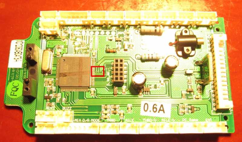

i fond the pin assignments from the datasheet that:
pin 68 - TXD
pin 69 - RXD
and on the pic below,marked red border:
left - TXD
right - RXD

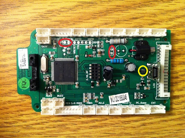

I've circled the places where jumpers would be installed in red here:
you need to be able to connect and disconnect them quickly as the Tx won't boot when they are shorted. So install a pair of headers on each and then use a jumper to short them.
Again, I doubt it will help much, since the problem is unlikely to be with the bootloader.
I see on the devo10 they used what looks like a balun (circled in yellow). I had the same on my devo8 (I recalled resistors there, but I must have been thinking about the UART pins). you can remove this and then solder to the STM32 side to connect a new USB port, or jumper across it to restore the connection to the existing port. I run my Devo8 without that balun and it works just fine (I just shorted wires across the pads).
edit: As I recall there are 3 connections that matter on the USB port, Rx, Tx, and Gnd. the GND is NOT the same as the outside can though. you need to ensure the gnd pin is connected as well. As I've already said, I'm really at a loss as to why yours won't connect if the connections are all ok.
Last edit: 05 Jun 2013 06:05 by PhracturedBlue.

I solder 3 wires on the bord, one for data+, one for data- and the other for GND and connect to a female USB port and then connect to computer(with linux live cd)

05 Jun 2013 16:50 #10617 by PhracturedBlue
Replied by PhracturedBlue on topic Help,rom seems damaged
tony1157cn wrote: I checked the topic about the USBcode then switch to root user
then typed the command again
the report:
Found: DFU [00483:df11] cfg=1, intf=0, alt=0, name='@Internal Flash '
Found: DFU [00483:df11] cfg=1, intf=0, alt=1, name='@SPI Flash: Config'
Found: DFU [00483:df11] cfg=1, intf=0, alt=2, name='@SPI Flash: Library'
Determining device status: statue=dfuERROR status=10
dfuERROR, clearing status
Determining device status: statue=dfuIDLE status=0
dfuIDLE, continuing
dfuIDLE, continuing
Setting address pointer to 0x8000400
Poll timeout 104 ms
bytes_per_hash=1024
Starting upload
Encrypting txid for Devo 10
is that mean successed?
Yep, you are good to go. This tool is still experimental, and writes out a lot of debug messages.
To format the flash drive, you my need to use windows. I've never tried it on linux.

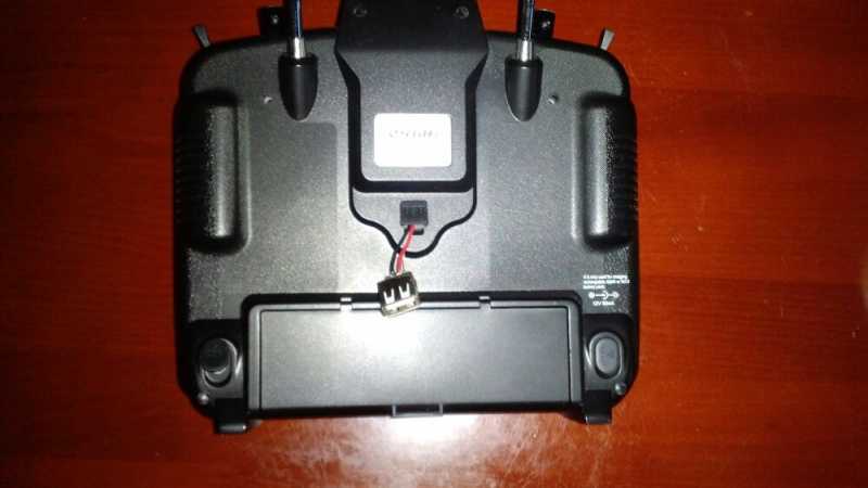

06 Jun 2013 01:56 #10621 by tony1157cn
Replied by tony1157cn on topic Help,rom seems damaged
:cheer:
ha ha ha
see the ugly tail
it's unimaginable
i'v test the usb port several times by multimeter,the port and the wire on the small board all looks work well.
I've just weld the wire on the main board crossed the small board yesterday,and it works.
FXXX Walkera!!
Thank you all guys! Thanks for your help!
Then I'll try to use a new mini port to instead the old one, or if the problem caused by the small board,I'll try to make a new one.I don't like the ugly tail. ;)
