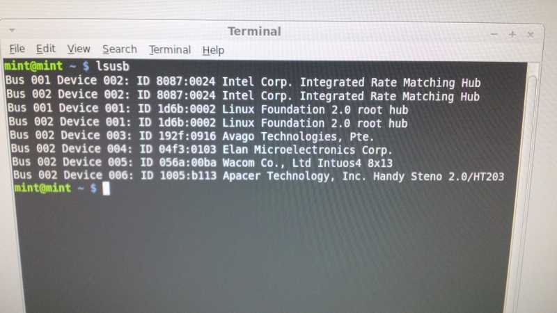

Did you well plug your Devo JUST before enter the dmesg command ? (If so I think it's really damaged)
29 May 2013 06:31 #10387
Replied by rbe2012 on topic Help,rom seems damaged
The linux dmesg looks like being from a virtual machine - have you assured that the tx is associated to it and not to the host system?

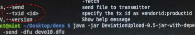

29 May 2013 09:02 #10395
I haven't used PBs tool yet but from the screenshots I would try to give the parameter "--txid 0000:0000" in addition. If your tx uses these values as you have written somewhere above it might work (although the output of dmesg makes me pessimistic).
- tony1157cn
- Posts: 31
29 May 2013 10:06 #10398
by tony1157cn
Replied by tony1157cn on topic Help,rom seems damaged
PBs tool has not the parameter like "txid"

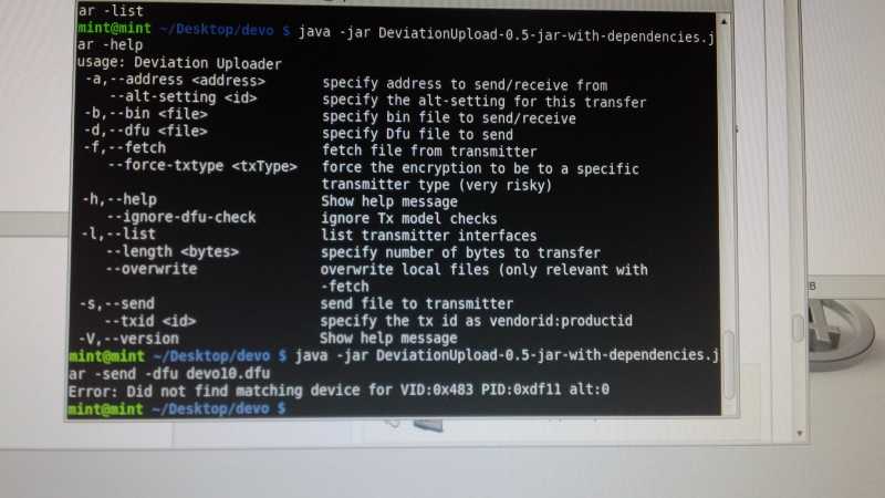

29 May 2013 14:16 #10402
by tony1157cn
@sbstnp
tried a few usb cables, tried on mac,linux,window,returns the same error
@rbe2012
this is the result i tried with different command
mint@mint ~/Desktop/devo $ java -jar DeviationUpload-0.5-jar-with-dependencies.jar -send -dfu devo10.dfu
Error: Did not find matching device for VID:0x483 PID:0xdf11 alt:0
mint@mint ~/Desktop/devo $ java -jar DeviationUpload-0.5-jar-with-dependencies.jar -send -txid0000:0000 -dfu devo10.dfu
mint@mint ~/Desktop/devo $ java -jar DeviationUpload-0.5-jar-with-dependencies.jar -send -txid 0000:0000 -dfu devo10.dfu
mint@mint ~/Desktop/devo $ java -jar DeviationUpload-0.5-jar-with-dependencies.jar -send --txid 0000:0000 -dfu devo10.dfu
not work

29 May 2013 14:17 #10403
Replied by PhracturedBlue on topic Help,rom seems damaged
I don't think I actually coded the --txid yet. But it wouldn't help here anyway. As the lsusb says, there is no device to connect to. Your dmesg logs say it failed to enumerate which is a bad sign.
Can you do the same thing holding the 'ENT' button (entering USB filesystem mode)?
As sbstnp asked, have you tried a different USB cable?
This looks like the Tx is working fine but the USB signal is not being transmitted properly. The most likely reason is that either the USB plug is not making a proper connection. It could be the cable, or the plug, or the socket on the board or a trace on the board, or the isolation resistor.
I've broken the USB socket off my Devo8 twice now (but I abuse it more than anyone is likely to, so I don't blame Walkera for that). If a different cable doesn't help, you'll need to open the Tx, and trace the line from the usb-socket to the MCU (it is a nice straight line...I think it is on the top of the board on the devo10). there are 2 lines, each with a small resistor on them.

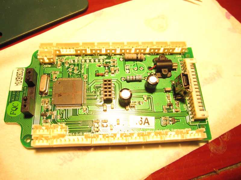

I have just opened the Tx and checked the mainbord.
I can't see any physical damages.
then i checked the usb socket use a multimeter, it looks like the date+ and data- is connected with the chip very well. I heard the "bee" sound when i connect the the two points on the usb socket and chip with the multimeter.
I can't find where the VDD conntct to.
is this help to find out the problem?

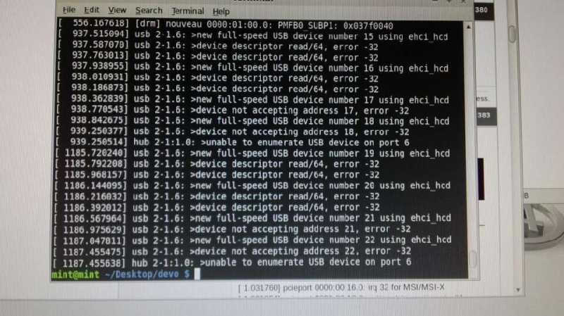

It is very odd. I'm really not sure what else to look at if the connectivity is good Maybe the socket itself, butit isn't all that easy to probe the socket accurately.
Can you post lsusb and dmesg logs when you boot with 'ENT' rather than 'EXT' pressed?
We can still try re-flashing the bootloader, but I'm skeptical that will help if even my code can't talk to the USB port.

here is the log boot with ENT
lsusb:
mint@mint ~ $ lsusb
Bus 001 Device 003: ID 1005:b113 Apacer Technology, Inc. Handy Steno 2.0/HT203
Bus 002 Device 002: ID 1267:0201 Logic3 / SpectraVideo plc A4Tech SWOP-3 Mouse
Bus 001 Device 001: ID 1d6b:0002 Linux Foundation 2.0 root hub
Bus 002 Device 001: ID 1d6b:0001 Linux Foundation 1.1 root hub
dmesg:
[ 309.920027] usb 2-5: >new full-speed USB device number 3 using ohci_hcd
[ 310.100009] usb 2-5: >device descriptor read/64, error -62
[ 310.384015] usb 2-5: >device descriptor read/64, error -62
[ 310.664018] usb 2-5: >new full-speed USB device number 4 using ohci_hcd
[ 310.844010] usb 2-5: >device descriptor read/64, error -62
[ 311.128014] usb 2-5: >device descriptor read/64, error -62
[ 311.408019] usb 2-5: >new full-speed USB device number 5 using ohci_hcd
[ 311.816012] usb 2-5: >device not accepting address 5, error -62
[ 311.992011] usb 2-5: >new full-speed USB device number 6 using ohci_hcd
[ 312.400013] usb 2-5: >device not accepting address 6, error -62
[ 312.400027] hub 2-0:1.0: >unable to enumerate USB device on port 5

Finally, I found the RXD / TXD foot,and the boot0 foot.It seems like the boot0 has been set to Hight level.
All those look well, maybe I coluld try to reinstall the bootloader, but I don't have the HEX file.Orz......
