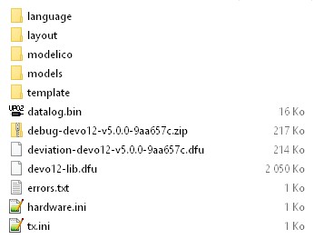

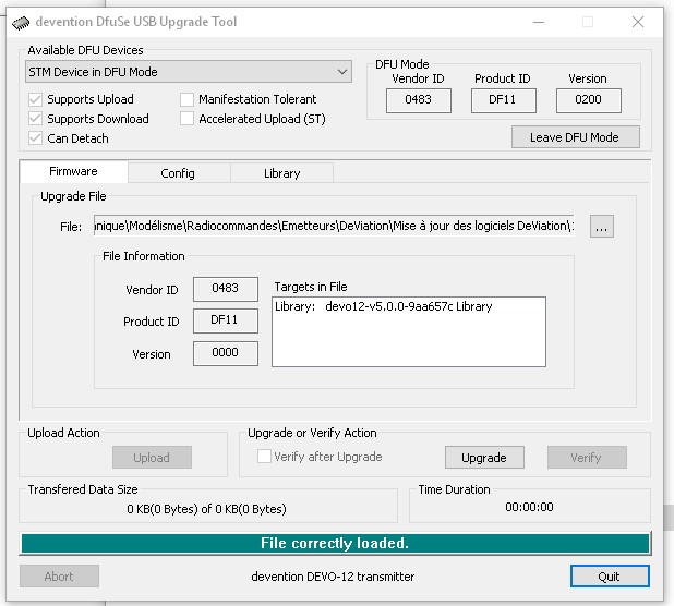

Hello, I installed the file devo12-V5.0.0.dfu, but the file devo-lib. Dfu does not install. I'm not sure if I have the correct version of Dfuse and / or the STM32 driver. Could you help me? Here are the photos.

From the pictures you are showing, You try to upgrade a librery dfu.
You should do ths under the librery tab.

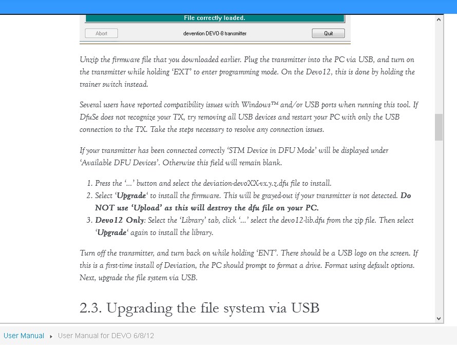

In fact I think I followed the procedure (see picture below), but there must be something else...

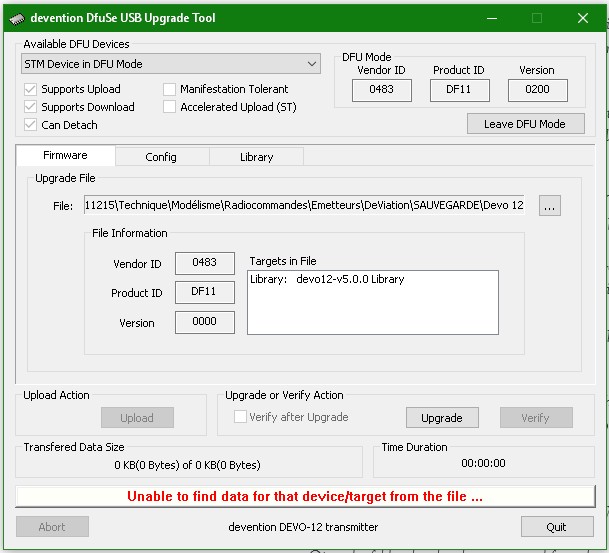

For the passage of my Devo 12S under Deviation, I took the file Devo 12, I think it's OK. I used version 5.0.0 and also a nighty. I replaced my Dfuse version by this one v2.31 - October 6, 2014. I added in my computer the driver STM32 DFU windows 10, but I still have the same problem.
The first dev file upgrade deviation-devo12-v5.0.0 goes well, the second devo12-lib loads, but there is an error message that appears by pressing upgrade. Here are the photos. Do you have any idea what's going wrong?

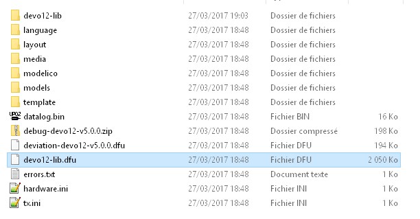

Here is a photo of the files, do you have the same sizes?

Replied by vlad_vy on topic How to upgrade with Devo 12S
Change program tab to "Library" and Upgrade with "devo12-lib.dfu" file.

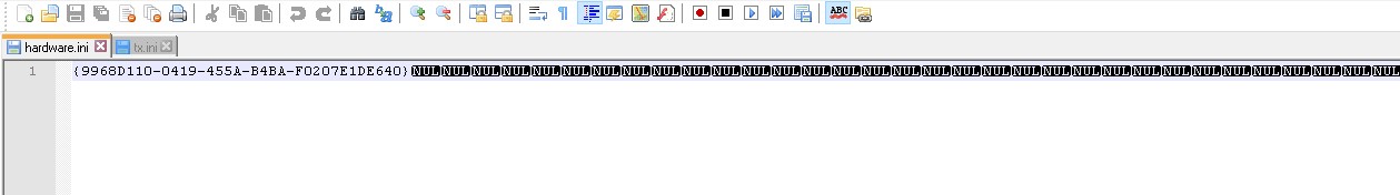

I received the 4 in 1 module from Banggood and what's bizarre when I edit the hardware.ini file under notpad ++ I have only one line. I'll make you a copy. And if I copy a good file, it goes back on a single line.
