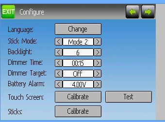

1) The auto dimmer feature is in. While I am working on its configure pages ,please take a look at its current logic and let me know if you want a higher frequency for the back-light scanning
2) Fix a major bug in calibration

08 Nov 2012 23:20 #2798 by PhracturedBlue
Replied by PhracturedBlue on topic PB, request for code review and merge back(2)
Overall, the autodim feature looks ok.
2 things:
1) why do you need to check it in the GUI? I don't think that is the right place to check the Dimmer. in the main loop (for powerdown) and in the button and touch handlers (for power up) should be sufficient, it seems to me.
2) I don't see any value in your low-priority functions. The screen update at 100msec is low speed enough for anything we need in my opinion, so just put it there.
09 Nov 2012 13:41 #2805 by suvsuv

Today I make quite a few checkin, please take a look and have them merged back to your repo:
1) Merged your latest update except change related Expo&DR in the mixer setup
2) Provide configuration UI for auto-dimmer setting in both devo10 and devo8, please verify it in your devo8 TX
