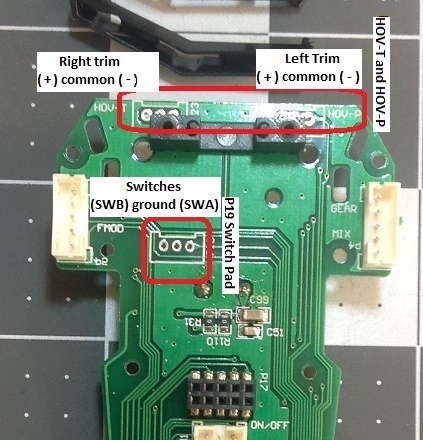

(wow, the only time ever when MS Office clipboard has come in handy! completely lost my post when uploading...)
P19 doesn't bother me as long as we document which pad is associated with which switch; it's three pads close together, so doesn't matter which switch wire goes left and which goes right.
However, it makes sense to me that, if possible, wires coming from the left-hand side of the PCB (when looking from the front) shouldn't have to criss-cross over to the right-hand side of the body in order to correlate with the naming convention.
Again, with the "+" and "-" pads of the trims it doesn't really bother me which is which but we have to agree on a standard and document it. My intended setup was to have the "+" happen when pulling forward, "-" happen when pushing back; in my case, the red and blue wires were intended to correlate to the "+", yellow and green to the "-", but Trim_R (left pads, aka "Hov-T") didn't work out this way.

PCB; P19 soldered from underneath, Hov-P and Hov-T from above, hot-melt glue added later for insulation

RE: trim names, here's my suggestion, to suit the physical layout if you take the central pads to both be "+"
trim_r+ should be trim_l-
trim_r- should be trim_l+
trim_l+ should be trim_r+
trim_l- should be trim_r-

The wiring I am using is giving me the results I need: SWA is located on the Left shoulder, position 0 toward the back of the tx. Likewise, SWB is located on the right shoulder, position 0 is toward the back of the tx. So the labeling in this version deviation-devo6-v4.0.1-667678f is exactly as expected.

Deal57, can you confirm which switches you wired up where, and what their names resulted in for you? Did you wire up as per your photo
here
, and if so do the switches/buttons correlate to your labels?

Wait, I think I've f@#ked up with the trim wiring colours, hov-t really should end up as the right not the left, I need to investigate tomorrow
10 Feb 2016 16:49 - 10 Feb 2016 18:14 #42955
Replied by Deal57 on topic Adding switches to devo 6s
I took my Devo6s apart and I can confirm that the switches and trims are correct in my installation and HOV-T is on the RIGHT side. However I got the photo labels wrong. I even coded my cabling for RIGHT=GREEN, LEFT=RED
. EDIT: Also in re-reading your notes I found that the + and - on the RIGHT side (HOV-T) are reversed, as you noted. I've attached the correction here.
The P19 pad is correct: SWB (in my cable its the black wire) is the right-side 2-way switch, and SWA (the red wire) is the left side 2-way switch.
I'm pretty sure that this matches my button and switch test results. It's darn confusing...

Yeah late last night I had a "relevation" (© The Good Dinosaur™) while trying to get a screaming baby to sleep, hence the abrupt message; this is the back of the PCB/front case, and when installing switches you are looking at the front of the rear case, so you need to remember that one or the other will be reversed!
So SWB on the left pad and SWA on the right pad makes sense, as the left corresponds to the right side of the TX when facing it normally.
I forgot about this when doing my coloured wires, eg. had red/black/yellow on hov-t, which should end up on the right-hand shoulder, but put the switch with that colour wiring onto the left-hand shoulder, the same side as the pads when facing the PCB.
So, naming is sorted, let's lock it in, Eddie.
