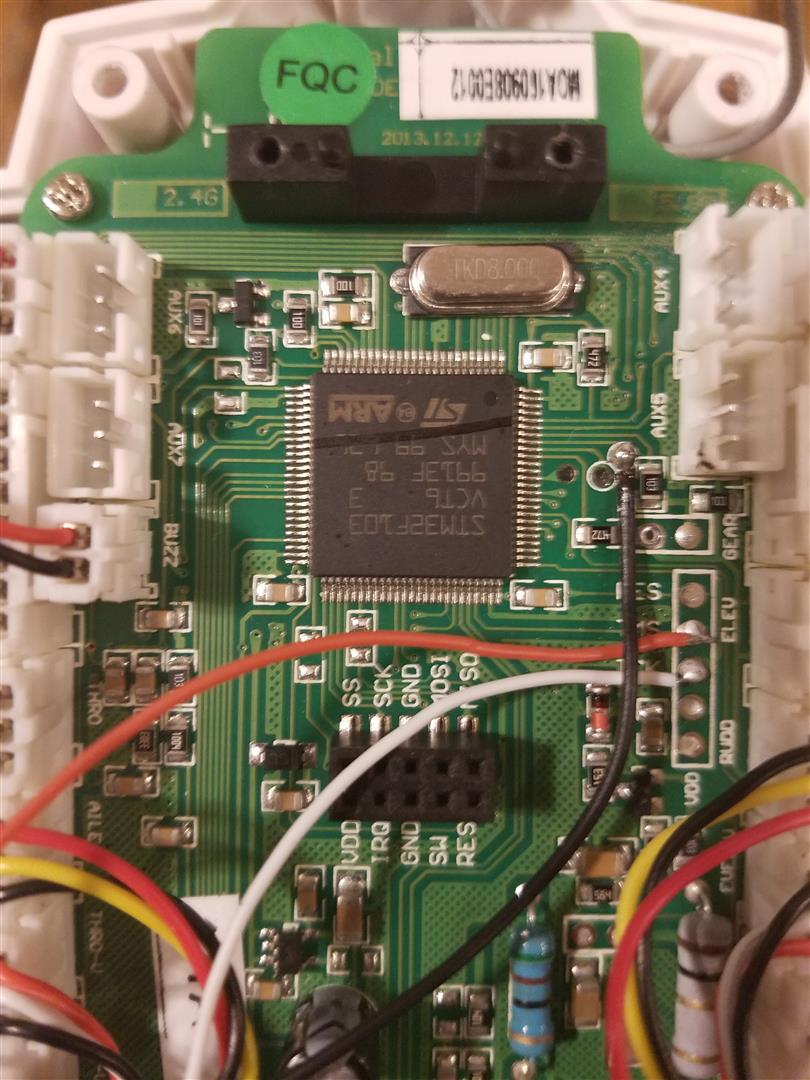

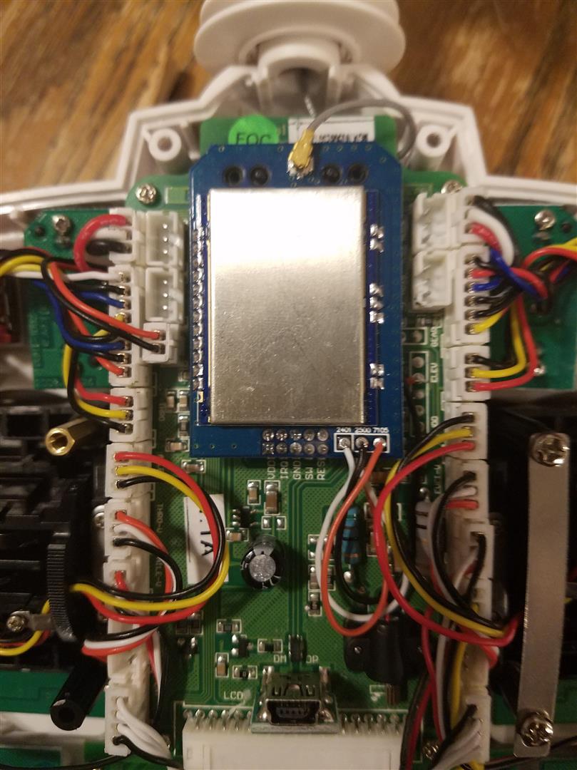

Received my 12e a couple of days ago. Flashed it with the nightly build of deviation for the 12e. Installed the new devo 4 in 1 module. I have been able to fly my hubsan and eachine h8 mini. When booting up there are no module errors so mostly everything is good.
There is one glitch when I go to the channel monitor for the 4 pots I have no activity showing on 3 of them and on the aux4 I only have readings of 0 and 100. It is behaving like a switch. Has anyone else tried the pots to see if they work? I was positive that I plugged them back correctly to the board.
I have attached a couple of photos of the 4 in 1 install. I put one module each on TMS and TCK, and the third wire on a pad on the board. I have assigned that module the B7 pin and it appears to be working though I don't have C22500 receivers to test with and havent tested it with DSM2.

- victzh
- Posts: 1386
02 Jan 2017 03:50 #57448
by victzh
Replied by victzh on topic Devo 12e $75 for deviation fans
Try to calibrate the TX. Gimbal settings are OK by default, AUXes are not.
- robca
- Posts: 174
02 Jan 2017 08:02 #57458
by robca
enable-cc2500 = B&
I think you wanted to have B7 there, and hit Shift by mistake
Replied by robca on topic Devo 12e $75 for deviation fans
Methinks your CC2500 won't work:compman2 wrote: I have attached a couple of photos of the 4 in 1 install. I put one module each on TMS and TCK, and the third wire on a pad on the board. I have assigned that module the B7 pin and it appears to be working though I don't have C22500 receivers to test with and havent tested it with DSM2.
enable-cryf6936 = B12
has_pa-cryf6936 = 1
enable-a7105 = A13
has_pa-a7105 = 1
enable-cc2500 = B&
has_pa-cc2500 = 1
enable-nrf24l01 = A14
has_pa-nrf24l01 = 1
enable-cc2500 = B&

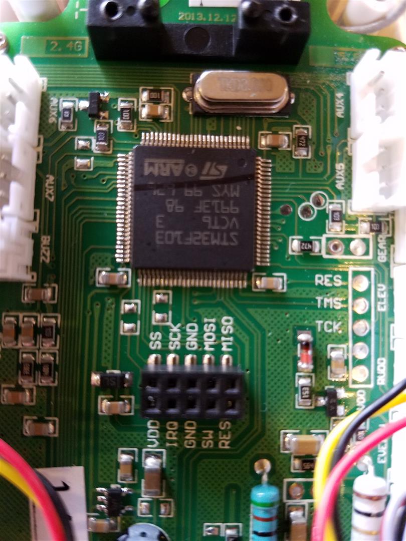

- Cereal_Killer
02 Jan 2017 14:30 #57469
by Cereal_Killer
Replied by Cereal_Killer on topic Devo 12e $75 for deviation fans
Why does the STM32 of every Devo tx I've ever seen have a sharpy mark on it?
