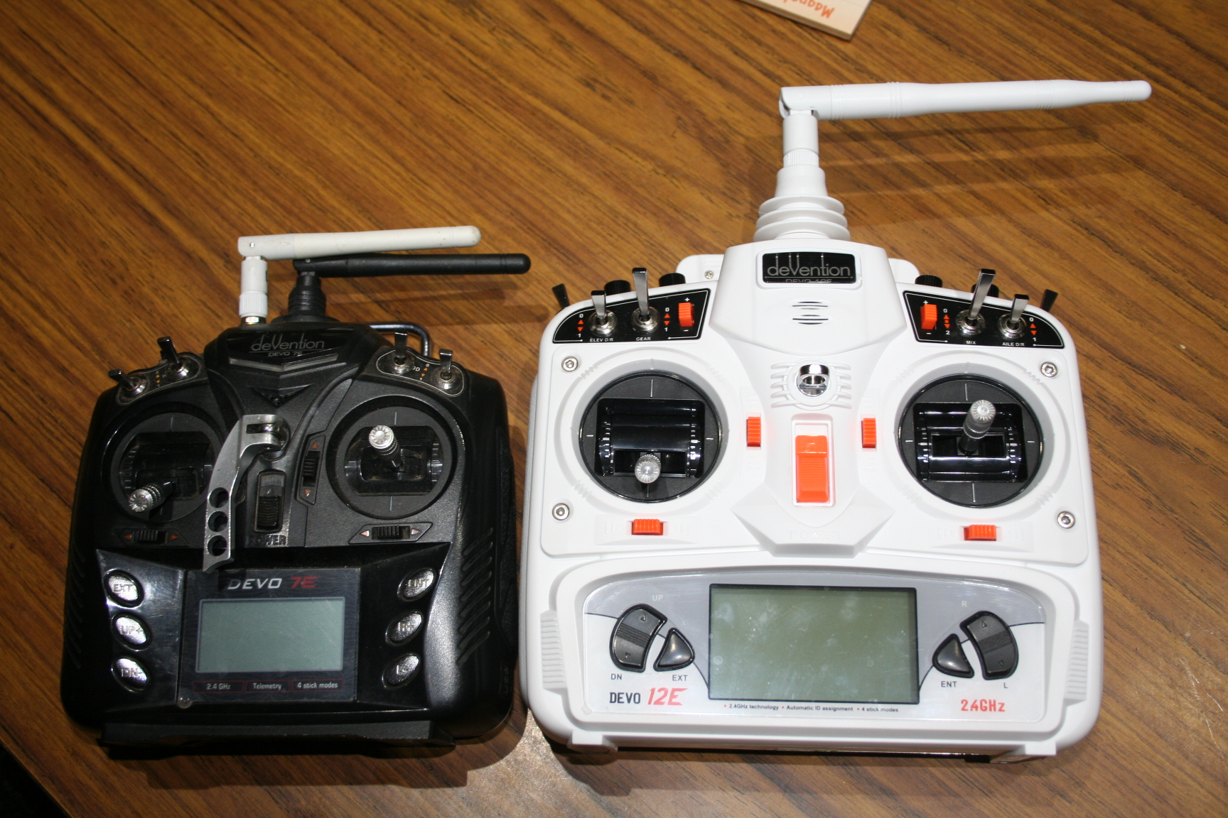

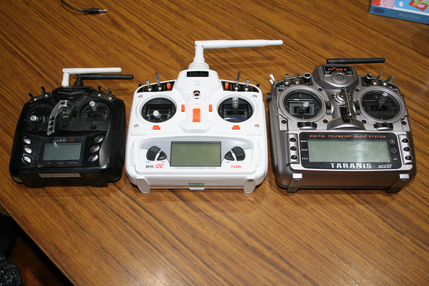

The Devo 12e is fairly big (and heavy) compared to a Devo 7e, see pics for comparison.
The 12e is much easier to add the 4in1 module to, just need to plug it in and solder 3 wires. The 7e on the other hand requires a fair bit of work to fit the 4in1.
This is the recommended 4in1 for the Devo transmitters
www.banggood.com/CC2500-NRF24L01-A7105-C...itter-p-1096707.html
