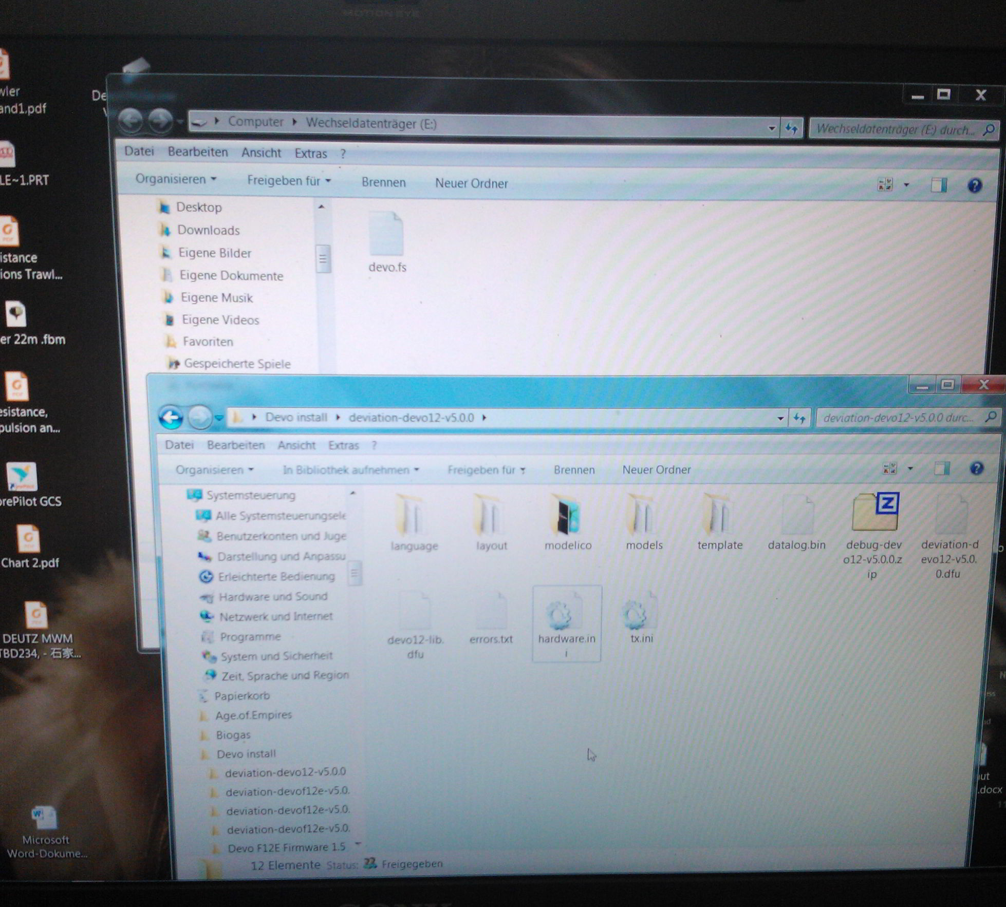

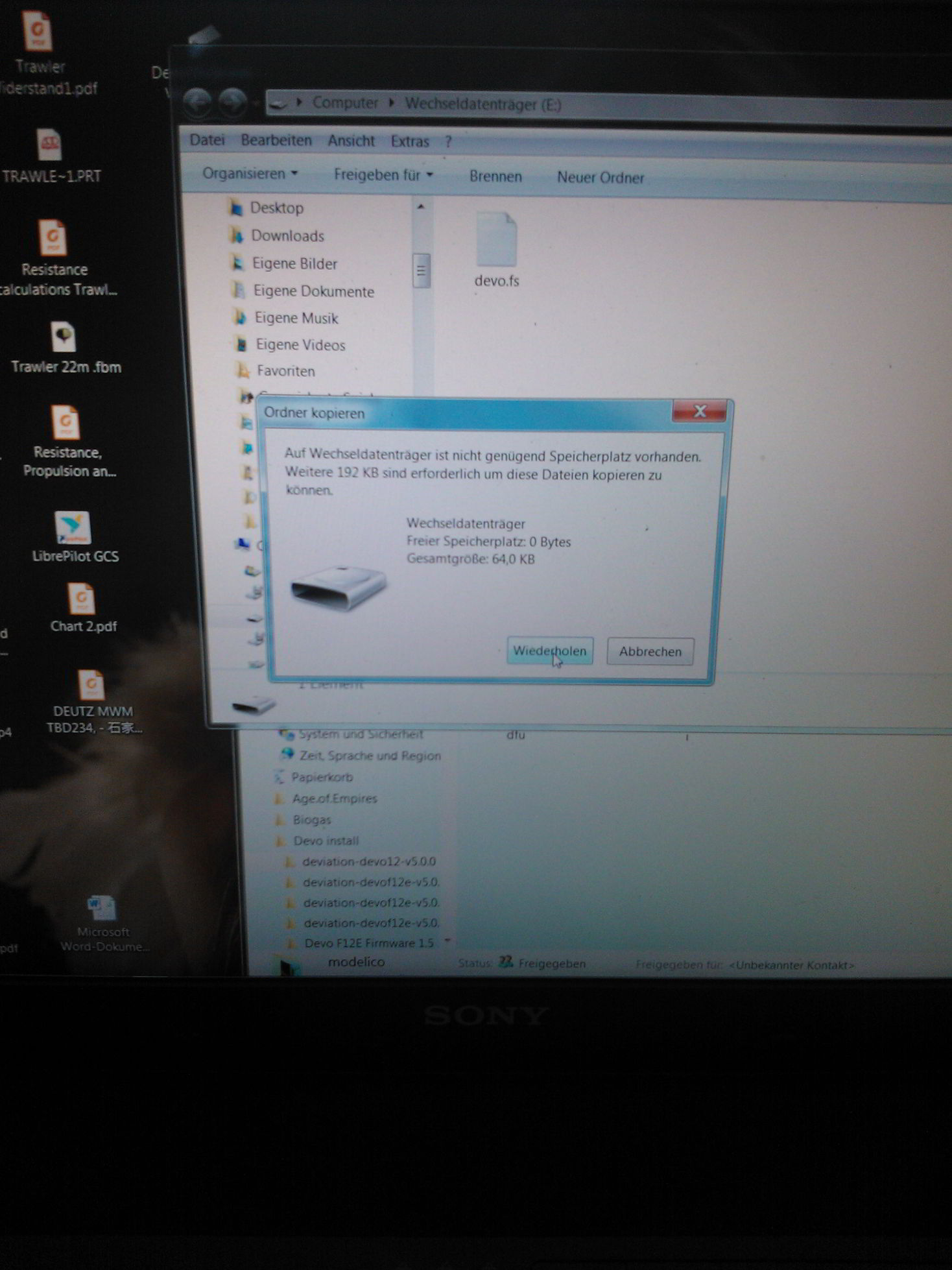

When I attempted to copy the files included in the "deviation-devo12-v5.0.0.zip" folder Windows told me the size is too big for target drive.

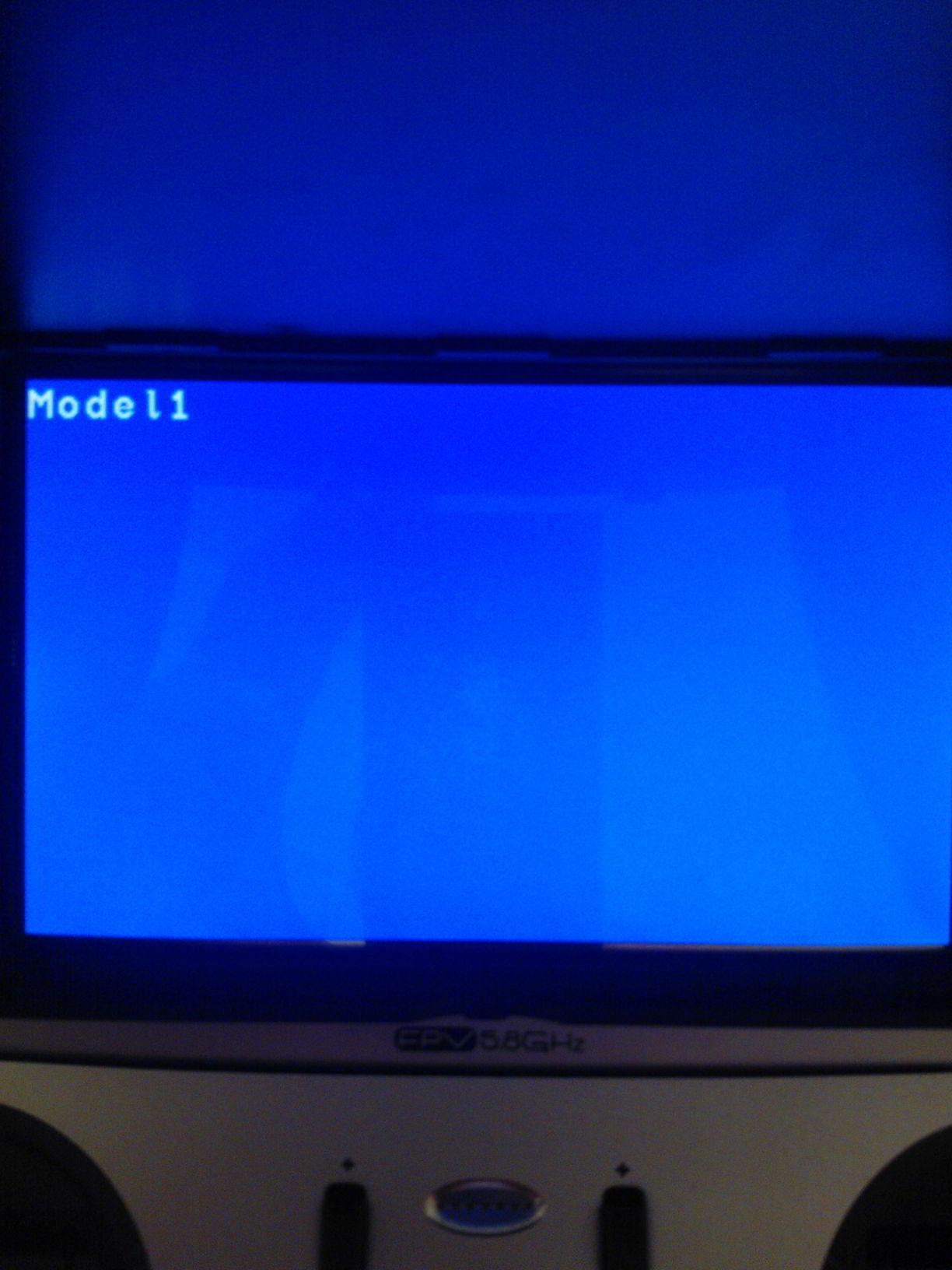

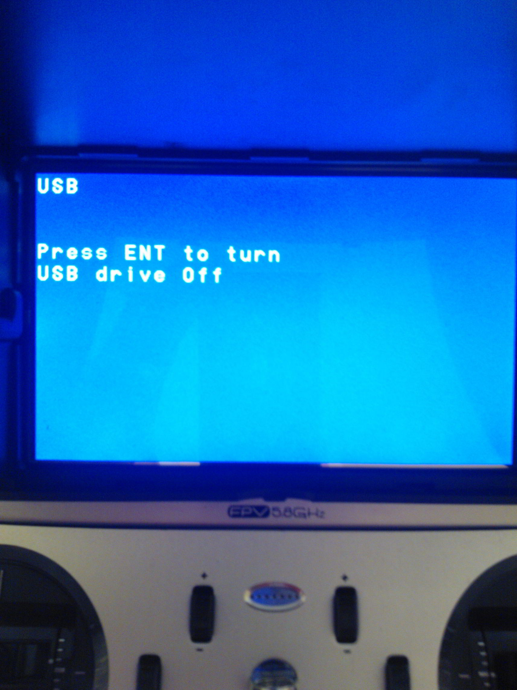

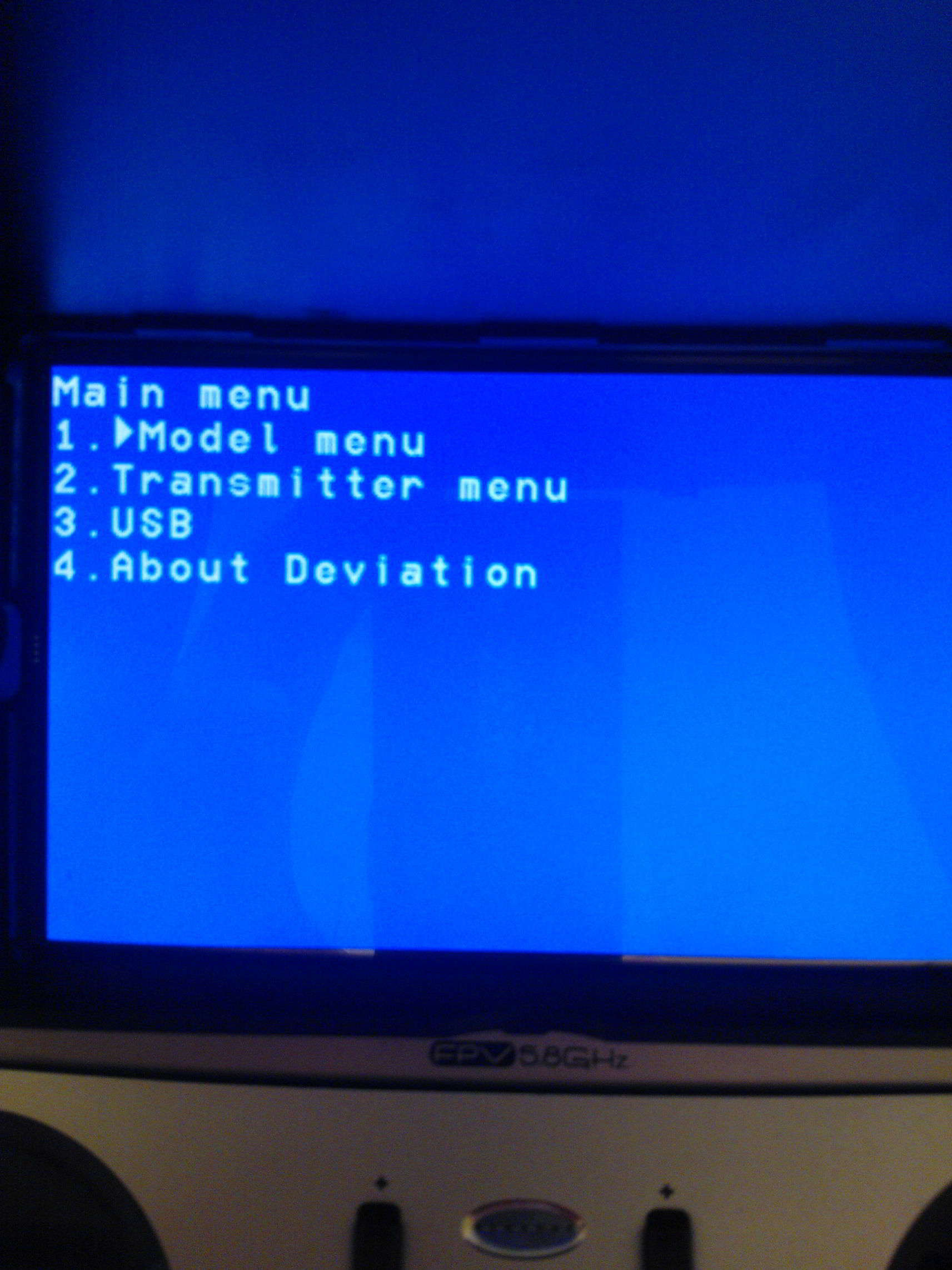

Pictures show
prompt on startup
main menu after pressing ENT
Usb does function
trying to copy to drive E which is the tx
error message in WIN 7 "not enough space"
Thanks again for your kind assistance
Richard
Pictures show
prompt on startup
Usb does function
Richard

The F series transmitters have very small flash drives in them compared to the older (6/7E/8/10/12) transmitters. That's the only problem with the transmitter, but it means that you HAVE to use the deviation uploader to copy files to it. Windows and deviation use different file systems. If you format the drive with the uploader so deviation can use it, windows won't be able to read the disk, and if you format it with Windows deviation won't be able to read the disk.
The only place the current set of instructions say to search for a file with the "..." is at step 7 to find the zip file you downloaded. If you're having trouble finding that zip file, then your issue is Windows and I can't really help with that. The files inside that should be copied to the transmitter (both flashing the DFU and installing the model files & etc.) by the uploader in step 9 if you set things up to do so in step 8.
And yes, the deviation uploader and the dfuse tool use different drivers.
