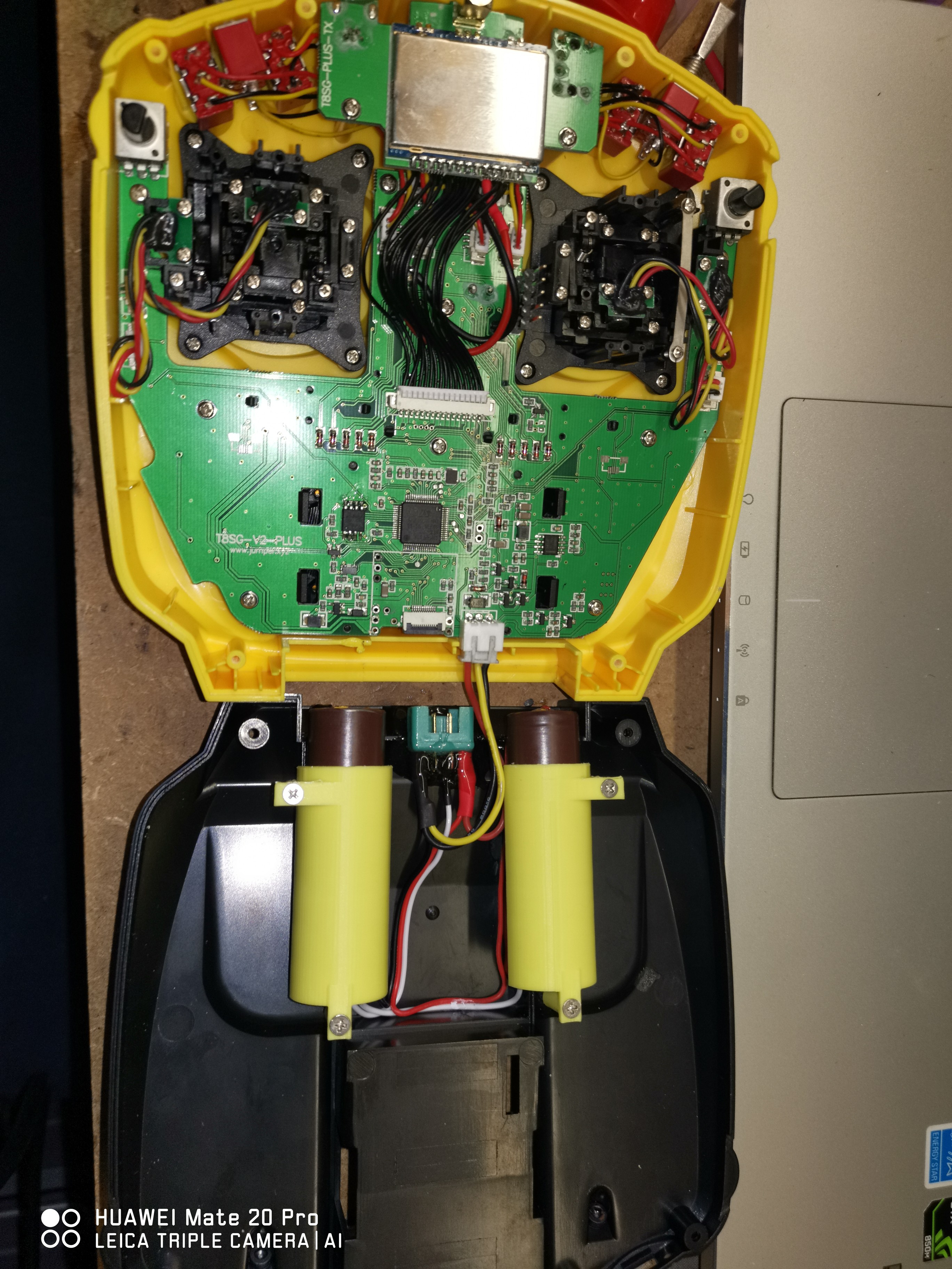

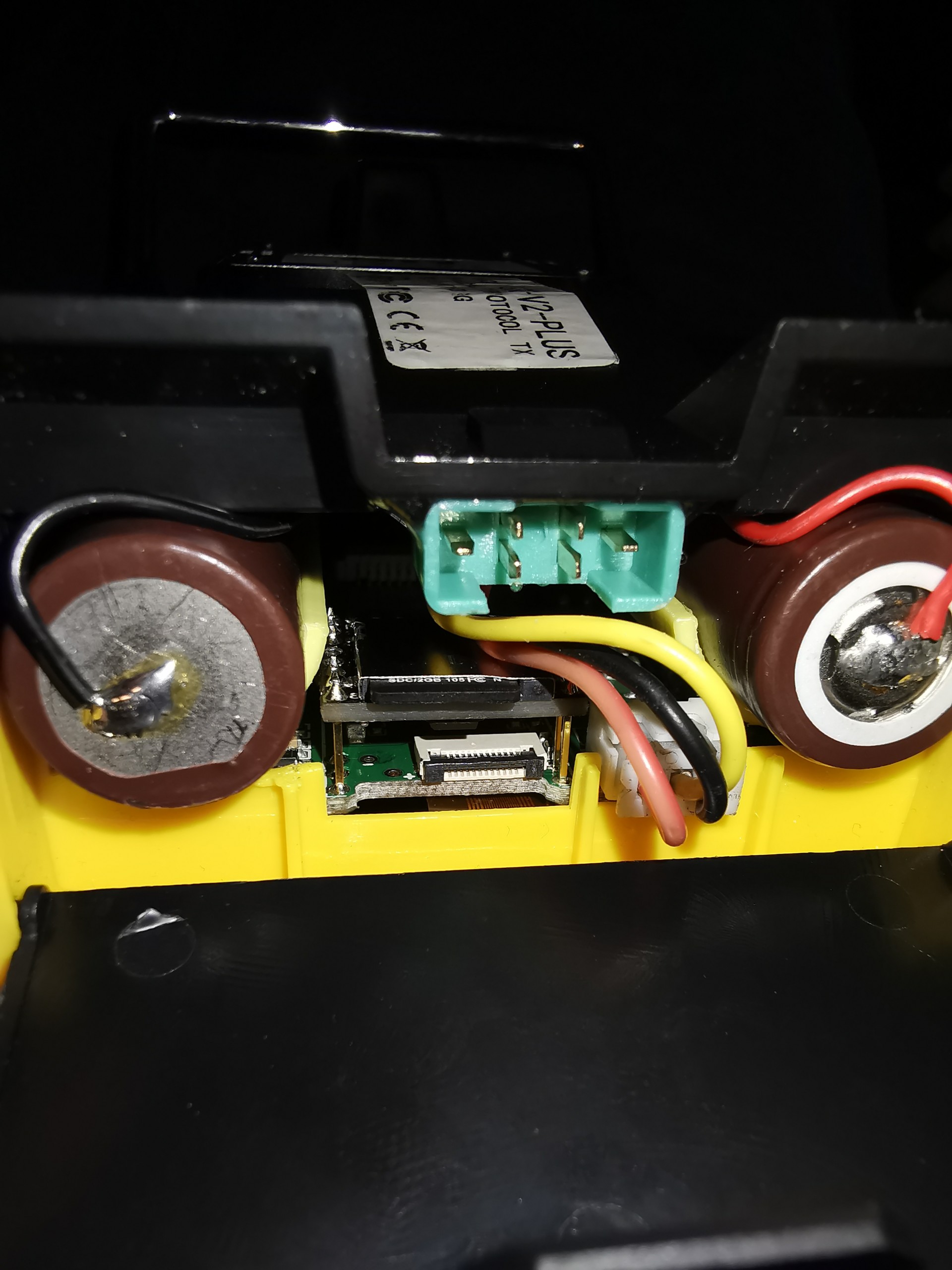

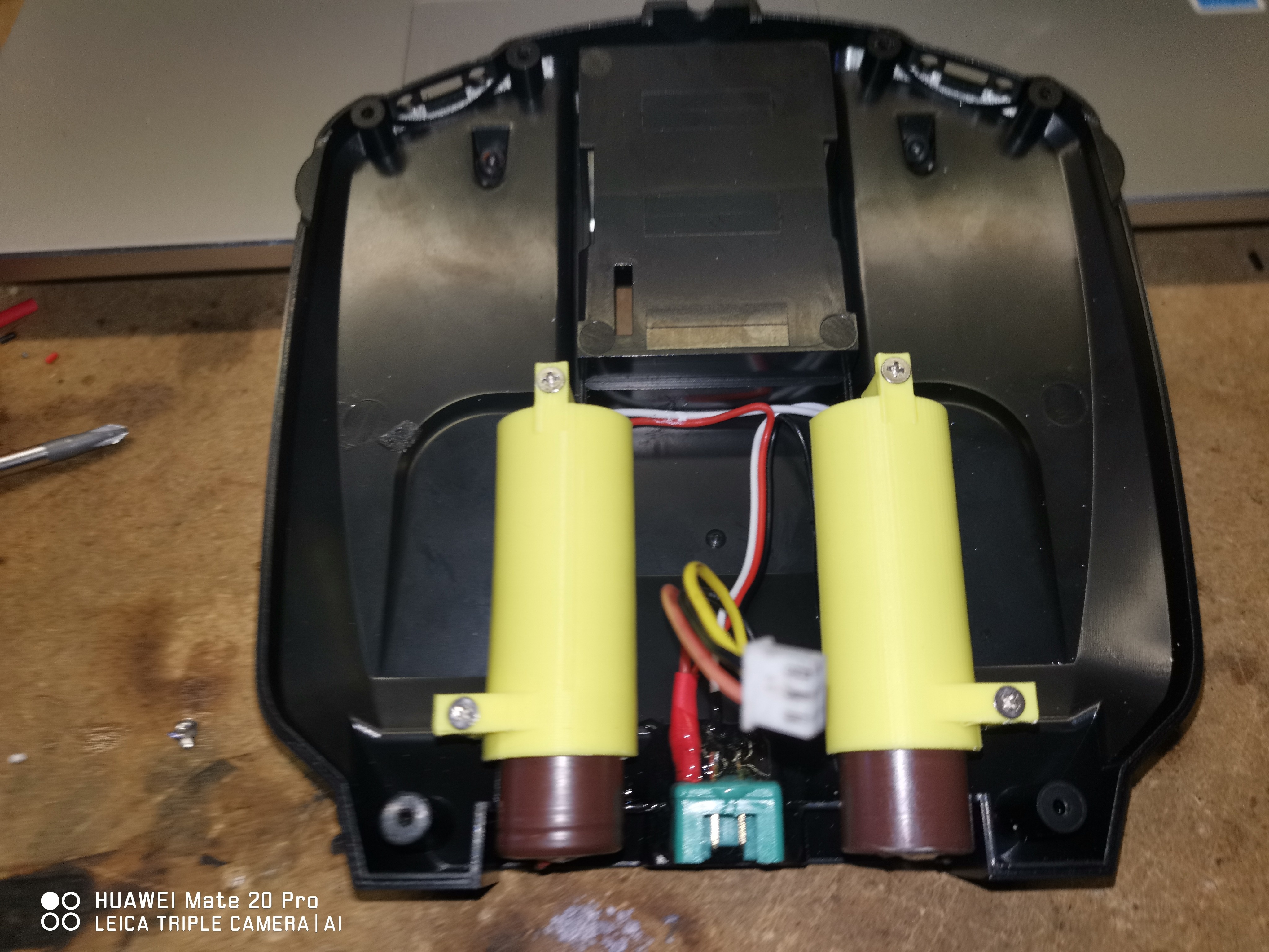

    This is my 18650 mod.
    Use 2 LG 18650 HG2 Battery's
    Printed a Battery holder for left and right side.
    MPX plug for charging and balance.

    scheich wrote: Use 2 LG 18650 HG2 Battery's
    Would this work with dfplayer installed? :whistle:

    03 Mar 2019 12:56 - 03 Mar 2019 12:58 #73150 by scheich
    Replied by scheich on topic Jumper T8SG V2 plus transmitter
    Yes, dfplayer is inside.
    Last edit: 03 Mar 2019 12:58 by scheich.
    03 Mar 2019 13:11 #73151 by Rjx
    Replied by Rjx on topic Jumper T8SG V2 plus transmitter
    scheich wrote: Yes, dfplayer is inside.
    Looks promising :)
    Maybe 18650 would do. And that 3D print. Mind sharing the STL file?
