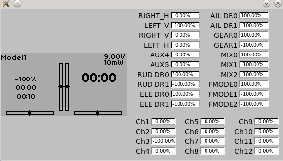

05 Jan 2014 22:39 #18025 by HappyHarry
Replied by HappyHarry on topic Devo 10/7E small UI (work in progress)
i've had a play about with your ini file in the emu and it all looks good to me, the only thing i noticed is that on the model config page some of the protocols have a rounded box and some of them have a square box,
NONE - Sq
DEVO - Rnd
WK2801 - Sq
WK2601 - Rnd
WK2401 - Sq
DSM2 - Rnd
DSMX - Rnd
J6Pro - Sq
FlySky - Sq
Hubsan4 - Sq
Skyartec - Sq
V202 - Sq
SLT - Sq
Hisky -Sq
YD717 - Sq
PPM - Rnd
USBHID - Sq
05 Jan 2014 23:33 #18030 by PhracturedBlue
Replied by PhracturedBlue on topic Devo 10/7E small UI (work in progress)
This is on purpose. rounded means you can press it because there are additional options to set

28 Jan 2014 07:36 - 28 Jan 2014 07:49 #19321 by sbstnp
Replied by sbstnp on topic Devo 10/7E small UI (work in progress)
Ok, tested some more, no glaring issues popped up. Need to test with the 7E emulator now.
Can someone help with building the devo10 emu for Windows? Just to get more exposure for testing.
Edit1:
Should the main page config be available for the 7E? It pops up in the emu and it's missing the header.
Edit2:
Fixed the overpainting issues in std mixer, can't find anymore issues.

28 Jan 2014 14:41 - 28 Jan 2014 14:42 #19326 by PhracturedBlue
The main page config should be in the 7e, just not the layout page. I'll pull it and take a look.

28 Jan 2014 15:11 - 28 Jan 2014 15:11 #19328 by sbstnp
PhracturedBlue wrote: The main page config should be in the 7e, just not the layout page. I'll pull it and take a look.
Yeah it's just the config, layout can't be edited. Still, missing the header I'll take a look at my sources just to check if it's something I've done.

28 Jan 2014 16:03 - 28 Jan 2014 17:07 #19330 by WheresWaldo
Replied by WheresWaldo on topic Devo 10/7E small UI (work in progress)
Sebastian,
Now that I am at my shop, I can build the D10 emulator and test this build. Will report back later depending on how busy the shop is today.
Here is what I see so far, using small config.ini:
  1. Channel output screen actual value appears to be 1 pixel too high.
  2. On telemetry screen 1 since we are using boxes around values is there a way to space each line out by 1 pixel at the top. It will provide separation for the values.
  3. Has there been more thought on changing the GPS screen, there is more room and it shouldn't be three separate screens as it takes too long to see all the info.
  4. When you change languages the selections do not have accented characters, is this a limitation of 04b03.fon?
  5. Is the simple GUI disabled?
To make the big-box look like a bigger version of the small-box I changed the font to 5x7. There is an error in the comment of the config.ini, there is no seven font it is 5x7.fon.
