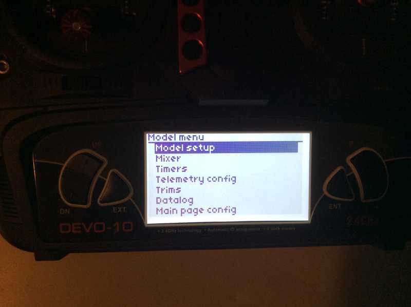

Today I flashed the tryout on my Devo 10 and to be honest it's very usable and feels just right.

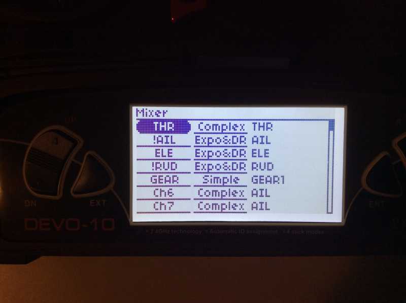

Sebastian, I built your emulator for Devo10 this morning, and I have a suggestion on the Telemetry screen. With the small font it is very hard to read the data quickly when each one is surrounded by a box. If you could eliminate the boxes when the data received is valid it would make it much more clear and cleaner also.

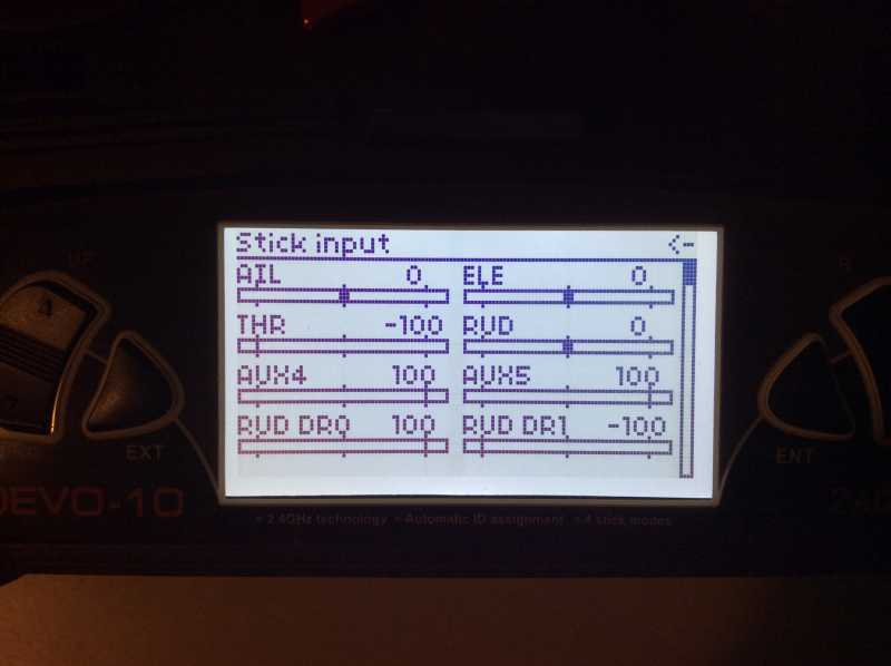

It is EMULATOR QUALITY so don't flash it on your TX yet. I'm still not happy about some things and there are a few graphic glitches here and there. I will iron everything out next few days. (I'm running it on my Devo 10 but I'm suicidal :D)
I got rid of a few things in the process like section headers in tx configuration, revert button in channel limits/properties pages. I would get rid of numbered menu items and stretch selected item over the whole available display width, but I have no idea if people would like that (I certainly do).
The mixer page looks different now, once channel per row, source shown and no switches displayed. I like it better this way (more lines), but can go back if people request it. There are some changes in label.c, so text will not start at line zero when box_h > text_h (done so it looks better in some places -- not tested enough).
I need to work some on the telemetry page in order to have it optimally displayed when using small font (it works now but space is wasted when on small font). Also toying with the idea of a tab control which would make life easier in some places (don't know if 7E will accomodate an increase in size though).
Attached are 2 config.ini files, basically replacing one or the other will switch the UI from normal to small and othewise.
Edit: standard mixer is not yet not, I have that planned for tomorrow.

WheresWaldo wrote: Sebastian, I built your emulator for Devo10 this morning, and I have a suggestion on the Telemetry screen. With the small font it is very hard to read the data quickly when each one is surrounded by a box. If you could eliminate the boxes when the data received is valid it would make it much more clear and cleaner also.
I certainly thought about that and I almost did this. TBH boxes have no place on such a low res screen, but let's wait on what PB has to say it's his call.
