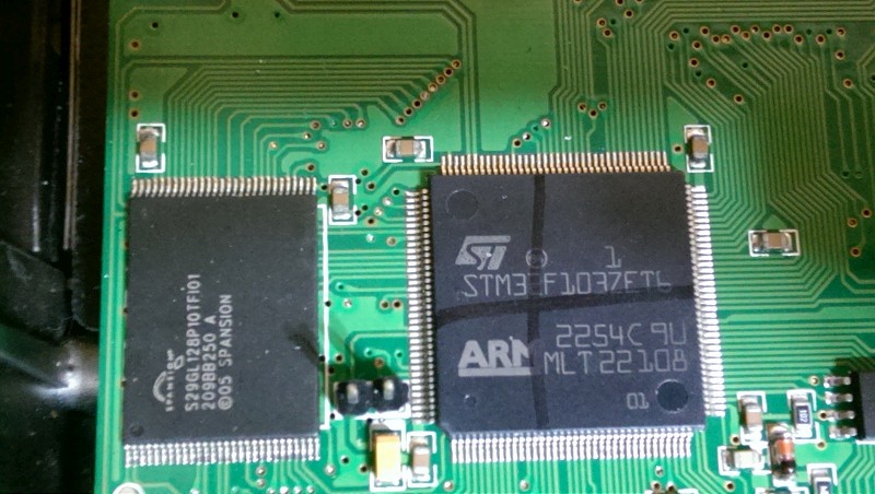

I have a devo 12s and i would like to make this modification by adding a 3in1 module
But i don't find schema for soldering module 3 in 1 in my devo 12s
So, somebody have soldering schema for a devo 12s please ?
Maybe the soldering is the same on devo 12s and devo 10 ?

sv650s wrote: ... I have a demo 12s and i would like to make this modification by adding a 3in1 module
Maybe the soldering is the same on deco 12s and deco 10 ? ...
Yes, much the same as the Devo10. The 3-in-1 module has 12 pins that are labeled on the backside of the module. To install, we connect only 8 of those pins: Gnd, VCC, Miso, Mosi, SCK, CS2401, CS2500, & CS7105. The remaining 4 pins are not connected to anything.
This linked page in the Wiki describes the connections for installing the multi-module in the Devo8, 10 & 12, but is relevant for the 3-in-1 module as well. Pay attention to the photos. The text is only partially useful, since it describes a different module.
You can do the installation by soldering to the connection points or by wire-wrapping to pins, your choice. You would need to solder a pin header in the debug pads to do this.
With the Devo12, there is one issue remaining to be resolved: where to connect the third module. On the Devo10, there exist a couple of pads near the debug pads, described as B6 and B7, which can be successfully used for that purpose, but no one that I know of has mentioned a location on the Devo12 that will serve as well. Maybe someone with more knowledge can help identify a pad that can be used.

05 Sep 2016 05:23 - 05 Sep 2016 05:26 #53488 by vlad_vy
Replied by vlad_vy on topic 3in1 / 4in1 RF module
At page 7 of this topic there is example how to solder third wire to MCU pin for Devo8 (port B3). I think this is the same case for Devo 12. At least, port (B3) unused for Devo12.
www.deviationtx.com/forum/7-development/...dule?start=120#44256

05 Sep 2016 14:17 - 05 Sep 2016 15:45 #53513 by sv650s
Replied by sv650s on topic 3in1 / 4in1 RF module
On devo 12s there is not this mcu on the board...
So i don't know where connect the third module...
Somebody can help me please ?
Last edit: 05 Sep 2016 15:45 by sv650s.
05 Sep 2016 15:38 - 05 Sep 2016 15:39 #53517 by sv650s
If i understand well the MCU of devo 12S is an STM32F103ZE, somebody can confirm ?
I've found schema of MCU of devo 12s
www.waveshare.net/photo/ic/STM32F103ZE_l.jpg
Normaly, i must solder :
A7105 on TMS should be connected on board to PA13 of MCU pin 105
CC2500 on TCK should be connected on board to PA14 of MCU pin 109
NRF24L01 should be soldered on PB7 of MCU pin 137 OR PB12 OF MCU pin 73
If somebody can confirm or not ?
Last edit: 05 Sep 2016 15:39 by sv650s.
05 Sep 2016 16:10 - 12 Sep 2016 15:53 #53518 by vlad_vy
Devo 12s has two easy accessible pads for third wire, A1 and B3, both unused.
I use A1 pad and it works (module 4in1).
[modules]
; enable-cyrf6936 = B12
; has_pa-cyrf6936 = 1
enable-a7105 = A13
has_pa-a7105 = 1
enable-cc2500 = A14
has_pa-cc2500 = 1
enable-nrf24l01 = A1
has_pa-nrf24l01 = 1
; enable-multimod = A13
P.S. Now I use B3 pad and it works also (module 4in1).

05 Sep 2016 16:15 - 05 Sep 2016 16:17 #53519 by dat
Replied by dat on topic 3in1 / 4in1 RF module
i take a pic from my 12s mcu , wish this can help
Last edit: 05 Sep 2016 16:17 by dat.
