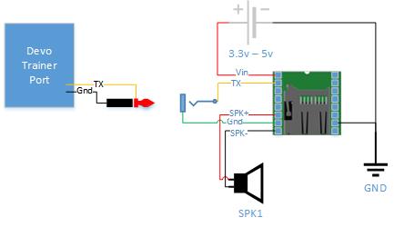

Replied by sbstnp on topic Voice alerts test build
Hi, can anyone show me how they wired up the dfplayer mini in their Devo 10? I'm interested in how did you power it up.

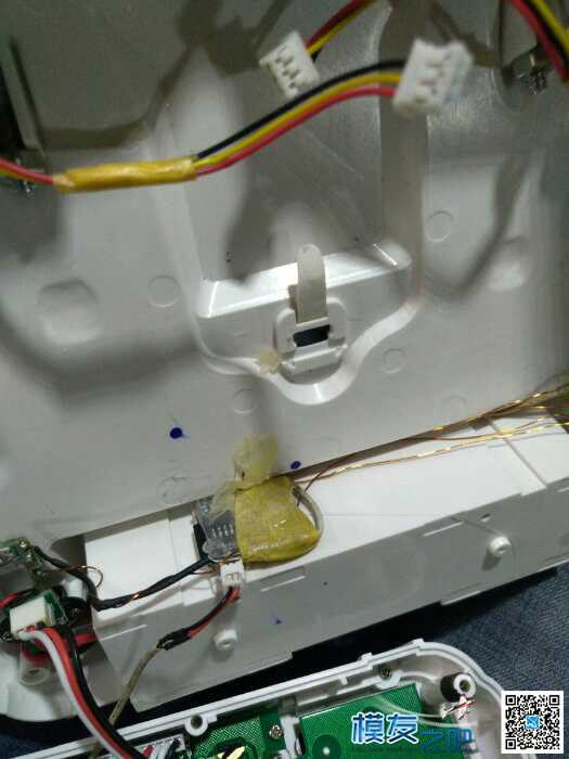

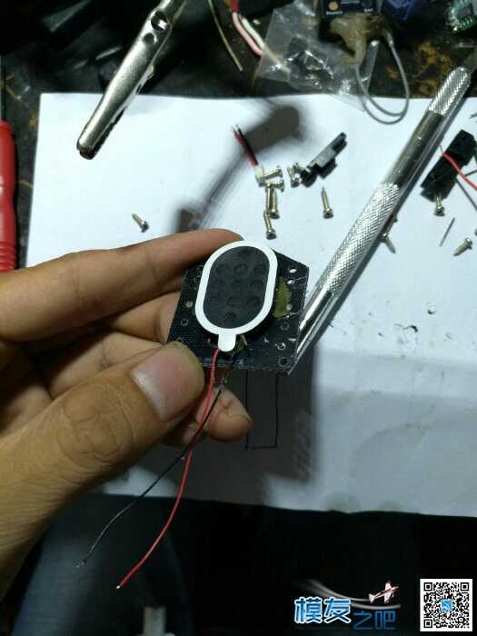

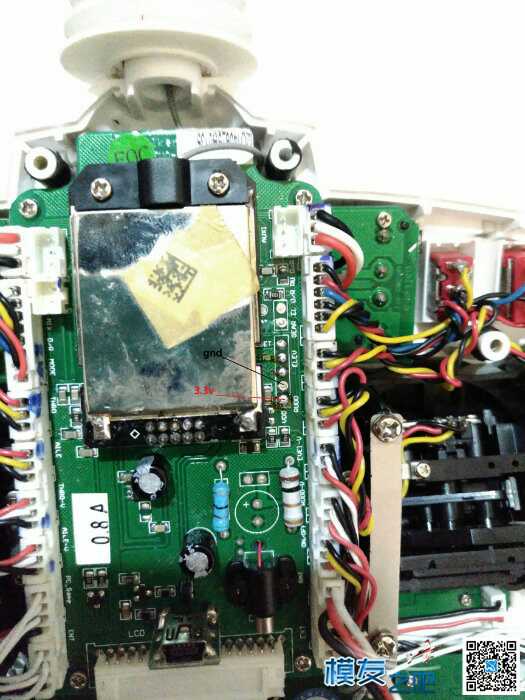

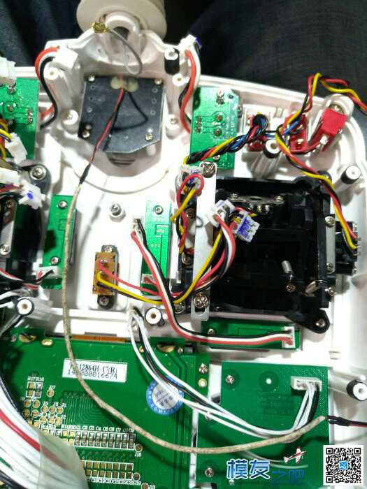

Replied by 52dgj on topic Voice alerts test build
This is my installation method,dfplayer mini Power supply is 3.3~5v。I hope that my bad English can help you.

by sbstnp
Thank you, appreciate it. Are you happy with powering it up from 3.3V? (your English is fine btw)
Edit: poked around and looks like I can hook it up to battery voltage and use a step down. I'll give that a go and if I'm happy I'll add it to the wiki.
Translation software I use,(⁄ ⁄•⁄ω⁄•⁄ ⁄),3.3v works very well.
