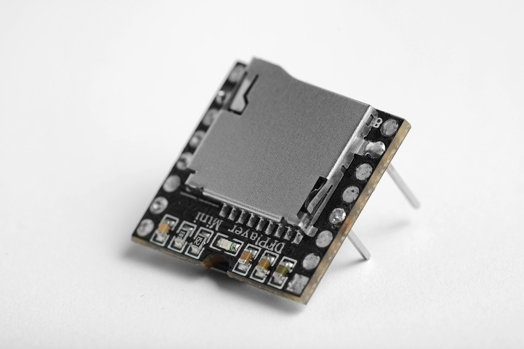

Can't get my U7E to work with dfplayer. The dfplayer it self is working when I pres keys. It does not work over DSC port, external port currently not available in the model voice alert.
What am I doing wrong?

15 Mar 2018 18:49 - 02 Sep 2022 08:23 #68102
by Remlen
Replied by Remlen on topic Voice alerts test build
Last edit: 02 Sep 2022 08:23 by Remlen. Reason: photo

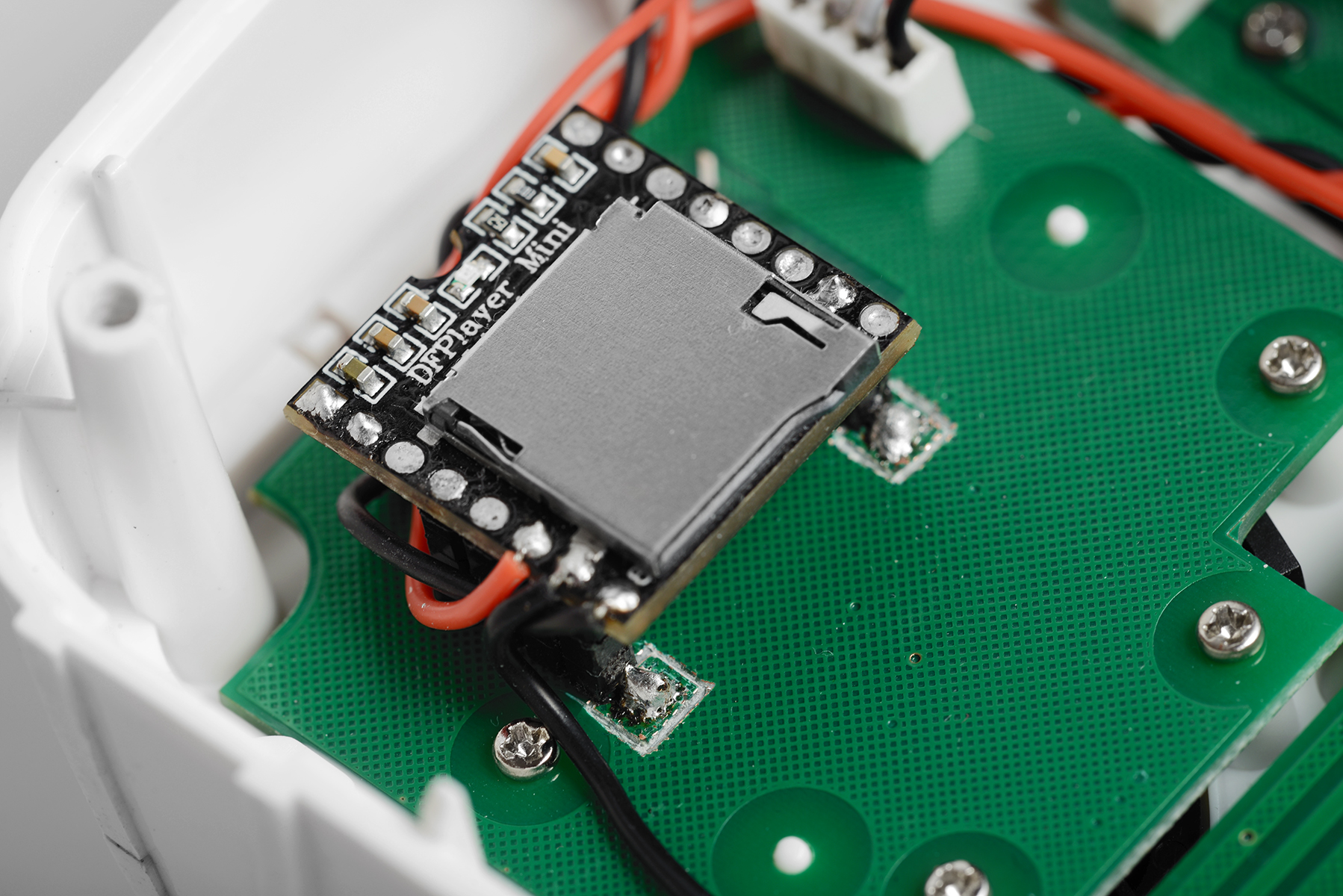

- Remlen
- Posts: 4
15 Mar 2018 18:50 - 02 Sep 2022 08:24 #68103
by Remlen
Last edit: 02 Sep 2022 08:24 by Remlen. Reason: photo
