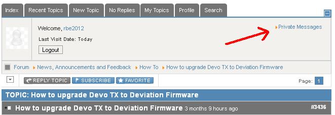

I'm sorry but I'm a little new at this forum stuff, except reading, and gleaning info. I don't know how to retrieve a or send a PM.
02 Mar 2013 06:39 #7214
Replied by rbe2012 on topic How to upgrade Devo TX to Deviation Firmware
