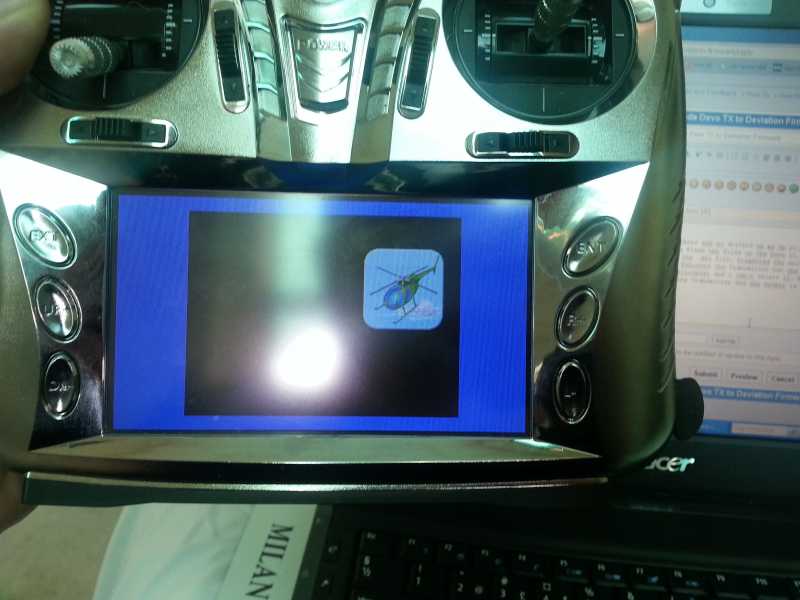

01 May 2013 09:15 #9440
by Morten
Replied by Morten on topic How to upgrade Devo TX to Deviation Firmware
Hi guyes.
I have a Devo 12, and i want to switch to Deviation 3.0 but i have some problems dooing that.
Ive tried on tree different computers with totally differen problems.
1 pc: Win 7 64 bit. Defuse (1.7 and 1.5 )installed but chrased every time i start it.
2 pc: Win xp 32 bit. Defuse (1.7 and 1.5 and 1.4) installed but when I start the transmitter in update mode it dosen't show up at the bottom of the defuse window. When i go to device mannager it shows there is no driver installed. I search the net for a driver but with no luck.
3 pc: Win 7 64 bit. Defuse 1.7 and 1.5 installed but chrased every time i start it. Installed Defuse 1.4 and suddently it dosent chrash yeah!! - I start the transmitter in update mode (trn switch and power button) it shows up at the bottom of the defuse window Yes!! But it dosent work when i try upgrading, and i get a error message.. Damn... Then i discover it dosent show up in the Available dfu devices at the top left corner of the defuse window. Im starting to get desperate now
, what do i have to do? Please help me witch of the 3 pc should i use and what have i missed since i cant get it to work?

01 May 2013 10:11 #9442
Replied by vlad_vy on topic How to upgrade Devo TX to Deviation Firmware
With Win Xp 32 bit I havn't any problems. But you can find driver at: C:\Program Files\devention Upgrade Tools\Driver\

- Morten
02 May 2013 11:08 #9477
by Morten
Thanks guyes!!
It turned out there was no drivers on my Xp pc, so i copied them from the win 7 pc an now i can flash the files on the Devo 12... Yes!!
I flashed both the .dfu file, formatted the drive, copied the files in the file system folder. Rebooted the Transmitter but the only thing on the screen is one icon with at helicopter and i can't select it. What did i do wrong? Right now i hav a non working transmitter and the wether is great for flying here in Denmark.
02 May 2013 11:42 #9478
You need also flash library file devo12-lib.dfu (located in filesystem archive), at Library tab of Defuse.
- Morten
02 May 2013 13:20 #9479
by Morten
Thanks a lot Vlad now it works perfektly!!
