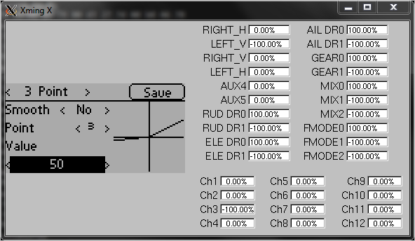

29 Jun 2013 16:17 - 29 Jun 2013 16:24 #11573
by sbstnp
Pitch is usually on channel 6 and has a source of THR.
So you understand, every channel can either have a source or a fixed value. Source can be another channel, or hardware inputs.
This is a quick summary of the sources you can have:
a) Sticks:
AIL
ELE
THR
RUD
b) Switches:
AIL DR0,1,2
ELE DR0,1,2
FMODE0,1,2
etc
c) Channels:
Ch1 - ChX
Virt1 - VirtX
On a heli pitch is controlled by the THR stick. Position of said switch can be 1-to-1 value (like -100 to 100) or it can be mapped on a curve.
Most of the time, you create a curve, the simplest being a 3 point: -10, 0, 50 for example, and use it. Lowest position of the THR stick the maps to -10 and highest to 50.
Keep in mind these values are just pulled out of my a$$ and most likely they are not optimal.
