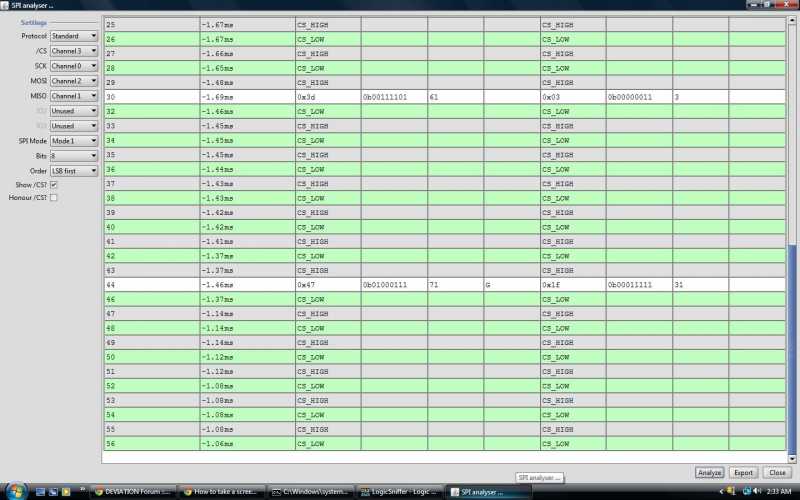

04 Nov 2013 15:42 - 04 Nov 2013 15:43 #15333
by Birdman
This is what i have captured and analyzed with bus pirate, first attempt.
Will have to find out what spi filter is.
Trace is of rx after binding to tx, no sticks moving.
Bm
Replied by Birdman on topic Corona
victzh wrote: What is this? If you want us to analyze this, say so. If so, can you at least pass it through SPI filter so that the messages would be more sensible, and provide annotations about the circumstances: what did you trace - receiver or transmitter - is it from the very beginning or in the middle of the session, was it bound or not etc. etc.
Bm

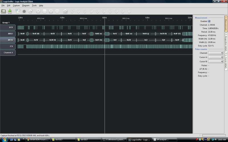

04 Nov 2013 17:54 #15344
by victzh
Replied by victzh on topic Corona
To trace a protocol you need a bit larger span. And something is not working in your connection with the device. Do you have graphical view, something like this:
dumb.ro/lafront/screenshot1.png
and can you verify that what you see resembles SPI - CSN goes down and up, SCK is active while CSN is down, the SPI decoder decodes it.

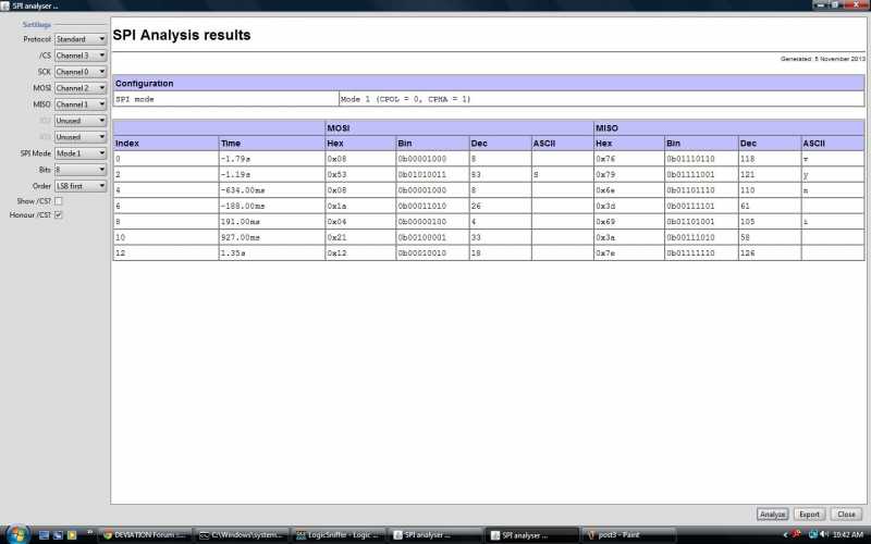

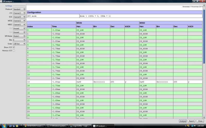

04 Nov 2013 23:06 - 04 Nov 2013 23:34 #15350
by Birdman
This trace is of rx powering up.
BP -> CC2500
MOSI -> pin20 SI
CLK -> pin1 SCLK
MISO -> pin2 SO
CS -> pin7 CSn
Are the grey lines in analysis errors?
They should be green white green white....?
BP -> CC2500
MOSI -> pin20 SI
CLK -> pin1 SCLK
MISO -> pin2 SO
CS -> pin7 CSn

05 Nov 2013 17:31 #15361
by victzh
The forum software reduces the pictures so I can not see clearly. The former one is too zoomed out to tell anything.
You should consult CC2500 datasheet, www.ti.com/lit/ds/swrs040c/swrs040c.pdf to see if what you're looking at resembles actual CC2500 commands. Section 10 describes the interface and Section 32 - registers.
Can this software (I worked with OLS long time ago) save SPI decoded trace in some text format?
