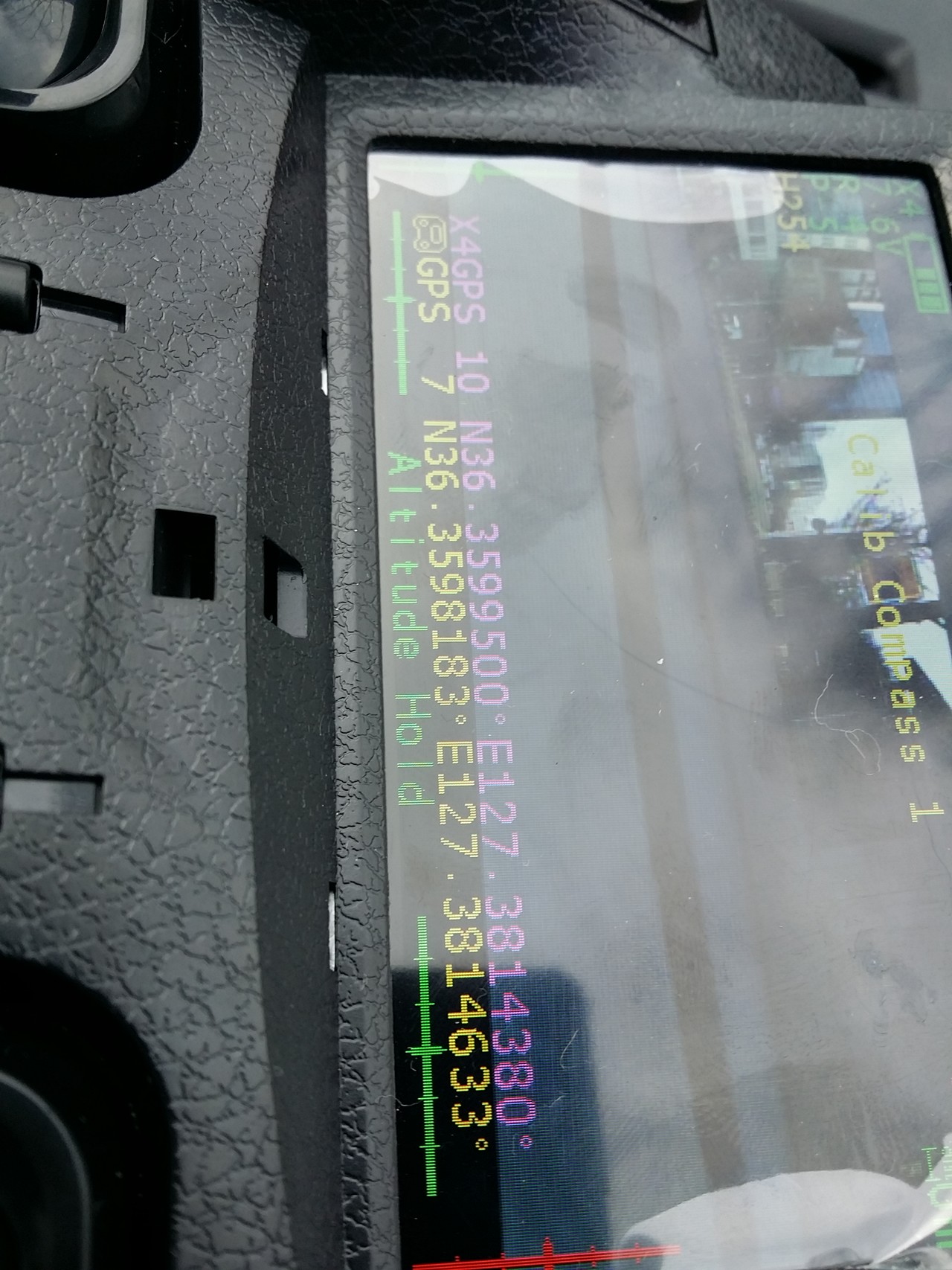

13 Jan 2016 06:39 - 13 Jan 2016 07:53 #41704
by delta75
Replied by delta75 on topic The New Hubsans
GPS Cord data
GPS1
delta75.myDS.me:5000/fbsharing/3PsQ6FNZ
GPS2
delta75.myDS.me:5000/fbsharing/rGTKCBNf
GPS3
delta75.myDS.me:5000/fbsharing/CIPibzHE
GPS4
delta75.myDS.me:5000/fbsharing/2cuQ0ARL
GPS5
delta75.myDS.me:5000/fbsharing/xeceYk3n
I'm not sure the order is correct, sorry
GPS1
GPS2
GPS3
GPS4
GPS5
Last edit: 13 Jan 2016 07:53 by delta75.
- delta75
- Posts: 51
13 Jan 2016 06:42 #41705
by delta75
telemetry
distance 0m -> 2m -> 0m
delta75.myDS.me:5000/fbsharing/Vo20ktcD
acc sensor 0m/s -> 1m/s -> 0m/s
delta75.myDS.me:5000/fbsharing/FqCZc3jm
walk 10m
delta75.myDS.me:5000/fbsharing/AHs4lGHG
alti hold -> gps hold
delta75.myDS.me:5000/fbsharing/NZEePUgy
return to home
delta75.myDS.me:5000/fbsharing/xRvPY9jl
walk 10m
return to home
