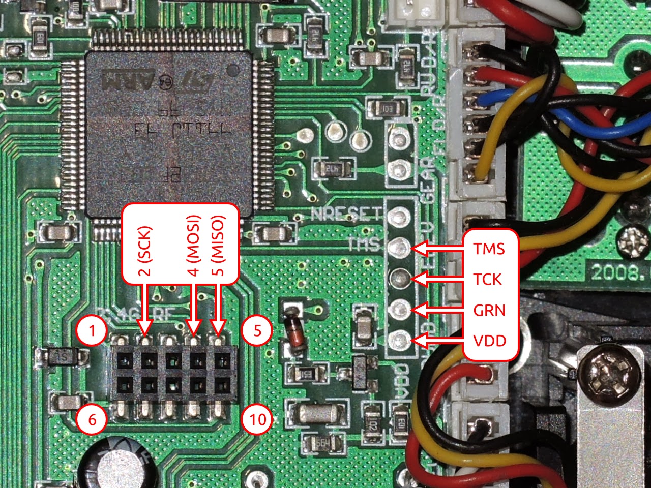

Hello, If I solder connector on trainer ports board, which pins should correspond to a nano tx? Probably it would be better to solder directly to the 4 pin connector... I don't use trainer port. anyway. Here's what I found as a reference, I think devo 7e is the same.
Attachment not found
edit: I made a 3.5mm connector, as it is already mentioned earlier by Hexfet, crsf serial port goes to the tip and middle ring(together), ground goes to bottom ring. At first glance, everything works fine, And maybe I've missed something, but I haven't seen an option for receivers setting in edge tx! My devo is 7e 256. Is it really possible to achieve the high baud rate? I know redpine is faster on devo, could it be the same case with Elrs too??

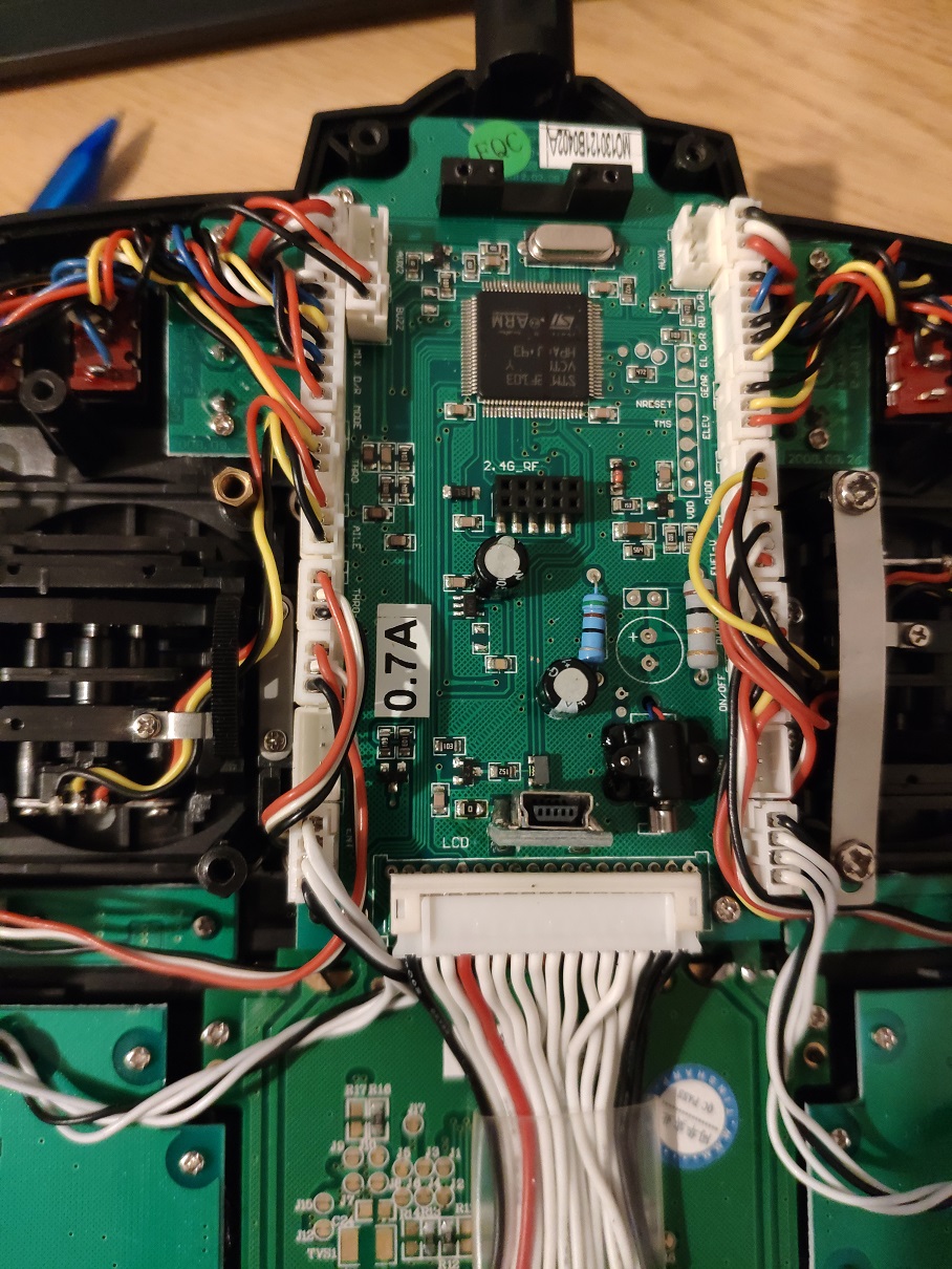

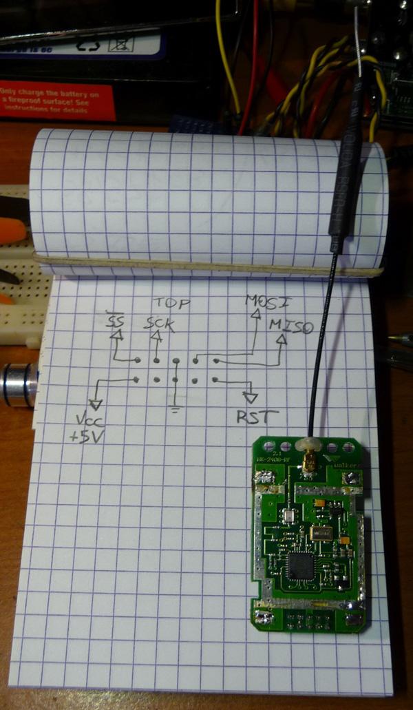

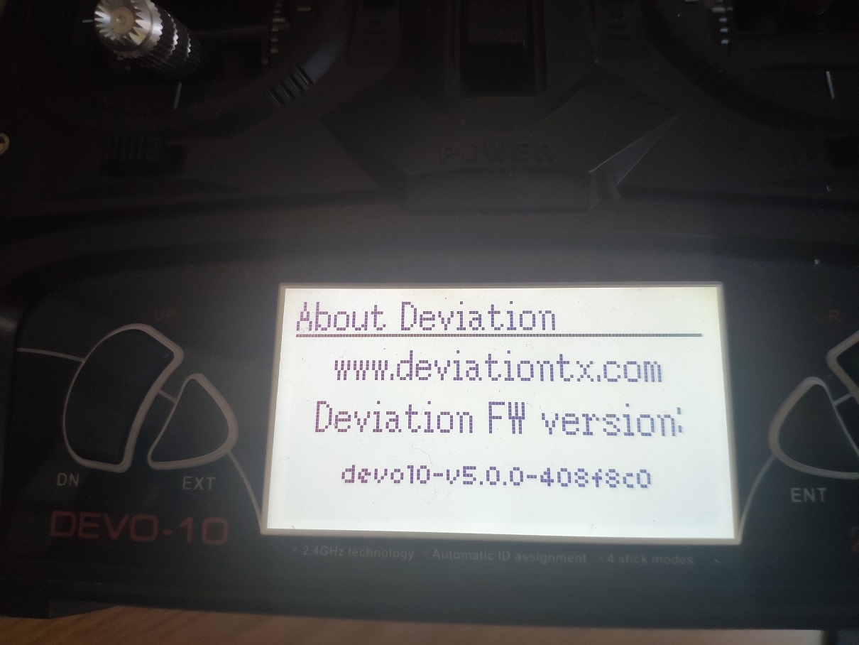

19 Jan 2024 23:20 - 19 Jan 2024 23:24 #78360 by MFLY
Replied by MFLY on topic expressLRS
Hi all,
wanted to give ashort update.
The update onto "devo10-v5.0.0-408f8c0" worked like a charm.

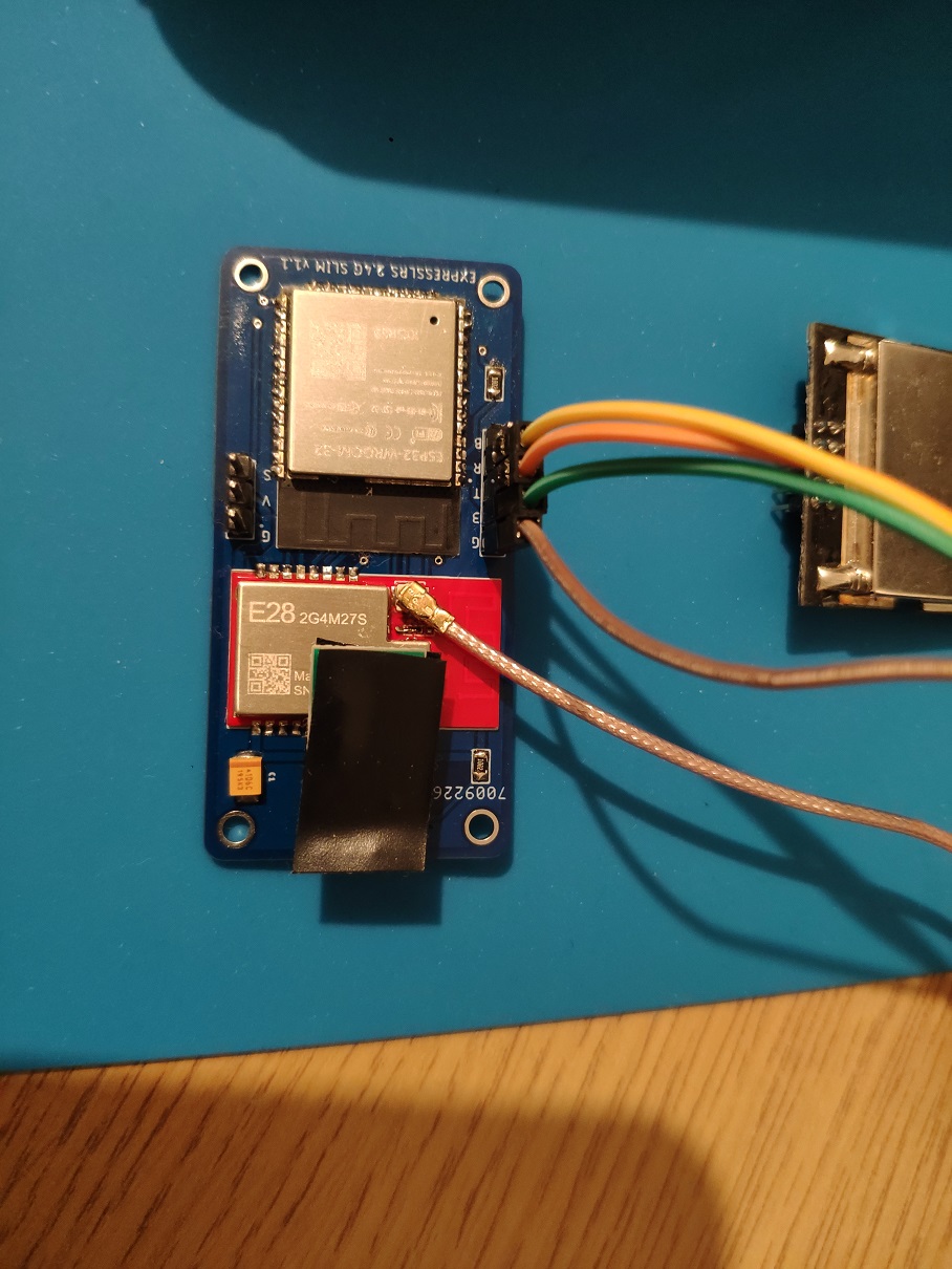

In the meantime i soldered together a DIY TX Module (based on ESP32 with E28 TX Chip) as shown in on of the photos. I flashed the current ELRS version on it Release 3.3.2. Is it required to downgrade it?
I wanted to replace the old module with the ELRS DIY TX module. Before burning up something and to be on the safe side... where exactly do i solder up the three wires Signal, GND and V+?
I found some schema illustrating the pin-outs as well as soldering points on the board... however those were referring for the 4in1 module. Is it correct, that i can pull GRD and V+ from pin-out. Pin 6 for V+ and GRD 3 or 8? Which pin od soldering point on the board do i use for the signal cable?
Appretiate your feedback.
Thank you + BR
Martin
Last edit: 19 Jan 2024 23:24 by MFLY. Reason: additional photos

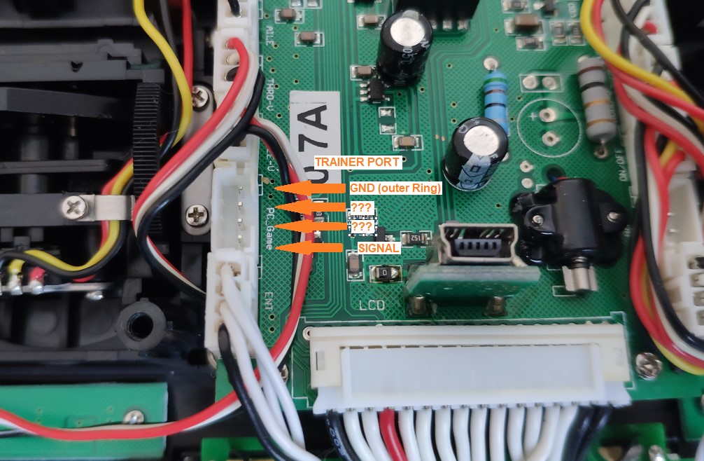

20 Jan 2024 12:46 #78361 by MFLY
Hi all,
after some additional research the signal wire seems to be connected to the Trainer Port.
Is it sufficient to use the illustrated Signal wire at the very bottom, the GND and V+ to have it working?
In the post above, it says that one of the middle wires needs to be utilized as well... (both siglan plus one of the middle wires) but which one exaclty?
Any hint is much appretiated.
Thx + BR
Martin

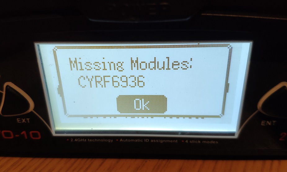

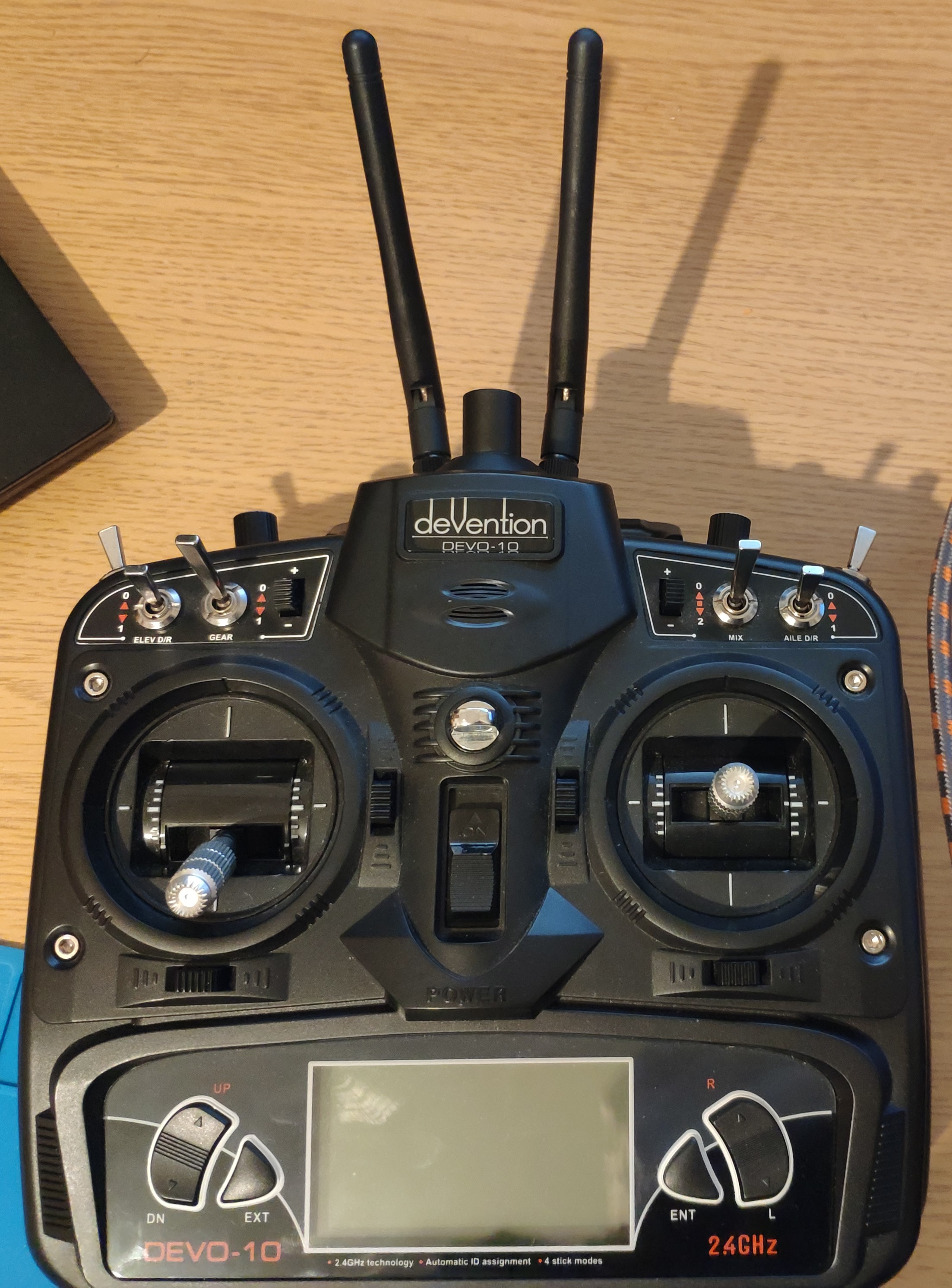

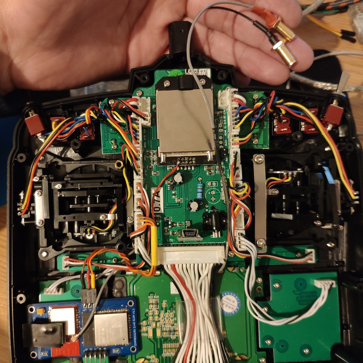

21 Jan 2024 01:44 #78362 by MFLY
Hi all,
me again. As shown in the photos, the upgrade is now finished. The wires for the ELRS TX have been pulled from the trainer/game port. GND and 2xSignal. V+ (5V) from pin 6 of the Pin-Out where the original TX module sits.
I first wanted to replace the original module with the ELRS one... but after getting "missing module" error, i came to realise, that it was also possible to operate both modules in paralel. Found a place beneath the battery bay. (make sure to isolate/cover the screw heads in order to prevent shorts). Since there were now two modules, i needed two antennas. screwed two holes on the top of the back cover and installed two antena mounting screws. I guess it looks better now, since the old antenna was pretty huge. After cutting off the "knob" of the old antenna holder, it should even look better.
Hope the sequence of the last posts helps others, who are also thinking of upgrading their radios.
BR
Martin
