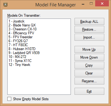

I wrote this little utility to manage the model files on my Devo 7E running DeviationTX. The program
works by searching for a removable drive that looks like a Deviation install. When it finds one
it will look at all the models and list them in the main window. From there you can manage your
model files using the buttons on the right.
Right now, it will
Just download, unzip and run the executable.
Sorry, Windows only... and you will need the .Net Framework 4.0 installed.
See this post for the cross-platform version.
Right now, it will
- Backup your models folder
- Restore one or all of your models
- Import/Convert an external model file into your models folder
- Move models up and down in the list
- Copy models
- Clear a model slot
- Rename a model

I just wanted to mention that you can assign an exe to open the modelX.ini file by editing the file...
Just change the "ModelEditor" key value setting to the path of your editing exe. For instance, I default mine to Notepad++...
Note that 1) you have to use double slashes and 2)For Win7 you may need to use 8.3 filenames.
Then all you have to do is double-click the model name.
Replied by greenfly on topic Model File Utility
Moeder wrote: ...add a model editor/creator...
ModelFileManager.exe.configJust change the "ModelEditor" key value setting to the path of your editing exe. For instance, I default mine to Notepad++...
<add key="ModelEditor" value="C:\\Program Files (x86)\\Notepad++\\notepad++.exe"/>Note that 1) you have to use double slashes and 2)For Win7 you may need to use 8.3 filenames.

Just a question: could it be that the program can not handle more than 30 model files?
I get an error and have 50 model files on my Devo 10 (yes, most of them are empty
EDIT:
Did another test with only 30 model files and no error!
So it works pretty fine with the standard settings.
EDIT2:
Handling with more than 30 files ok, but with "empty" files error.
I copied a default config to all "empty" files and everything went smooth
EDIT:
EDIT2:
Last edit: 25 Jun 2015 14:19 by robbe.
- greenfly
25 Jun 2015 14:44 #34653
by greenfly
Sorry about that. It expects for there to be a file for every model slot and that the model files are contiguous. So if you deleted any then that would cause a problem.
The program will support up to 256 models. One way to generate more model files is to "Move Down" a model down past the end of your list. The program will add an empty file to accommodate..

Just an FYI.... I have updated the utility (in the first post) with a few more features. To use, you can simply replace the old files with new ones.
One new feature can use mwm's model file conversion routine from here . If you place a copy of the "straight.exe" and "default.ini" in the same directory as the Model File Manager, you can make these changes to the config to activate the model conversion during import.
<!-- Set this to the exe that will convert a model file during import -->
<!-- Note: With no path it will assume it is in the app dir -->
<add key="ModelConverter" value="straight.exe" />
<!-- Set this to be the arguments for the above command where... -->
<!-- {0} = model file being imported -->
<!-- {1} = current model file being overwritten -->
<add key="ModelConverterArgs" value="{0} {1} -c default.ini" />- mwm
