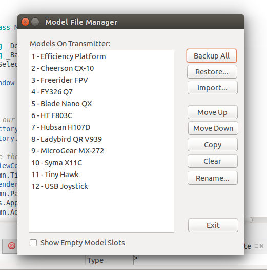

Well, I thought I would delve into the world of Mono , and it has been an interesting trip so far. Surprisingly much of the code is close to portable! The biggest hurdle is doing the GUI stuff. That affects the code drastically sometimes.
Anyway, enough of the boring details... I have actually made some progress on a Linux version of the app.
I'm not sure when it will be ready, but I don't see any major pitfalls to completion... so maybe a week or two. Maybe.

07 Aug 2015 21:28 #36657 by greenfly
Replied by greenfly on topic New Mono Version
I think this is all ready to go. I have been testing on Ubuntu and Windows and it works pretty well... so I'm going to post it.
Have fun!

08 Aug 2015 11:28 #36679 by mwm
Replied by mwm on topic Model File Utility (Updated)
Got it working on my Unix desktop after updating a couple of libraries.
And it's completely unusable. Or rather, there's no way to get it to do anything.
Seems like GetDriveType isn't implemented on this platform, and just returns Unknown for everything. Wading into the Mono sources gets into the foreign function interface stuff, at which point I can no longer follow the trail. Rather, grep can't find any of the breadcrumbs in the sources.
Two suggested fixes:
  1. Check Unknown drives as well as Removable ones to see if they're a Tx drive.
  2. Alternatively, provide an "open model directory" function. Might also be useful for working with the emulator.
Could you put build instruction in the readme? I'd have tried fixing this myself, but I've got no clue as to what tools I need, much less what to do with them.
I hope to check it on a Mac later today.
08 Aug 2015 14:36 #36681 by mwm
Well, on OSX it started without needing graphics libraries upgraded.
But it has the same problem my other Unix system did: the Devo file system isn't detected as removable. This appears to be a bug in the MCS DriveInfo object, as it does report drive types - but the Devo file system is reported as "Fixed". So much for just checking "Unknown" drive types.
A smarter automatic detection would still work, but at this point that's probably just a rathole.

08 Aug 2015 20:32 #36686 by Richard96816
Replied by Richard96816 on topic Model File Utility (Updated)
It found my 7e drive fine on Linux. But did have issues saving files. It created temp files on the 7e, with names with a tilde on the end. But they were empty. So it does seem to be able to write files, it just 'thinks' it can't. :-)
Thanks so much for building cool stuff for the rest of us to play with. Most appreciated. Now I'm for sure going to have to upgrade my 7e's to the better processor.

09 Aug 2015 03:15 #36698 by Richard96816
greenfly wrote: @RIchard96816, Thanks, I appreciate anybody taking an interest in my work. I'm having a good time developing it and trying out new things. If you don't mind me asking... what distro are you using? I would like to see why the file writes are not working. For some stuff, I simply rename the files, for others I have to open the file and write the contents to a new file. Is there one particular function that generates the empty files?
Distributor ID: Ubuntu
Description: Ubuntu 14.04.3 LTS
Release: 14.04
Codename: trusty
sd% uname -a
Linux amd 3.13.0-58-generic #97-Ubuntu SMP Wed Jul 8 02:56:15 UTC 2015 x86_64 x86_64 x86_64 GNU/Linux
Copy and Rename both seem to create empty files. Haven't tried Move. Thought it might get messy.
It's obvious that Mono has some deficits, but for what it is attempting, I think it does a fair job. I kind of expected some cross-platform issues. We are dealing with hardware in a sense and it must be difficult to homogenize drives, paths, files, etc...
The portability is cool. Hardware and security can be difficult. I ran your program as root just to make sure it wasn't just a permissions problem. Same results.
09 Aug 2015 03:55 #36701 by greenfly
Replied by greenfly on topic Model File Utility (Updated)
Richard96816 wrote: Distributor ID: Ubuntu
Release: 14.04
Codename: trusty
sd% uname -a
Hmm. I developed the app on almost the same exact platform. I can't verify exactly at the moment but I'm sure I'm on Trusty. I did however add the mono repositories to get the latest versions of everything. Basically following these instructions .
Richard96816 wrote: Copy and Rename both seem to create empty files. Haven't tried Move. Thought it might get messy.
Actually, the move does the least amount of file activity. All I am doing is simply renaming files as opposed to opening and re-writing them. What is concerning, is the Copy function not working. There I use the built-in System.IO.File.Copy method... which I use everywhere else....
Did you happen to notice any error.txt files being generated?
Thanks. :blink:

09 Aug 2015 08:14 - 09 Aug 2015 08:19 #36703 by mwm
greenfly wrote: Another solution might be to add a configuration setting that would represent the mount point of where the Deviation TX is mounted. Then it could go right to checking for the tx.ini file for the presence of the TX.
Doesn't necessarily work. I have two Deviation Tx's, and don't always mount them to the same point. I've even been known to have them both mounted at the same time when I was juggling models back and forth. But see below.
And yup, there is no MainWindow.cs. The new source builds just fine.
FWIW, I don't have Xamarin or any such. However, "mdtool build ModelFileManger.sln" creates .exe files. This version works. At least, if I mount the Tx before starting the application, it will find it, let me manipulate model files, and the results show up on my models. Possibly the port to FreeBSD fixed some things in libraries that don't get reflected in the .exe files built elsewhere.
Suggestions in the next bottle.
Last edit: 09 Aug 2015 08:19 by mwm.
09 Aug 2015 08:31 #36704 by mwm
Ok, now that I've got it working where I can use it, I have requests! Mostly just minor UI tweaks.
  • It seems to open as a dialog, not a resizable window. That's not really very friendly. And it makes for ugly windows when I push them into tiling.
  • Where do the users settings live? Should be in $HOME/.config/ModelFileManager/ModelFileManager.config on Unix-like systems, with backups defaulting to $HOME/.config/ModelFileManager/Backups.
  • Is there any possibility of specifying more a config from the command line? I'd like to have two different configs for my two Tx's.
On a more behavioral note, it would be nice if moving the current model - as specified in tx.ini's default section - updated tx.ini to match. Clearing that model should also be dealt with, but I'm not sure how. Maybe just set current_model to some "reasonable" value and warn the user.
10 Aug 2015 17:01 - 10 Aug 2015 17:03 #36724 by greenfly
Hmm. My file dialogs are all sizable. Let me see if I can force it to be sizable and start at a smaller size.
The convention is taken from Windows, as it looks in the same directory as the executable. This seems to be built in to the framework, but I may be able to redirect it with a command line argument. In the mean time, it does work to set the backup directory setting to work as you would like....
     <add key="BackupPath" value=".config/ModelFileManager/Backups" />
If the config file redirection works, then this should be possible. I will give it a try.
mwm wrote: On a more behavioral note, it would be nice if moving the current model - as specified in tx.ini's default section - updated tx.ini to match. Clearing that model should also be dealt with, but I'm not sure how. Maybe just set current_model to some "reasonable" value and warn the user.
I can do this, but I was thinking more generally. I think I would need to actually have a feature to "set the current model" or figure out an appropriate time to check it for validity. I can do it on closing, but it will not work if you un-mount the TX before exiting the utility.
Last edit: 10 Aug 2015 17:03 by greenfly.
