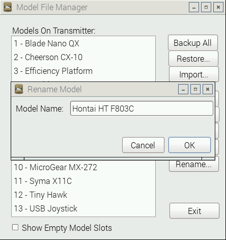

11 Aug 2015 02:50 #36767 by greenfly
Replied by greenfly on topic Model File Utility (Updated)
Some interesting news... it runs well on a Raspberry Pi!
I just tested the DebugBuild with my Raspberry Pi 2 running Raspbian. Everything worked without a hitch.
