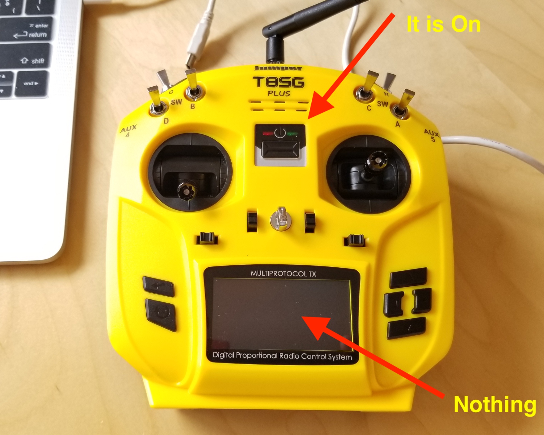

Jumper T8SG PLUS stopped working after FW upgrade was created by momen
After I did upgrade to my new Jumper T8SG PLUS it stopped working, when i turn it on nothing show up just empty black screen and also no sound from buzz when i move the trims buttons, please see the attached photo.
I used the uploader 0.8.0 (in my mac) with 05-13-2018 build (deviation-devo7e-256-v5.0.0-f17ed68.zip) then the issue happen.
I also tried other stable build for devo7e (when I connect tp uploader i see Devo 7e not T8SG) but still same issue and I tried nightly build from 05-13-2018 that says t8sg insted of devo7e and I tried with format option as well but still same issue.
At least I still can connect it to uploader and do update and see the files in file manager but when i turn it on to normal use without holding EXT then it is not working.
Any one faced same issue with Jumper T8SG PLUS ? or if you know anything that may help ?

You shouldn't flash a 7e or t8sg v1 firmware to a t8sg v2 plus.
Check out this one instead

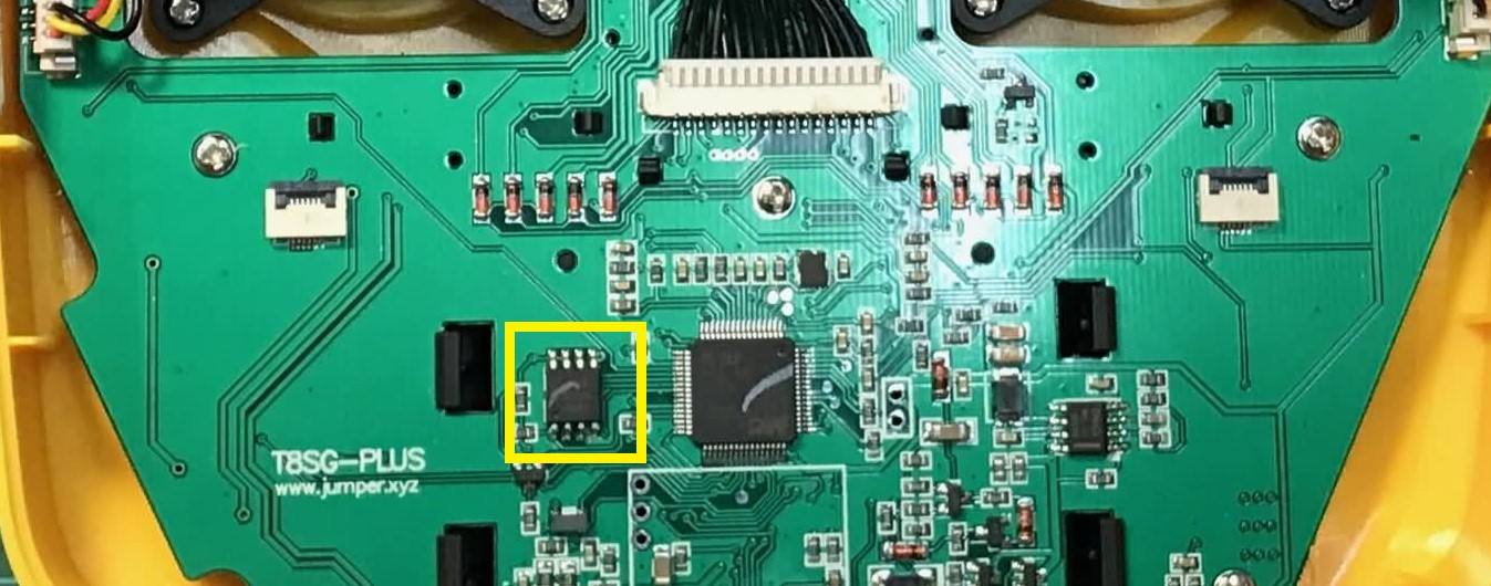

I bought 'T8SG V2 Plus' which became available in Japan 2 days ago. Although I bought one even at the beginning of sales, the display unit was broken.
If the latest firmware is written to the newly purchased transmitter, the model memory file will be damaged or the transmitter setting will not be stored, and eventually the screen will not appear even when the power is turned on It becomes a state.
You can not format the memory by connecting to the PC. This phenomenon will work properly when returning to factory shipment firmware.
With the transmitter you bought first, there is no problem with the latest firmware.
I looked at the inside of the old and new transmitters.
There seems to be no change in PCB. However, the memory that I think is installed next to the CPU is different. Moreover, there is evidence that the memory IC of the new transmitter soldered by hand.
As I guess, I think that memory IC could not be obtained, I soldered the IC of a different manufacturer later. Did not we change the firmware somewhere so as to operate so that the IC changes and works?

Looking at the IC attached to the new transmitter you can read 'WINBOND'. I can not see the old transmitter well, but it looks like 'SST' in the part that seems to be the manufacturer name.

The changed IC is the IC enclosed in yellow.
23 Jan 2019 06:06 #72486
Replied by vlad_vy on topic Jumper T8SG PLUS stopped working after FW upgrade
Can you try modded nightly build T8SG V2 Plus firmware with flash memory auto detection?

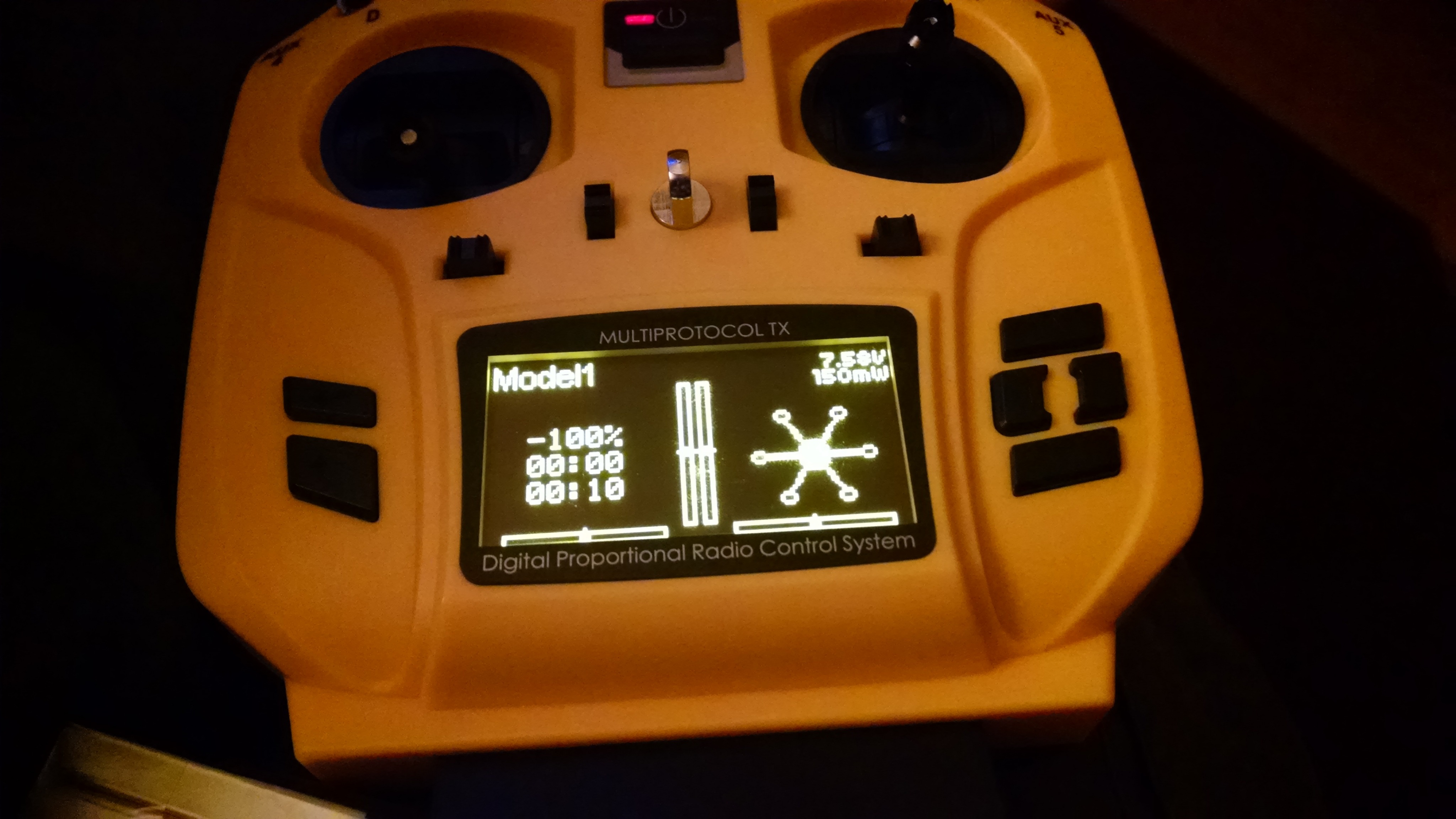

It seems that my friend 'Tonsuke' confirmed operation.
Thank you very much for your early correspondence.
