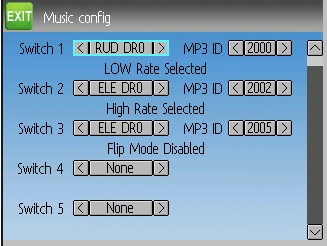

Encouraged by the interest I put some effort in the color menu, so now you can find attached builds for 8/10/12/7e-256.
Also attached is once again a sample music.map file. Previous testers please note that I removed the obsolete first column in the file, as we now have model specific alerts configurable through the menu (although not yet implemented for AUX knobs and buttons...).
I will also uploaded two emulators (windows) to play around with.
DISCLAIMER: Please be aware that the code isn't foolproof yet, so you might experience crashes (for example trying to use Music config menu when there is no music.map file in your root directory)!
Download Windows emulators for devo 8 and 10
Screenshots:
Screenshots:
