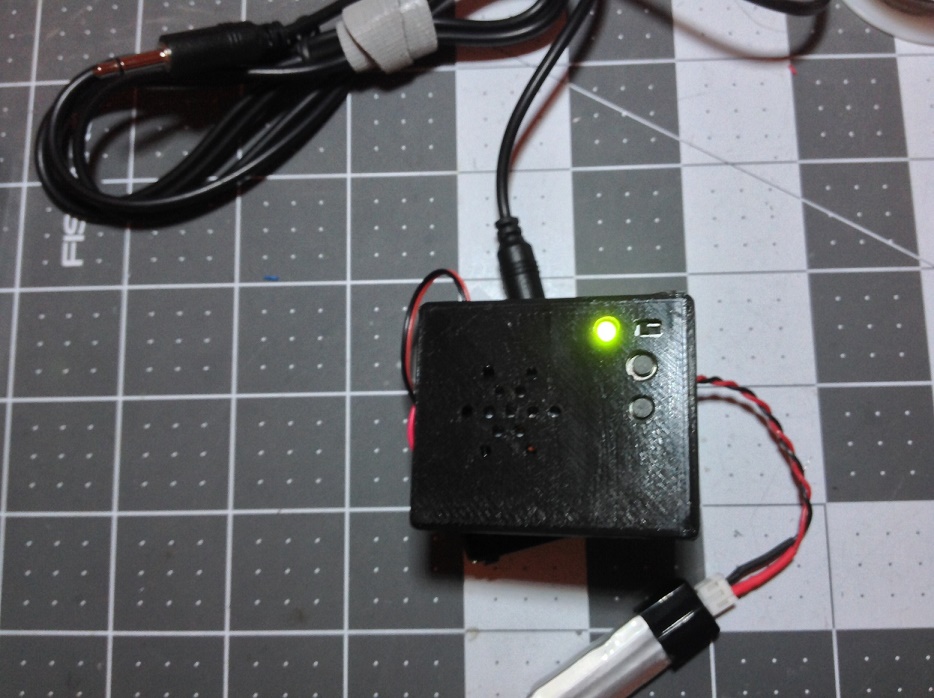

13 Feb 2017 13:52 - 13 Feb 2017 13:56 #59109 by Deal57
I have put together a prototype for an external speaker box for the DFPlayer. While I believe it to be fully functional, I still need to load the test Deviation software (however, it is modeled on my breadboard from some time ago, so I'm pretty confident it will work). The big gap now is figuring out power requirements and the right size for the box.
This external box includes these basic features:
  • Very audible volume
  • Next/Previous buttons (also do volume control)
  • Power Switch
  • Power Indicator - busy indicator
  • USB Access to SD card
  • 3.5mm Audio Jack for PPM input... I could still add a headphone jack
  • Battery power (LIPO) - don't yet know much power will be required
This box is based on a Thingiverse Push-toy box (thing:219437) because it has the right sized speaker holder (28mm - Radio Shack part 273-092) which also serves to amplify the volume noticeably. This box is not actually big enough for all my current wiring and battery, but with maybe an extra 6-8mm in height everything might fit - it is now roughly 50mm x 70mm x 24mm. Size will dependent on power requirements (thus battery size) for long-term use. I found that a Pololu step up/down regulator at 4.2v seems to be the sweet spot for the player and my add-on items.
I have yet to install the software on my Devo, and I'll post results when it's done.
Last edit: 13 Feb 2017 13:56 by Deal57. Reason: Attachment was too large.
