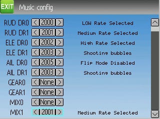

After thinking about it I decided on moving to predefining all switches in the music config menu. The number of clicks is not that much higher, since there is only one selection field per switch compared to two in the first version, and the code is a lot cleaner.
I thoroughly tested the new build in the emulator, please try again with the updated build (1896b91) I attached to the post above replacing the old build.
I also made the menu consistent with other deviation menus where you go from "none" to a selection with the "right" button. Pressing enter on the ID will still trigger playing the MP3.

08 Feb 2017 09:03 - 08 Feb 2017 09:05 #58908 by Morlacus
Moeder,
Testing the new devo8 dfu firmware. The presentation ot the music page is easy to use. I see the description of the music in the page, the musics number are recorded but unfortunately no sound :( neither when pressing the id in the music page nor anywhere)
My mp3 files are in the root of my sd card. Am I wrong ?

08 Feb 2017 17:37 - 08 Feb 2017 17:52 #58932 by Morlacus
Eureka !!!!:cheer: It works after putting the mp3 files in a mp3 folder as you said.
the first message I heard was a transmitter battery voltage which said very correctly 6.01 volts (I had put the alarm very hight to force the message)
I have also a switch message which works very well. (I have only programmed one for testing)
