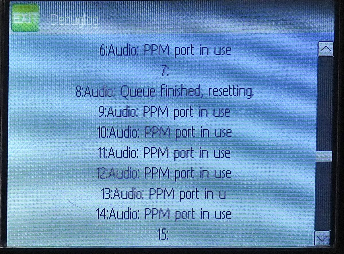

24 Feb 2017 09:13 - 24 Feb 2017 19:15 #59555 by Morlacus
Moeder wrote: I replaced devo8 build with a developer build which has debug log menu. After starting your TX with the flickering screen, once you regained menu access go into debuglog menu and post what you can find there.
I tested the debuglog build.
I had no flickering after the ppm protocol model.ini. :unsure: And after reloading my test model with sound I had no sound.
I enclose a snapshot of the log . Is there another way to record it ?
To check I came back to the original 5f40044.dfu. I had again flickering and sound.
Sorry for these results which seem somewhat inconsistant.

24 Feb 2017 17:37 - 24 Feb 2017 17:40 #59571 by Moeder
So it seems to have something to do with the handling of ppm detection in the audio code. I will look into it.
Edit: could you also post debug log of loading ppm model and then switching to sound model?
Last edit: 24 Feb 2017 17:40 by Moeder.

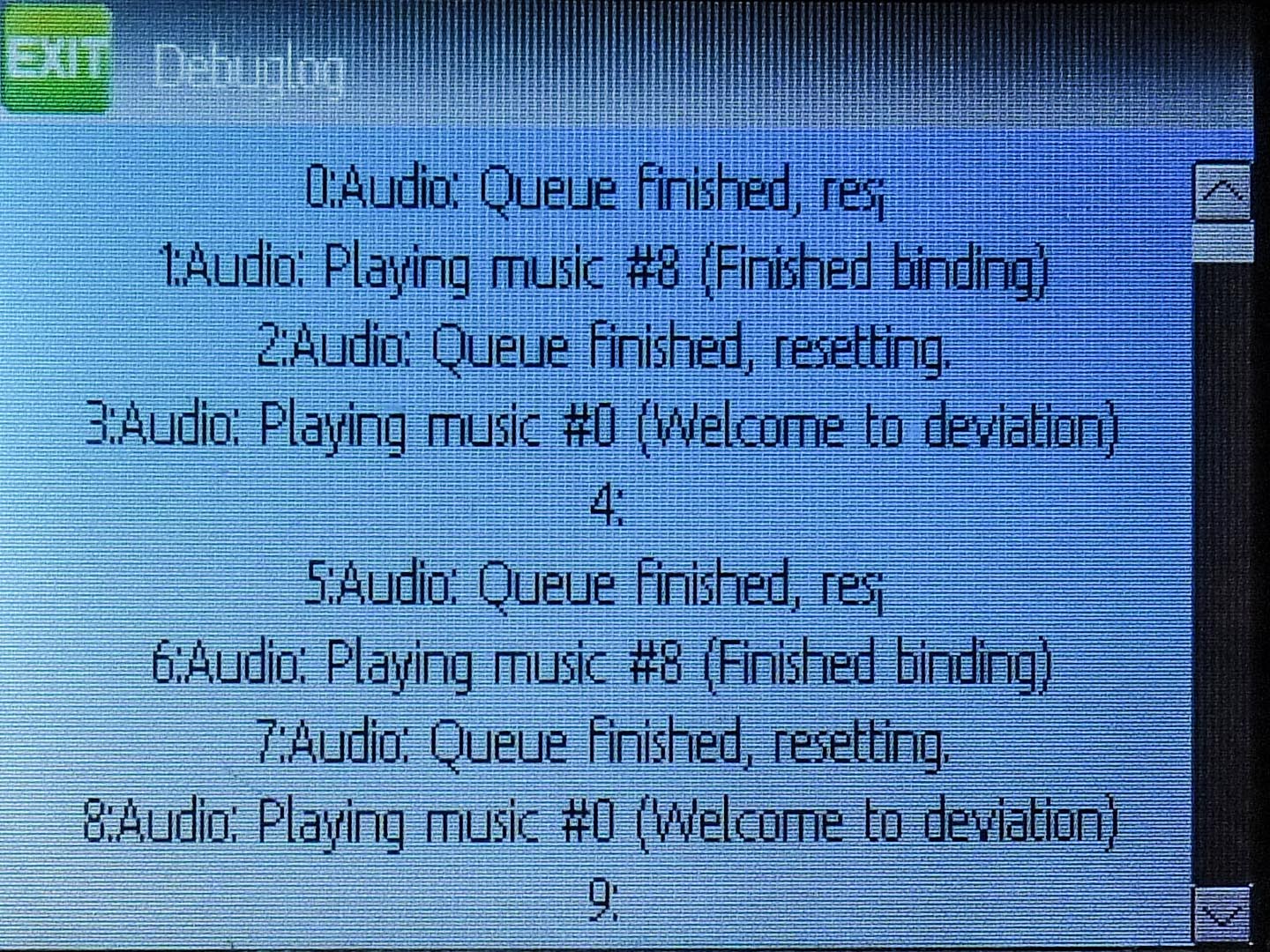

24 Feb 2017 19:14 - 24 Feb 2017 19:16 #59576 by Morlacus
Here are some more pics of the tx back to sound model. I did not hear the sounds mentionnned in the debub log.
Last edit: 24 Feb 2017 19:16 by Morlacus.
25 Feb 2017 09:18 #59601 by Moeder
Thanks, I went through the code and noticed audio output commands are not enabled in development builds ;)
The current way of setting up the port and detection of its use by ppm is rather crude, I will change this hopefully solving the problem. Any other bigger problems noticed? How do the aux knobs work?
