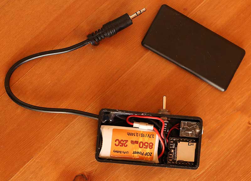

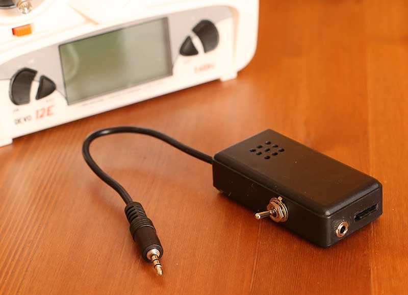

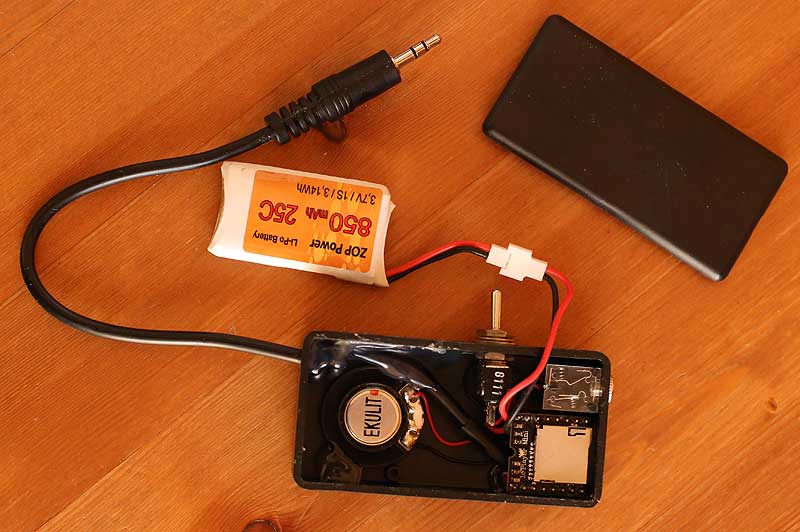

BTW this is my external DFPlayer box:

Nice box you made there, FDR, not much wasted space! Do you velcro it to the TX? But with the low price tag on deployers, there should be one INSIDE every one of your devos ;)

Moeder wrote: Nice box you made there, FDR, not much wasted space! Do you velcro it to the TX? But with the low price tag on deployers, there should be one INSIDE every one of your devos ;)
Thanks! I did it quick, with a cutted finger... :lol:
I don't know yet how I will attach it to the TX. First I too thought about velcro, but maybe I will tie it to the handle instead.
It's not about the cost of the DFPlayer. I even glued it into that box. ;)
I just haven't decided where to put it, or how should I mod the TX, so it is just a temporary solution....

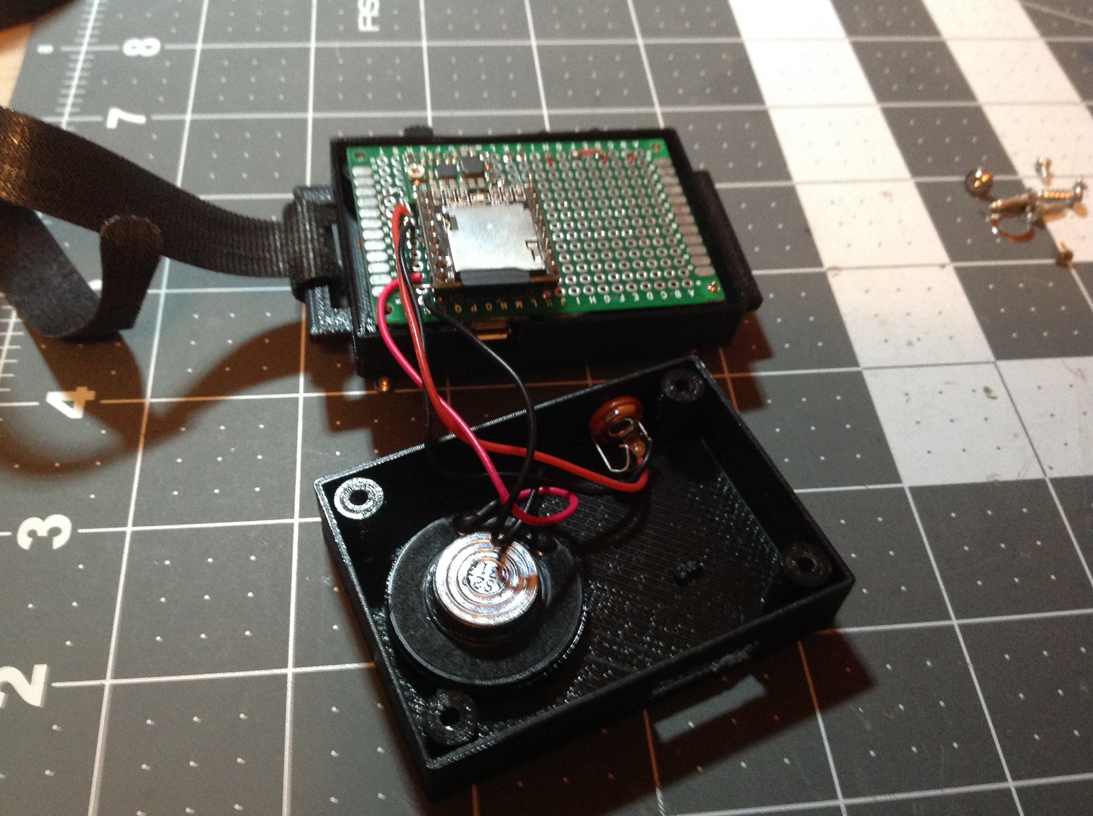

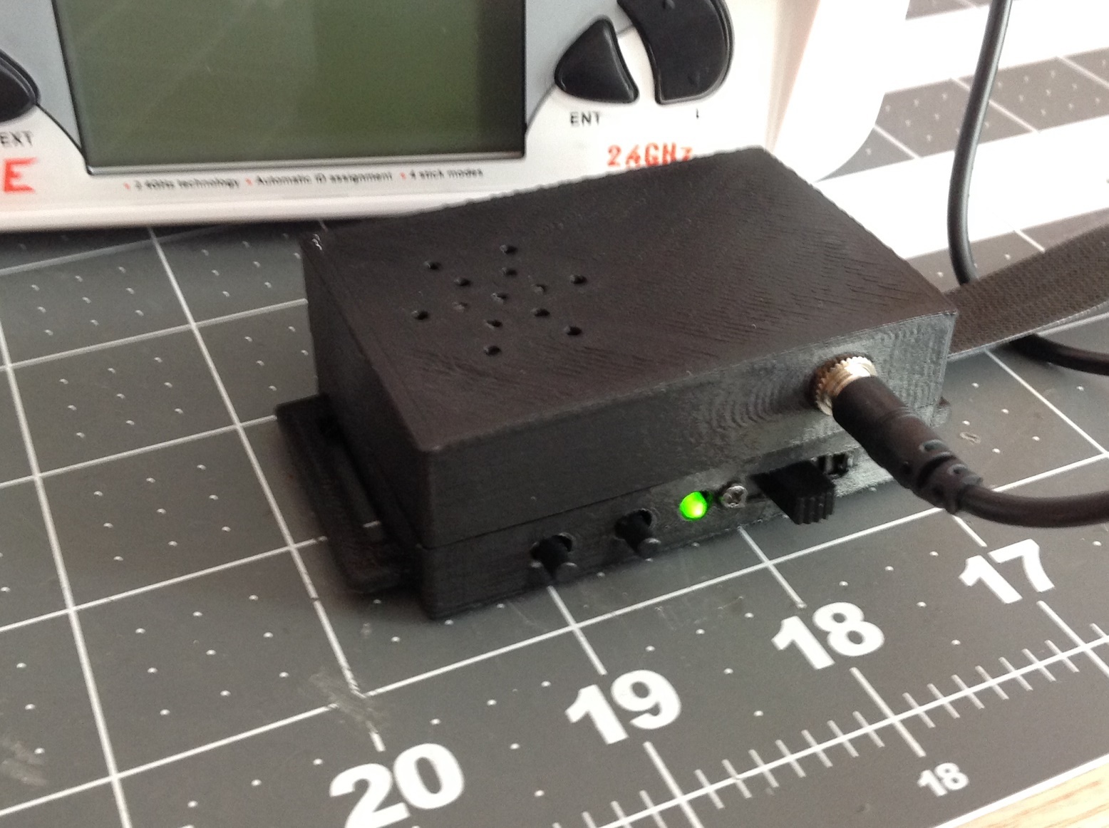

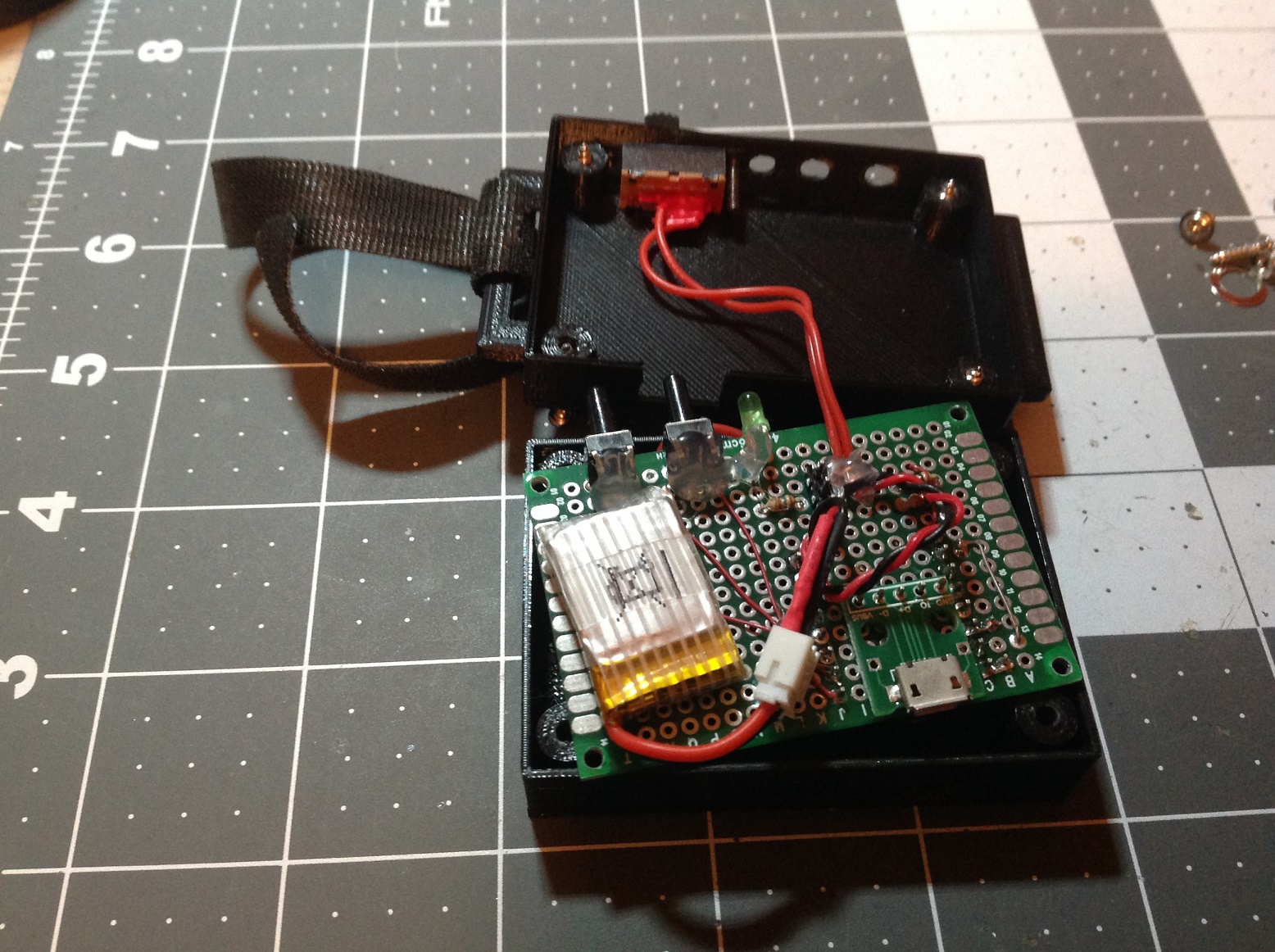

15 Mar 2017 02:03 #60201 by Deal57
I like the compact box and the big battery! I am glad to hear that the speakers are performing well for all of us... I was a bit concerned at first, but now for the most part I keep the volume at only about 18 (about 1/2 max).
The box I 3d print is somewhat bigger, and the battery is smaller... I found in the past week of testing, maybe 30-40 minutes flight time with a couple of small quads, the 150mah battery is down from 4.14v to 3.95v -- I'm using a battery from my E010. So I'm thinking battery life of about an hour of regular use with this little battery.
This box is bigger and it allows access to the SD either physically through a side panel or by using the inbuilt micro USB port (my PC sees the SD card as a thumb drive). And I added buttons for volume. The final version includes handles to attach with velcro, but i'm not convinced that is the best way yet... I can't get it to sit right on my 12e. I'm waiting for a 3-pack of dfplayers to put inside the Devo anyway. The box is available on Thingiverse .

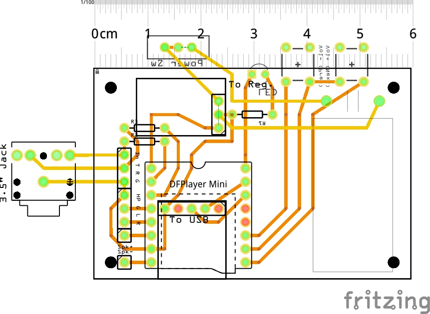

Here's the basic circuit board I used. I can provide the fritzing file if anyone wants it, although I have made few modifications to this. It's really a hack job but it works. I think it probably could use a few caps in strategic locations, but since i'm using the Pololu step-up/step-down regulator I'm not worried about power problems. The rest of the parts I had lying around. I would like to have done something with a battery charging system, so it never has to be taken apart, but that's not something i have any experience with... if anyone has suggestions or can help with design, PM me.
