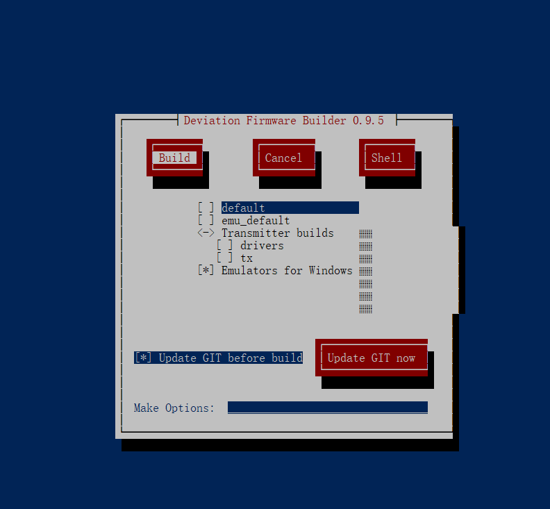

- wind10071
- Posts: 20
01 Mar 2019 04:27 #73079
by wind10071
Replied by wind10071 on topic Deviation v5.0.0 build with latest protocols
Need help!
How does DevOTX choose to build?
