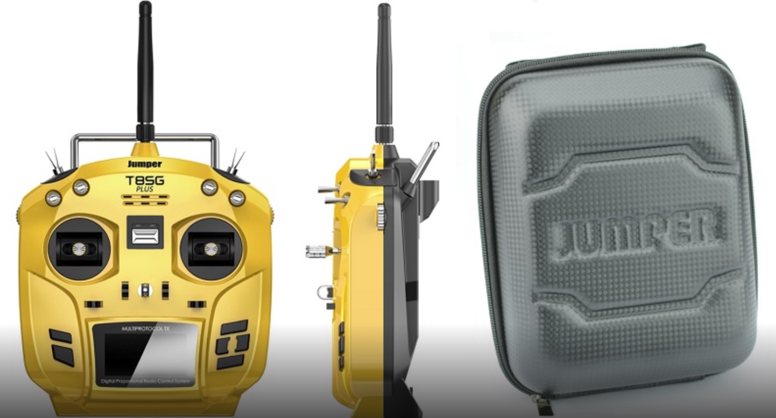

22 Jan 2018 15:02 - 22 Jan 2018 15:05 #67046 by Piedro
Jumper T8SG Plus available in March 2018 for $129?
Source: www.firstquadcopter.com/news/jumper-t8sg-plus-transmitter/

15 Feb 2018 19:31 #67520 by Iroquois
Does anyone think this is an improvement?
