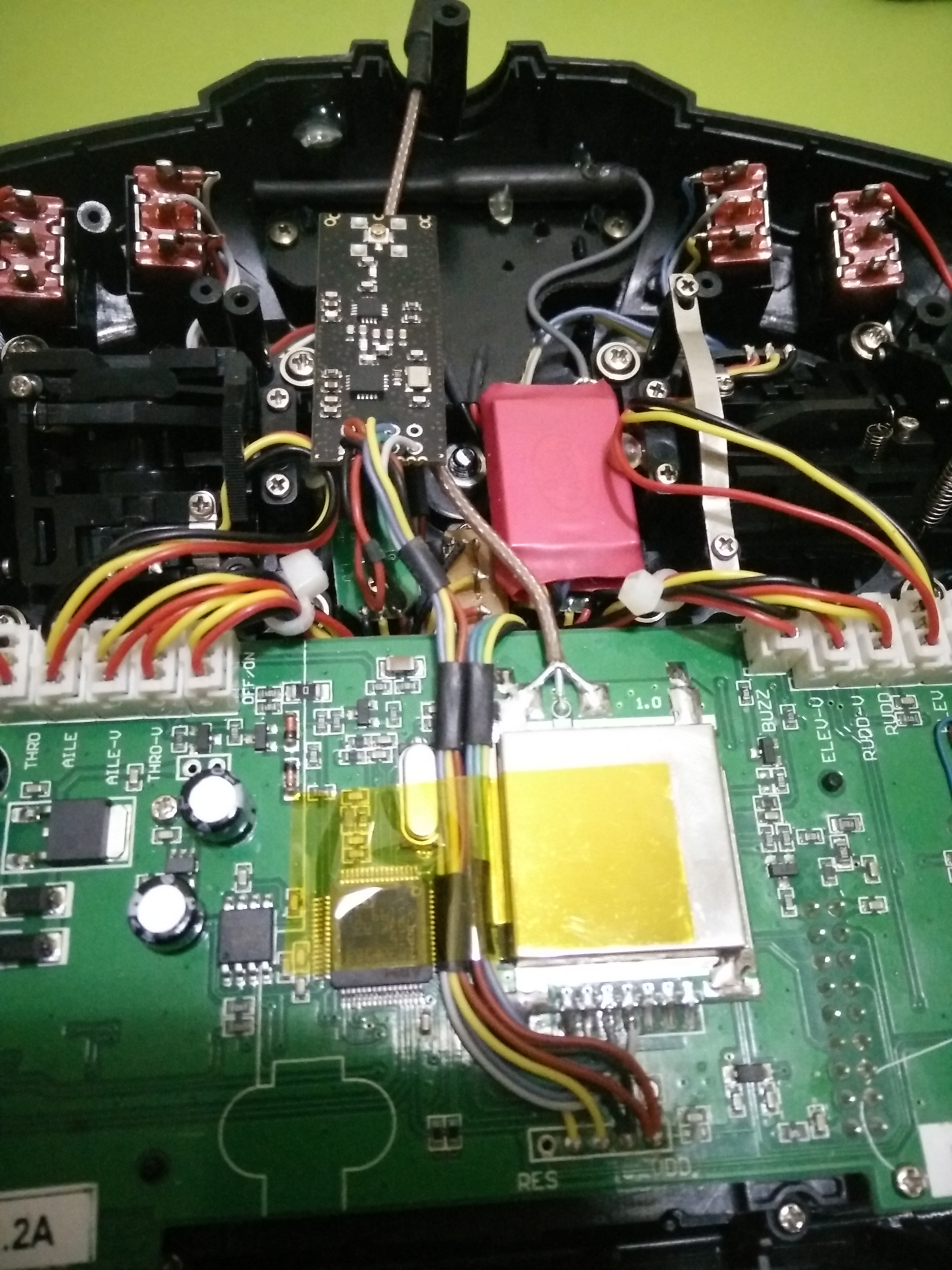

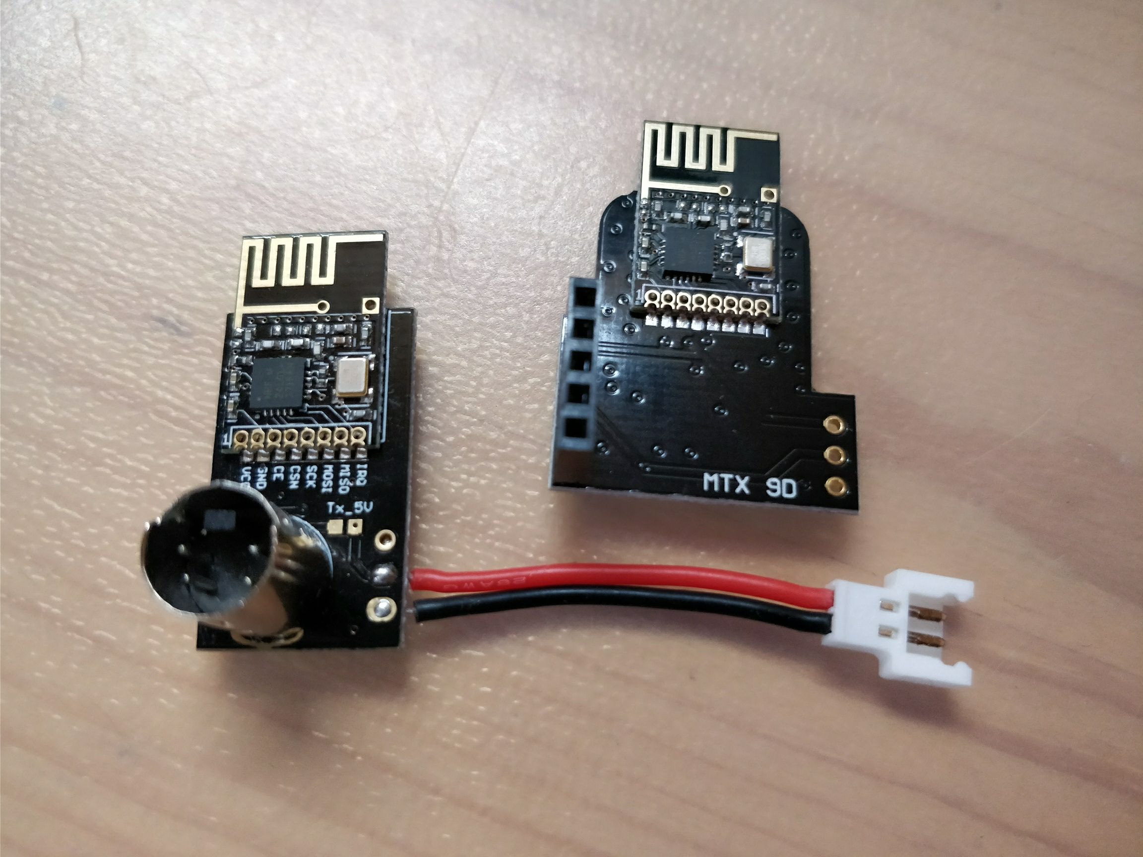

24 Dec 2017 02:12 - 24 Dec 2017 02:28 #66593 by goebish
Do you have a DIY or "genuine" nrf24-multipro ?
Most of the cheap ones on banggood don't work with the E010 either.
If using my firmware from github, expected channel order is TAER (deviation is AETR by default), and you'll probably have to reverse rudder & aileron to use it with deviation.
Modules using this board usually work with the E010 (that's what I use to make the nrf24-multipro modules):
www.banggood.com/DEVO-Transmitter-Tuner-...ys-V922-p-89812.html
Also works perfectly when installed into a Devo.
Last edit: 24 Dec 2017 02:28 by goebish.
24 Dec 2017 02:29 #66595 by kabuto
The link you posted is the one I put in my 7E, works perfect with E010.
What I had tried are cheap ones on banggood, both of them are not working, the led never lit up!
24 Dec 2017 02:35 - 24 Dec 2017 02:36 #66596 by goebish
Ok, most of those modules are having issues with the E010 (latency, short range, or doesn't bind at all), sorry but you're screwed ;)
