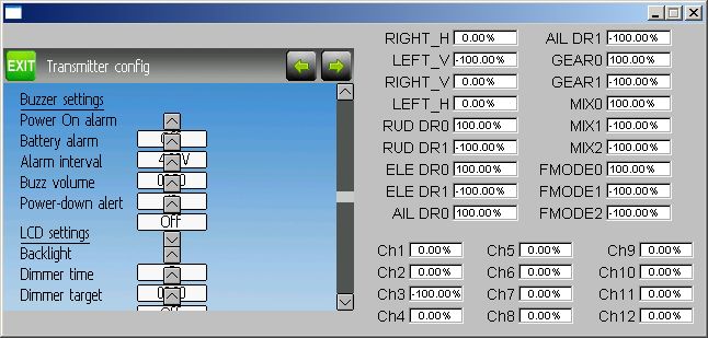

Replied by WheresWaldo on topic Beta 12 new issue #69
Some selection boxes now draw too small in the following screen:
Model setup
Timers
Datalog
Mixer -> Source
Mixer -> Type
Okay, there are issues with every screen, some are artifacts under the items, others are the small boxes. I have opened an issue on your repo.

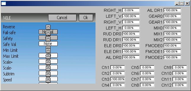

24 Nov 2013 23:20 - 25 Nov 2013 00:07 #15785 by WheresWaldo
Replied by WheresWaldo on topic Beta 12 new issue #70
Devo10_beta12, once you move away from DEVO protocol on the Model setup screen you cannot move it again. Steps to reproduce:
  1. Press ENT
  2. Select Model menu
  3. Select Model setup
  4. Scroll to DEVO
  5. Press left to display NONE
Now you cannot scroll to any other protocol.
This is an issue in the emulators too. Both the 7e and 10 exhibit the same symptoms.

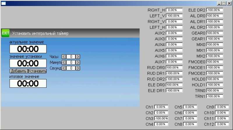

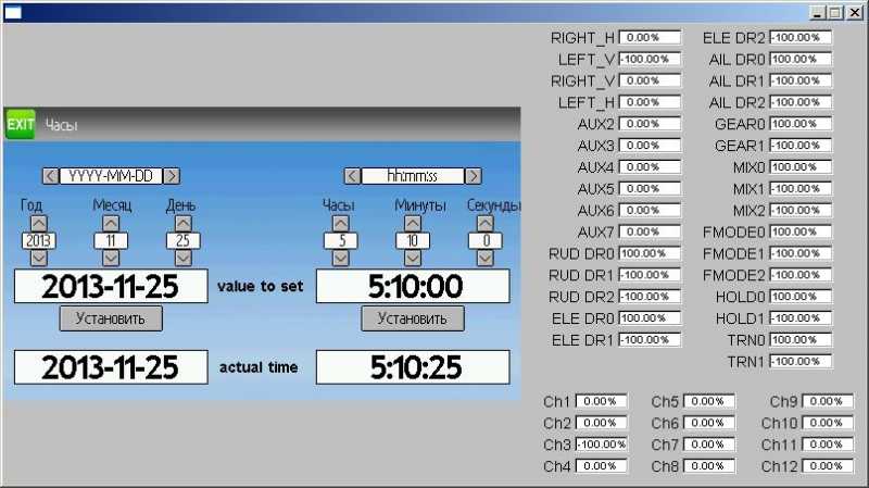

25 Nov 2013 05:13 - 25 Nov 2013 05:32 #15790 by vlad_vy
Replied by vlad_vy on topic publishing an intermediate release 3.1.0?
Not translated (and bold font, not translatable), 'value to set' and 'actual time'.
Doesn't fit (russian minutes and seconds). Also, will be nice to add more vertical space between time values (actual, set, result).
Last edit: 25 Nov 2013 05:32 by vlad_vy.

  8. Press EXT to get back into 'Model menu' and press ENT afterwards.
  9. Few seconds long 'Model Setup' only will be displayed. Crash follows.
If you just press once 'DN' after point 6 focus is set to "Load" and no crash will happen.
Thanks for the exact description. The beta-12 emu crashes also. I can work with this.
  • rbe2012
  • rbe2012's Avatar Topic Author
  • Offline
25 Nov 2013 08:58 #15794 by rbe2012
Replied by rbe2012 on topic publishing an intermediate release 3.1.0?
I fixed the issues described above (strange textboxes in Devo8, too small textboxes in Devo10, textselect: only left arrow works). This were all errors resulting from the deactivation of the textselect_vert_64 boxes where I mixed up the conditions...
I try to find the error kreidler described and make new betas.
  • rbe2012
  • Offline
25 Nov 2013 09:15 #15795 by rbe2012
kreidler wrote:
  1. Load the hubsan.
  2. Message box appear that 'safe value = -100%'.
  3. Do not press ENT. Move the stick back only!!
Looks as if the condition "module is installed" is checked later than the safety settings - otherwise it should not appear when a model is loaded which uses a module what is not installed.
I will make some tests...
