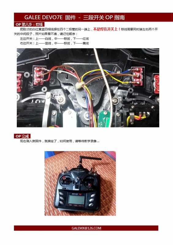

21 Jan 2014 21:32 - 21 Jan 2014 21:36 #18871
by HappyHarry
Replied by HappyHarry on topic including custom-switch support in Devo 8s
pb this change hasn't made any difference, i think i may see what might be wrong, if you have set the code to use galee's wiring scheme it uses these connections
where mine is wired for the 1 x 3way like this
if you look the two wires that go to the outer contact points my single 3 way switch, they are split one to each of the 3 way switches in galee's style of wiring. would that make a difference?
Last edit: 21 Jan 2014 21:36 by HappyHarry.
21 Jan 2014 23:20 #18882
Replied by PhracturedBlue on topic including custom-switch support in Devo 8s
why do you have diodes on your switch? The 3x1 should not require that (and it likely explains why the code doesn't work, though not why the patch you were using does).
the only case you need diodes should be for the 3x2 switch. the 2x2 and 3x1 should not need a diode.
The code I've checked in uses different scanning mechanisms for the 2x2, 3x1, and 3x2. So the wiring for the 3x2 is irrelevant when discussing the 3x1. the 3x1 code should match the original patch, however, it does assume there are no diodes on the switch.
I can make it work with the diode mod you have too, but I have no idea why it is there.

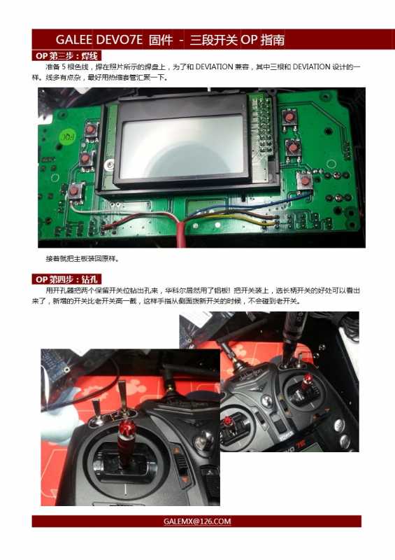

- blackmoon
- Posts: 402
21 Jan 2014 23:57 - 21 Jan 2014 23:59 #18887
by blackmoon
Replied by blackmoon on topic including custom-switch support in Deviation
The why is because in the original thread by cmpang the 2x2way had one diode per switch.
www.deviationtx.com/forum/how-to/1436-ad...imitstart=0&start=40
On the same thread Kaworu patch for the 1x3way had to have the switch wired like the 2x2way only the center would be the same : www.deviationtx.com/forum/how-to/1436-ad...vo-7e?start=40#11635
So we all assumed that the 1x3way would have two diodes, and the patch effectively works with that wiring (tough I didn't test it thoroughly).
So now if one goes 1x3 or 2x2 it should not have diodes and the wiring stays the same as per the posts I linked to ?
And only the 2x3 needs diodes, and wired per the pictures (from galee) posted above ?

22 Jan 2014 00:53 #18891
Ok, I just checked in new code that will hopefully get your switches working.
Note. there is a big change here.
I have created a new file 'hardware.ini' that contains all of the hardware modifications. the transmitter will not overwrite this file.
You need to move the switch settings and module settings to this file, otherwise they will not work.
There is an example version included, but also note that I changed the name of the switch parameter.
The parameter is now:(also allowed are 3x2 and 2x2)
extra_switches=3x1- IMback!
