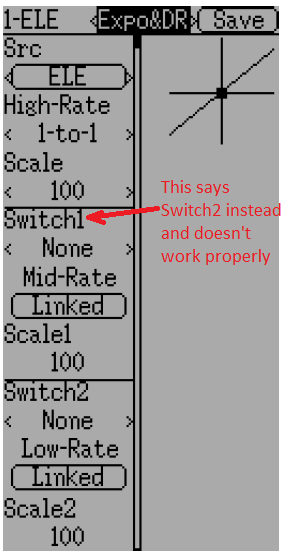

Since I installed the last HappyHarry build I think I found a bug, I loaded a 4ch templates, advanced GUI
The extra 1x3 way is correctly defined in the channel monitor, but when I go to mixers, I have the following.
If I choose the expo/dr curve, I only have one switch selectable for mid and low rates.
i.e I can only choose "switch2" no "switch1" is available as per the manual, this makes impossible to have a 3way state on a channel.
Whatever I do the Expo/DR mix isn't saved at all :(

blackmoon wrote: Since I installed the last HappyHarry build I think I found a bug, I loaded a 4ch templates, advanced GUI
Curve type complex works as expected.
Just hit the exact same problem, and was coming here to report it. In my case, I'm using the 2x3way mod, but the problem I see is the same (And same HappyHarry build)
I was hoping to use Expo+DR to have SW A0/1/2 act as a -100, 0 +100 switch (per the ongoing discussion about how the new switches work). In Expo+DR, instead of seeing three sections one with Src, Switch1 and Switch2, I see Src, Switch2 (that doesn't work properly, can't change the spinboxes, nor the scale) and Switch2 again (this one seems to work)
Attaching a bitmap to show the problem. Blackmoon, can you check if your says "Switch2 instead of Switch1 as well? It took me forever to notice it :)

Replied by PhracturedBlue on topic including custom-switch support in Deviation
This was due to some code optimizations I did. It is fixed now

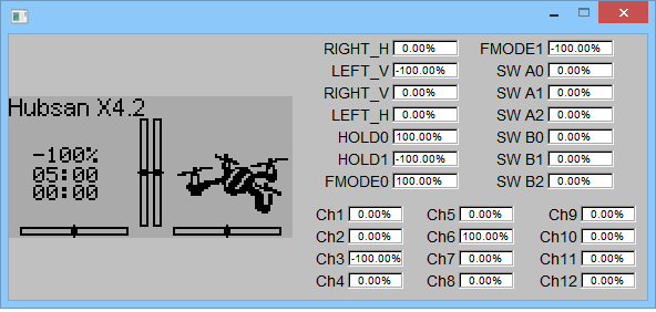

I'm playing with mixers, and I like being able to use the emulator instead of my Devo 7e. I'm using the Emu build for 7e from the latest nightly build (deviation-emu_devo7e-v4.0.1-aba7a1d.zip)
I'm currently unable to change the values for SW A0/1/2 and SW B 0/1/2. I see them in the emulator UI, and I even added a hardware.ini file in the fylesystem, just in case.
The boxes for the SW A and B all show 0 as value, which is wrong (some of those should be 100%, some -100%). See picture attached

31 Jan 2014 13:11 #19486 by PhracturedBlue
I never implemented it. It isn't hard to do though. Please file a ticket on bitbucket so I don't forget.

31 Jan 2014 15:11 #19492 by PhracturedBlue
I have checked in a fix
01 Feb 2014 20:09 #19618 by robca
Thanks so much for the quick turnaround, but...
I downloaded the latest nightly build (deviation-emu_devo7e-v4.0.1-3802611) and I see a change: now all values for SW A and B (0, 1, 2) are -100%.
But there doesn't seem to be a way to change any of those values...
Is it me? Or should I reopen the ticket?
01 Feb 2014 20:17 #19622 by HappyHarry
Replied by HappyHarry on topic including custom-switch support in Deviation
i just built the emu from 3802611 and enabled 3x2 in hardware.ini and i can cycle through the three switch positions for swa with the 'c' key and swb with the 'v' key
