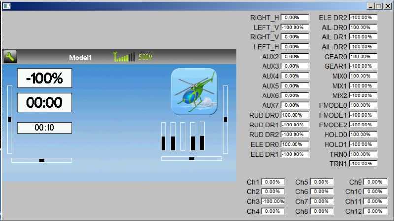

But, why can i see no toggles on GUI?

Downloaded and installed, all I get is a huge USB symbol.....
Edit: seems to be the file system. I re-installed the old filesystem from RBE and it works.

At first glance, this seems to do the trick. I can place any element, anywhere on the screen and align.
Suggestion: start with a "default" screen with some elements. Starting with a totally blank screen is a bit confusing.

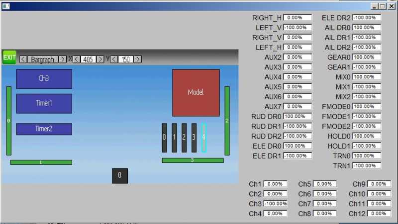

But i have no toggle icons. is there anything missed in my filesystem?
One Bug i found:
when you try to get the Toggle Box more than Y265 the EMU chrashes.
Greetings

17 Jun 2013 03:07 #11040 by Pattaya01
Raimili wrote: But i have no toggle icons. is there anything missed in my filesystem?
I also do not like the fact if you place a toggle element on the screen, it shows nothing if it is not activated. Only when you toggle, it becomes visible. Is it not possible to show some placeholder? Or an empty toggle icon which changes when you toggle?

I've updated the download link. It now includes a single zip file with the emu and filesystem. You can now actually add toggle icons as well, which was missing from the previous build.

I cannot delete an element, I cannot change the properties of an element. If I placed a timer, I am stuck with the timer, can't change it into a toggle or anything else. When I made a mistake, I have to start from scratch.
How to reach the config screen I seen in one of your posts before?
Edit: when I exit and save, and start up again, some elements are gone.

17 Jun 2013 16:28 #11066 by FDR
Select an element and press ENT.
There will be a dialog shown, where you can set the properties for all the controls of the same kind, and you can delete controls too...
