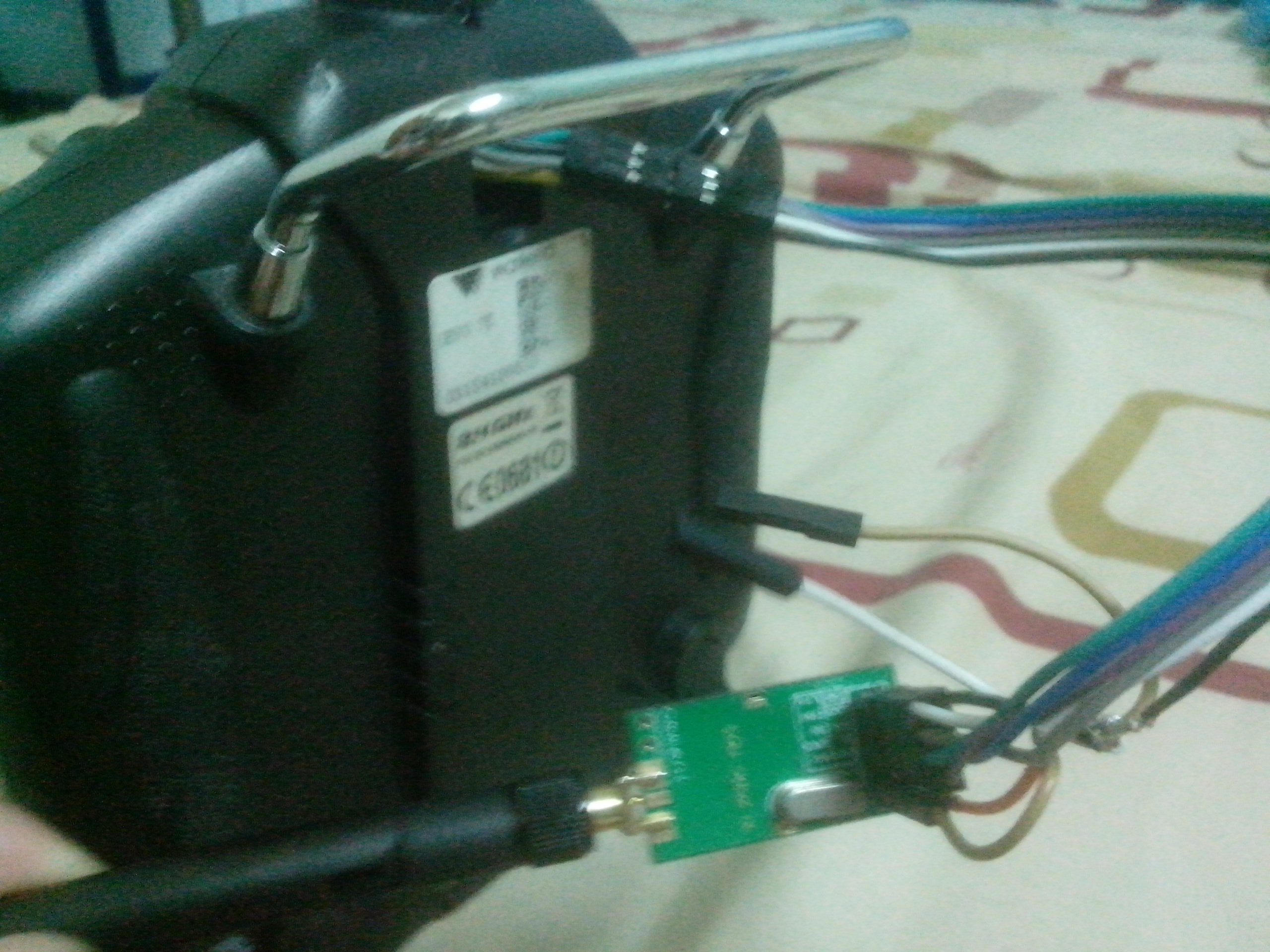

07 Aug 2015 04:39 - 07 Aug 2015 04:41 #36634 by thebestvip84
Replied by thebestvip84 on topic Frsky compatibility
ovres wrote: with some description.
hi there, this is my first post on forum, i order a xl2500-D03 exactly the same this. I soldered this module to my Devo 7e with the same diagram like this.
the lastest deviation nightly build reconizge module no problem but i can not bind it with Frsky V8FR-II HV rx. I have tried many ways but still not bind.
Please help, i am dying by headache. Thank you all

07 Aug 2015 05:14 #36638 by mwm
Replied by mwm on topic Frsky compatibility
Is your Rx in D mode? That's the only one n supported by deviation.
07 Aug 2015 05:56 #36639 by midelic
Replied by midelic on topic Frsky compatibility
I think fine variable strike again.I have the same module and I keep fine =-41.
07 Aug 2015 06:10 - 07 Aug 2015 06:21 #36640 by thebestvip84
mwm wrote: Is your Rx in D mode? That's the only one n supported by deviation.
oh my god, i think this Frsky V8FR-II HV rx not have D mode, may be only V mode. i order from banggood :
www.banggood.com/FrSky-V8FR-II-2_4G-8CH-...Version-p-69051.html
search youtube and this rx can bind in D mode (youtube..com/watch?v=6s064-cMXQQ) by jumper signal ch1 +2
May be i had order wrong item?need a D prefix-in -name frsky rx to have D mode to bind with deviation?
midelic wrote: I think fine variable strike again.I have the same module and I keep fine =-41.
i am newbie to this? can u explain how can i fine turn the frequency?
if i follow this guide? (http://w.w.w..rcgroups.com/forums/showthread.php?t=2124647)use devo 7e ppm out -> adruino -> xl2500 to bind with this rx. is that possible?
Last edit: 07 Aug 2015 06:21 by thebestvip84.

07 Aug 2015 06:35 #36643 by thebestvip84
wow. thank you, after some digging on the transmitter, i can access to the fine turn by press on the button FRSKY protocol. change to -41 and able to bind. thank you again!
07 Aug 2015 06:52 #36644 by mwm
You Rx has both D and V modes. Since it doesn't do telemetry, there no reason I know of to prefer one to the other. But I was wrong earlier - both are supported, you just have to make sure the Tx and Rx are both in the same mode.
