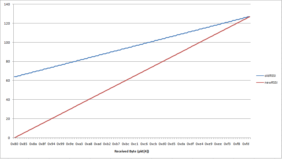

The interpretation of the RSSI telemetry byte was fixed with this pull request as discussed above . Nothing changed about the protocol itself. I've attached a graph showing the difference between the old and new displayed telemetry values.

Based on the graph if you were seeing a max RSSI of about 110 then the max you'll see now is about 90. The new RSSI will drop off more quickly as the received value changes which could make it look more jittery.
That's right, the signal fall from 110 to 90 near the model.

Guys what was changed was the RSSI interpretation.
The previous one was wrong,With that you cannot make connection fail in base of RSSI,That would stay on higher values even you cover completely tx antenna as you can see on the graphic above.
That was very dangerous because it can cause false security that you have good connection and cause some problem in the field or hurt somebody.
I would not have noticed before because I don't have Devo TX but some Devo TX users complained to me about that in private so for that I let you know.
Now you have RSSI alarm before not.What you need is to adjust RSSI alarm properly not based on previous one.
