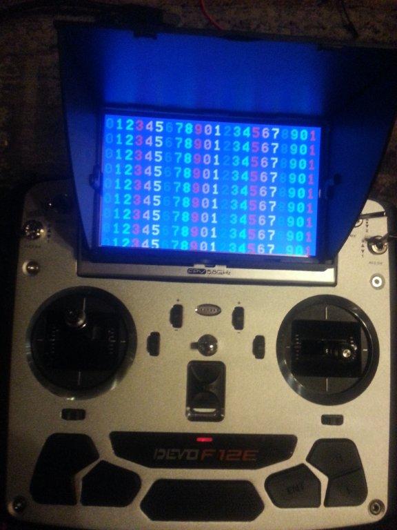

12 May 2015 03:24 #32424 by PhracturedBlue
Replied by PhracturedBlue on topic deviation-devo F12E
Screen is working:
It is too bad that there isn't much flash. If they had just spent $0.30 more, this thing could have 4MB of flash, and we could have a full graphics (264x162x7color) screen. As it is, we'll need to use the text-display mode instead I think. I need to work out the buttons, sticks and switches next, then it should be possible to get the work we've been doing on the F7 ported over.
