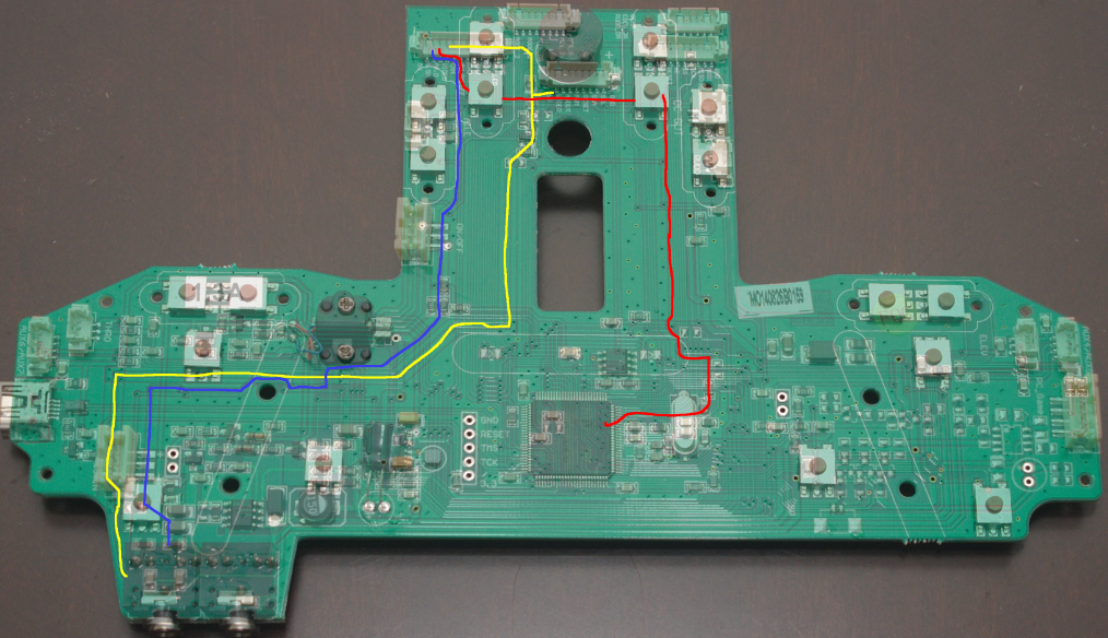

Thanks Vlad.
That CH5 is connected on the other end to a pin called A6.0 which I had assumed was connected to the Audio port. In reality the 6.5M pin is connected to the Audio jack. The A6.0 pin seems to be connected to PD.8 through a 220-ohm resistor though it is tricky to follow due to being obscured by switches and whatnot.

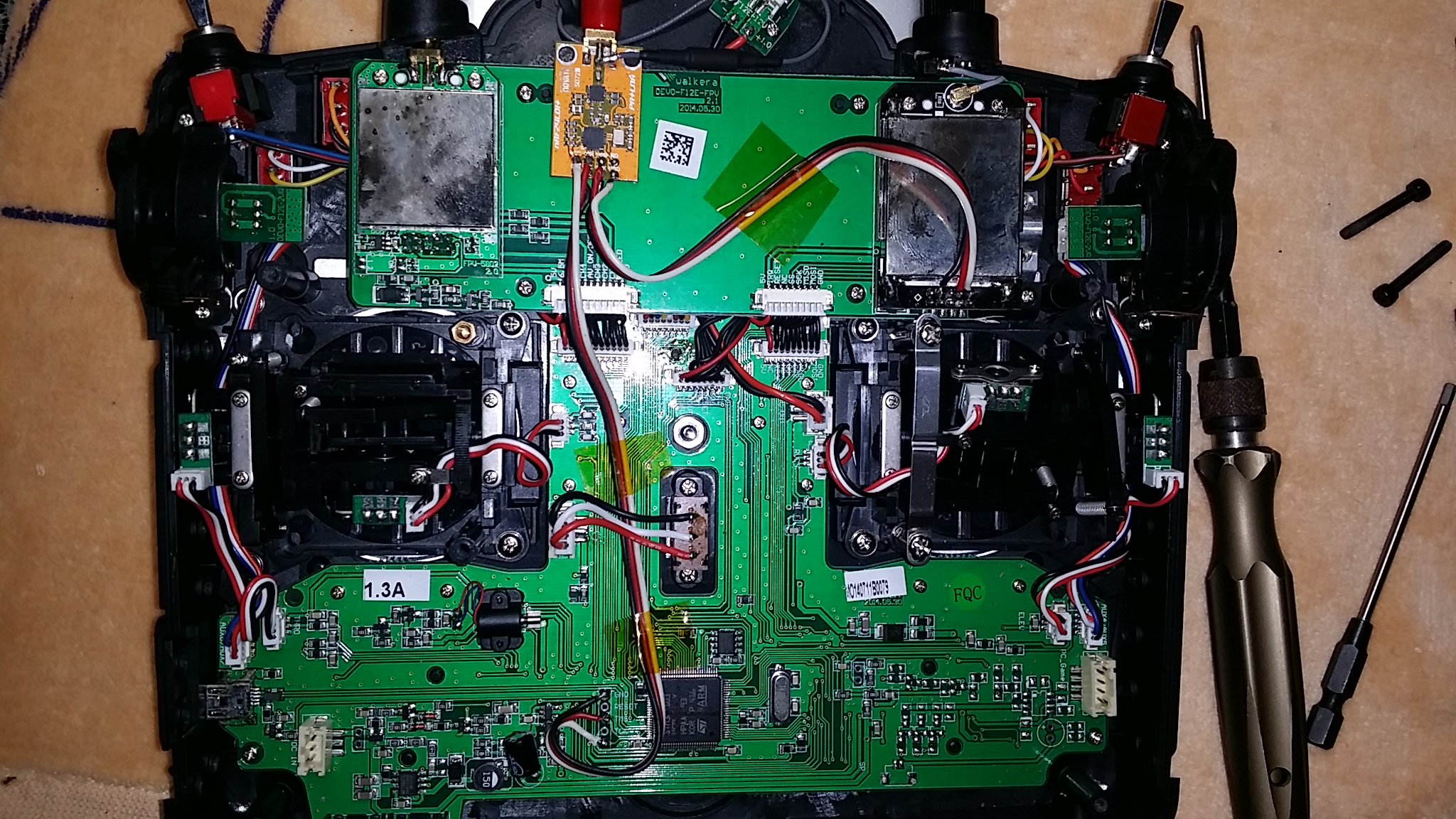

Hi PB,
Is that mean, F12E has full function as DEVO8 now? can I install NRF24L01 module in F12E?
Thanks!
Replied by dc59 on topic F12e now fully supported?
PhracturedBlue wrote: Please don't start new threads when there is a perfectly good active thread already available.
And yes, the F12E is supported now (though still experimental). I haven't implemented the Standard GUI yet, and lots of testing is needed, but it is working. Read above for instructions as installation is NOT like other Devo radios.
Hi PB,
Thanks!
12 Jun 2015 00:36 #33892
Replied by PhracturedBlue on topic F12e now fully supported?
In theory yes. The F12E uses the standard module, so installation is just like the devo8 (there are 2 RF modules in a F12E, so make sure you use the 2.4GHz one). The standard mixer is not implemented yet, but everything else should be there.

Replied by dc59 on topic deviation-devo F12E
Thanks PB.
I always use advanced mixer,there's no problem for me.
I'll try to install nrf24l01 module in F12E for my toy quads(with FPV mods.) and will report result.
