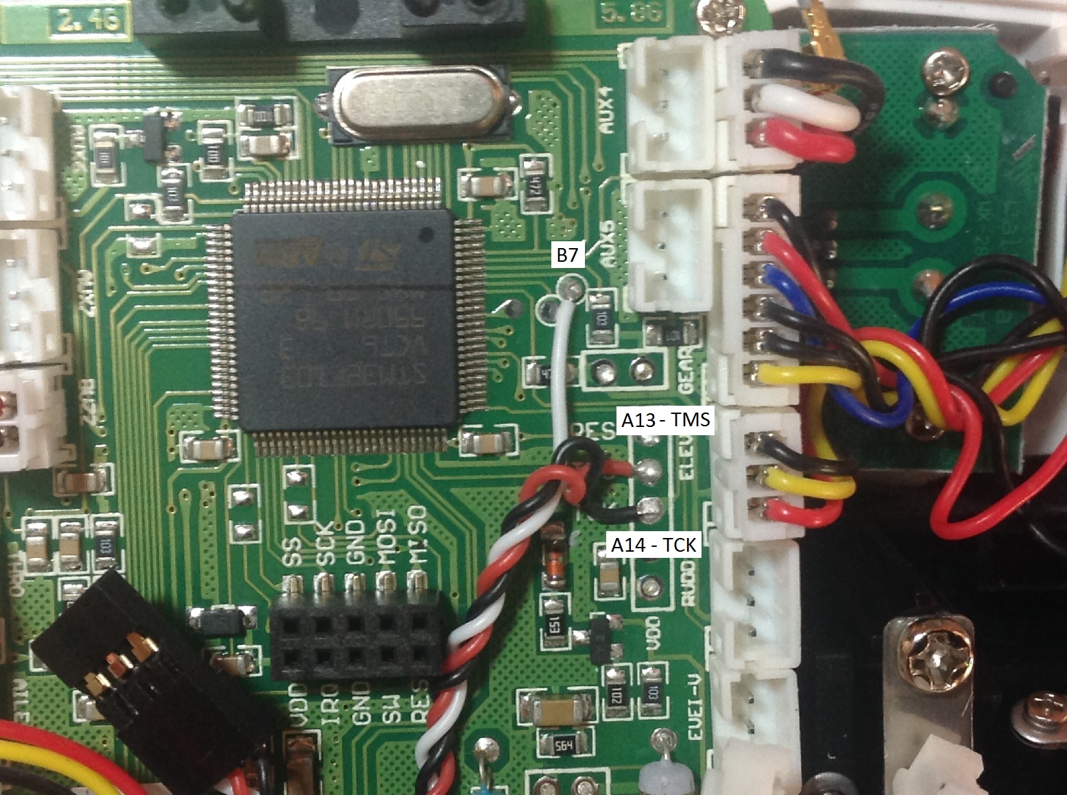

- MikefromGermany
- Posts: 39
29 Jun 2017 10:37 - 29 Jun 2017 10:55 #63206
by MikefromGermany
Replied by MikefromGermany on topic New 4in1 installed on Devo12E. Now what?
no one can answer that without knowing what exact connections you have made.
Post a picture of your wiring, so one can see what module is connected to what solder pad.
or describe the connections from module pads to TX pads (e.g. 2401 to B7, 7105 to A13, 2500 to A14) Use https://www.deviationtx.com/media/kunena/attachments/2662/IMG_1697sm.jpgthis picture for reference.
THEN one could make a proper ini for you, or tell what has to be written in.
