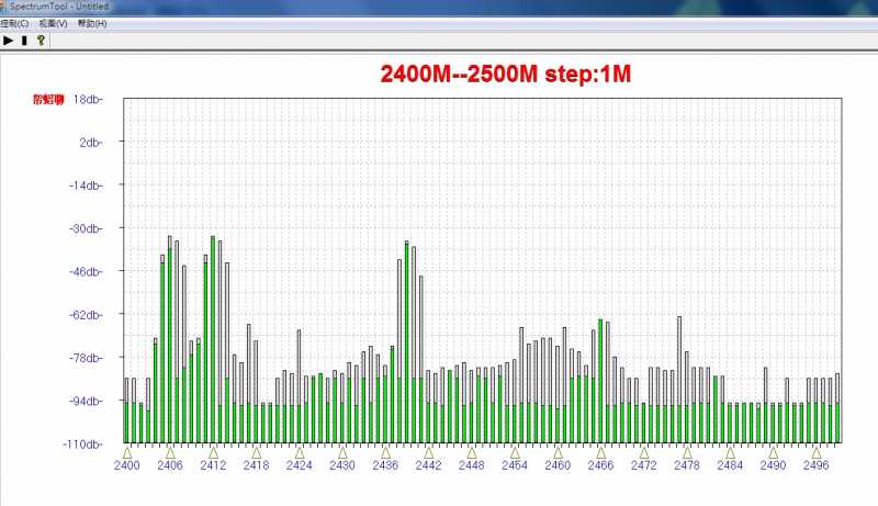

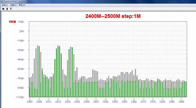

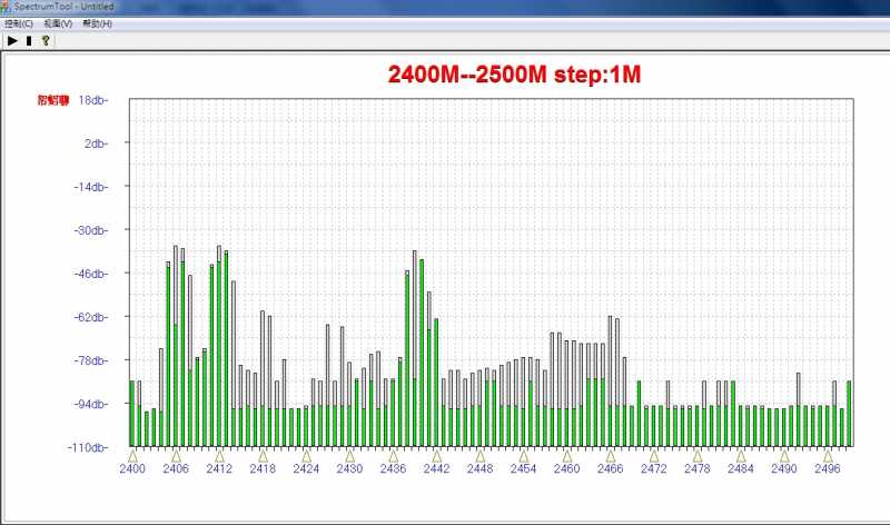

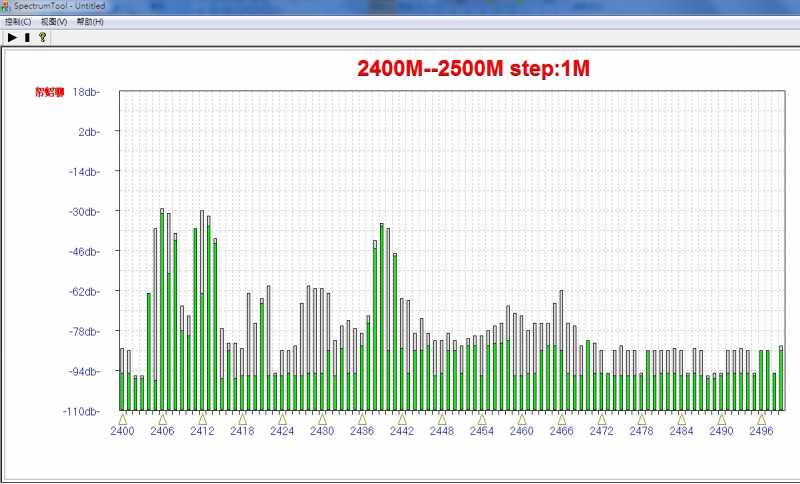

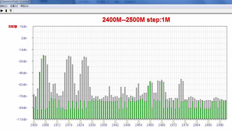

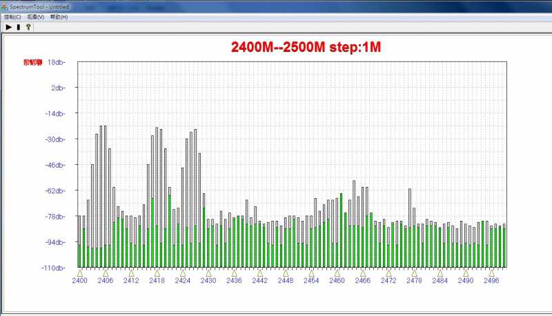

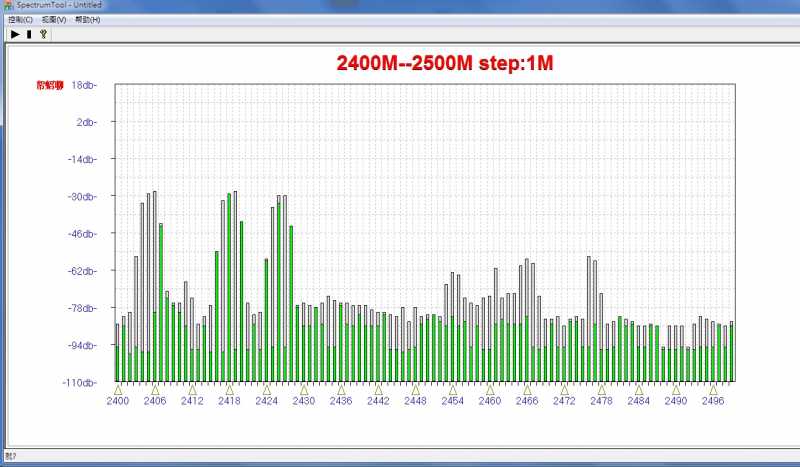

got a very primitive spectrum analyser today and started to perform some test on the Devo 7e's power measurement.
Before any mod on the 7e, I have compared its output with my Devo 10 setting to 100mW output and found that the 7e is about 10dB down..
After shorting the diode and perform some measurement again against the Devo 10, I've got the following screen captures for you all to analyse.. (I've taken 4 captures for each transmitter so that you can average out the data)

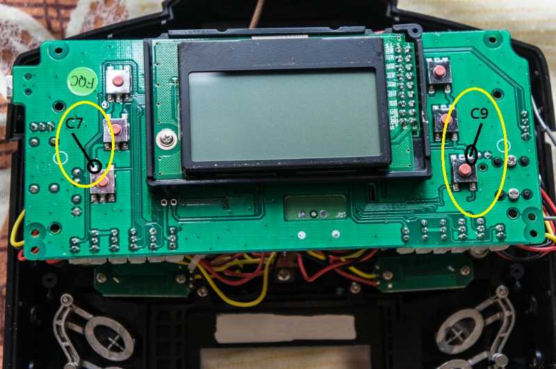

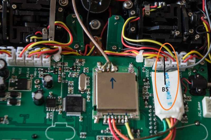

I noticed that in your DEVO-7E Hardware Connections document, there are two switch inputs (B5/C7 and B5/C9) are not being used. Any chance that we can added two more channels if we can do a bit of soldering?
11 Feb 2013 05:53 #6244 by cmpang
Replied by cmpang on topic Devo7e work
and the soldering shouldn't be difficult, no need to solder on the SMT.. :)
