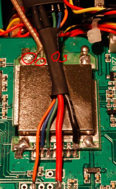

Bin thinking of putting this on the CYRF6936 module. Not mostly for more range but for ability to lower the mW power.
Before I do it does anybody know if I can leave the existing antenna on while testing?
And when soldering it in place, can I just split up the cable and solder to the tree points on the module?
I putt the shield back on :oops:

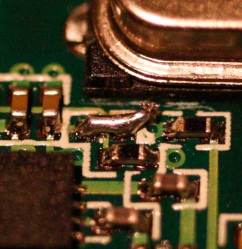

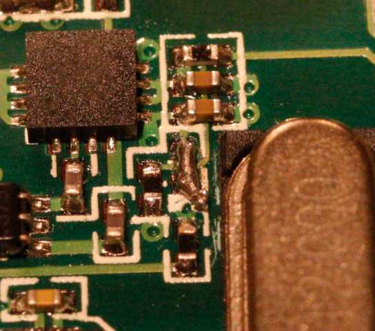

Replied by FDR on topic Devo7e work
If you do the diode mod, then the scale will be valid again, so you will have 0.1, 0.3, 1, 3, 10, 30, 100, 150mW options...

FDR wrote: If you do the diode mod, then the scale will be valid again, so you will have 0.1, 0.3, 1, 3, 10, 30, 100, 150mW options...
You mean like this:
But this will not impact on the A7105 will it? I haven't noticed any change in flysky A7105.
21 Feb 2013 12:03 #6679 by FDR
Mullson wrote: You mean like this:
Yep.
No, it doesn't effect the A7105 module...

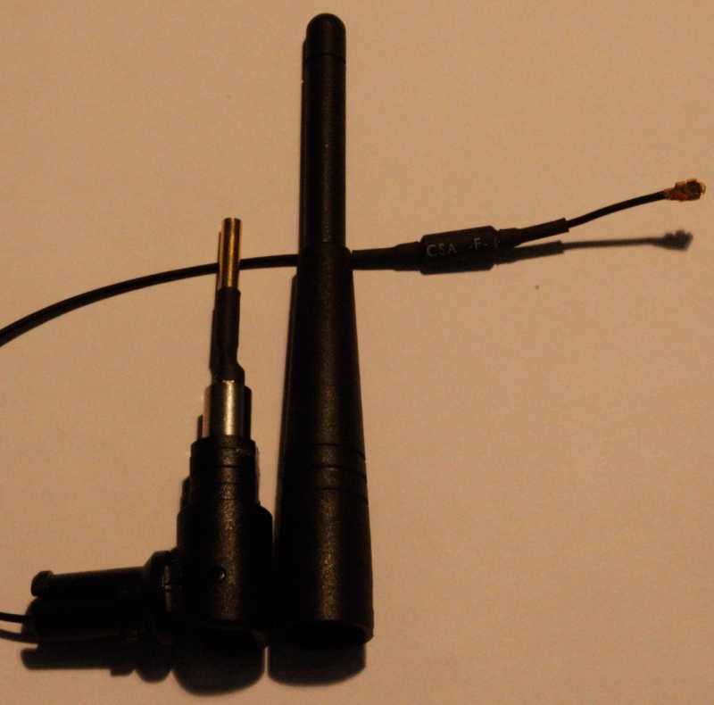

OK, so now we cleared that up, the range of Devo10 should be over 1000m with Tx and Rx under optical visibility.
But, Xermalk measured Devo7e to have range of about 150m. Where is the difference coming from. Antenna only? We should concentrate on antenna then. It should be nice to have such a small Tx with long range, as Devo6s which is at least 600m, if I remember right.

Usjak wrote: Xermalk measured Devo7e to have range of about 150m.
