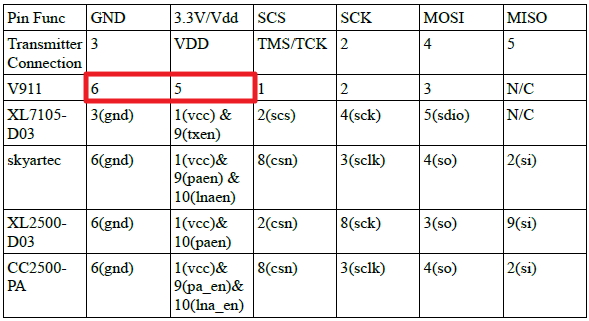

25 Mar 2013 07:58 #8061 by dc59
Replied by dc59 on topic Devo7e work
Hi PB,
I fonud a mistake at ModuleInstallation.pdf about V911 module pin connection.
V911 module GND & Vcc should be swapped, please confirm it again.
Thanks.

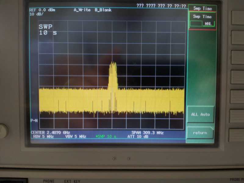

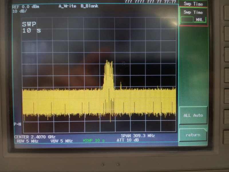

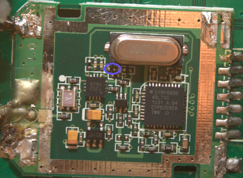

Replied by RandMental on topic Devo7e work
Devo 7e RF power modification
With reference to the Diode bridge mod inside the Devo7e RF module and various tests done, I have compared the Devo8s at 150mW and the modified devo7e in a controlled environment. The results below indicate that the 7e mod does take the standard Devo7e to a fixed 150mW output. (please ignore the absolute value of the graphs, I did not use a calibrated antennae on the Spectrum Analiser)
www.deviationtx.com/forum/7-development/...-work?start=240#6083
www.deviationtx.com/forum/7-development/...-work?start=220#6151
From the attached spectrum graphs you can see the levels are virtually the same, testing was over a 5 meter range, using the standard TX antennas.
PB's Diode modification
Devo8s with Devention Firmware set to 150mw
Devo7e with Devention Firmware
